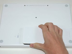

  • Battery: Replacing the battery requires a coin or a flat-edge tool release the battery latch. The battery can be replaced in less than 30 seconds.

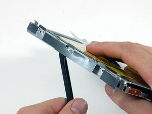

  • Optical Drive: The standard optical drive shipped with MacBooks is either a Combo Drive or a 4x or 6x SuperDrive. The optical drive can easily be upgraded to an 8x SuperDrive.

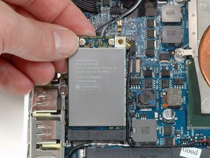

  • AirPort: The MacBook Core Duo shipped with an 802.11g AirPort card, but the stock card can be replaced with an 802.11n AirPort card.
