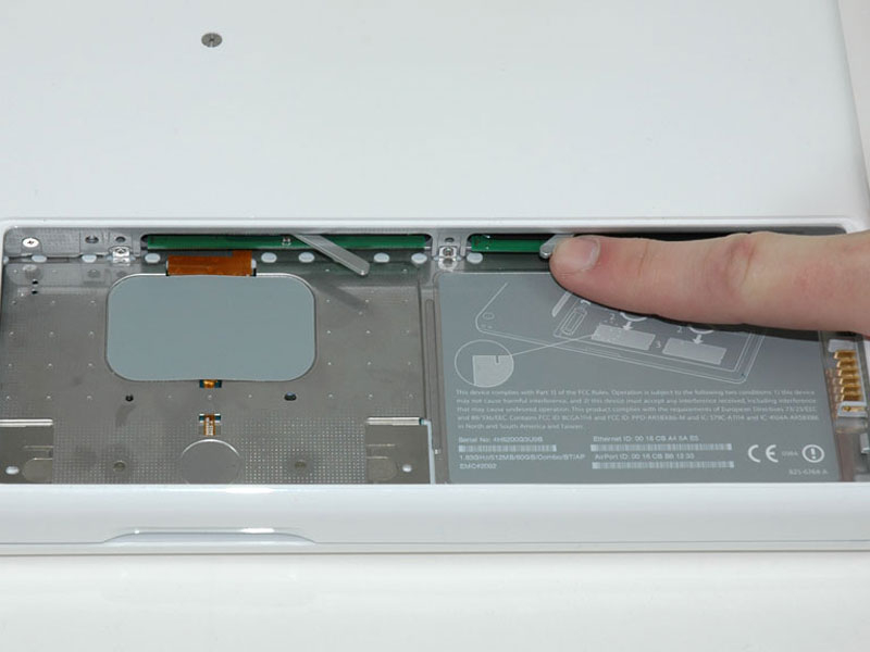

    1. MacBook Core Duo RAM Replacement, Memory Cover: step 3, image 1 of 1
      • Remove the three evenly-spaced Phillips screws from along the rear wall of the battery compartment.
      • The screws are captive to the metal memory cover.
      • When replacing the memory cover, use a spudger to re-insert the foam cushioning behind the rear wall for propper battery spacing.

    2. MacBook Core Duo RAM Replacement: step 4, image 1 of 1
      • Lift up on L-shaped memory cover, slide it to the right, and lift it out of the computer.
      Ask FixBot
    1. MacBook Core Duo RAM Replacement, RAM: step 5, image 1 of 1
      • In one swift but careful motion, flick the levers to the left and slide the RAM chip out from its compartment.
      • Unlike the iBook line, the MacBook has two RAM slots, which allows for up to 2 GBs of memory.

Please note. The ram modules have to be pushed all the way in until they click in place. You have to push them quite hard to do this. If the ram modules just slide in until they stop then they won’t make contact.
Patch - Reply Share
