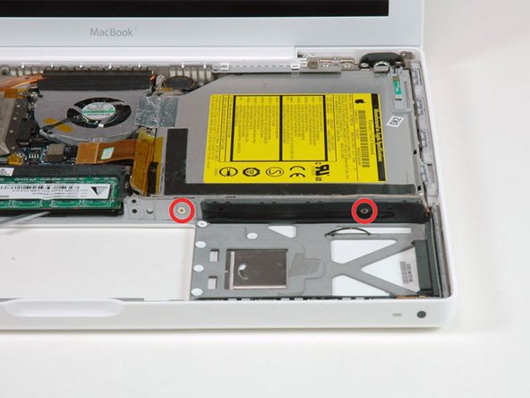

    2. MacBook Core Duo LCD Panel Replacement: step 14, image 1 of 1
      • Remove the two Phillips screws from the front edge of the optical drive.
      • The shorter screw (3 mm) is recessed nearest the RAM modules. The other is 3.5 mm.

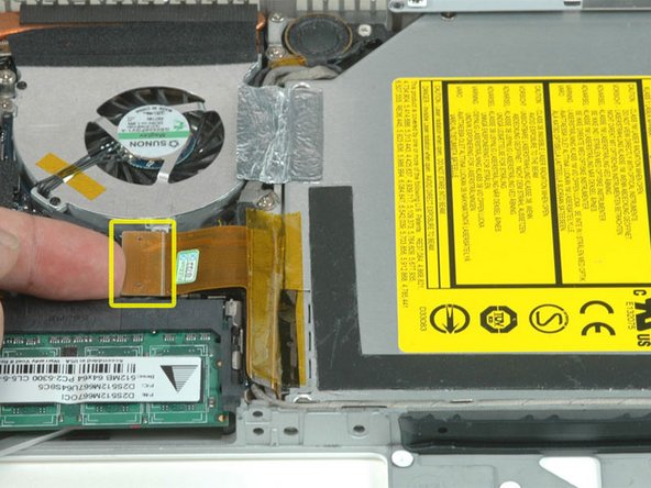

    3. MacBook Core Duo LCD Panel Replacement: step 15, image 1 of 1
      • Disconnect the orange optical drive ribbon cable from the logic board.
      Ask FixBot

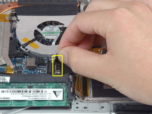

    4. MacBook Core Duo LCD Panel Replacement: step 16, image 1 of 1
      • Disconnect the newly-revealed display data cable. If there is no pull-tab on the top of the connector, it may be helpful to use a spudger to disconnect this connector.
      Ask FixBot

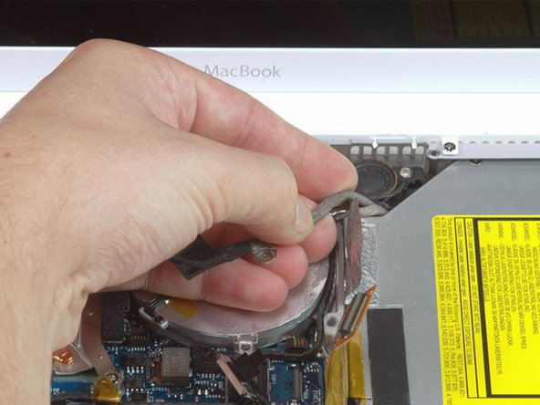

    5. MacBook Core Duo LCD Panel Replacement: step 17, image 1 of 1
      • Disconnect the (once again) newly-revealed hard drive cable.
      Ask FixBot
    6. MacBook Core Duo LCD Panel Replacement: step 18, image 1 of 1

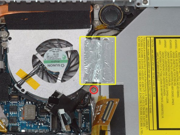

      • Peel up the foil tape between the fan and the optical drive.
      • Remove the 8.5 mm Phillips screw securing the display data cable to the metal framework.
      Ask FixBot

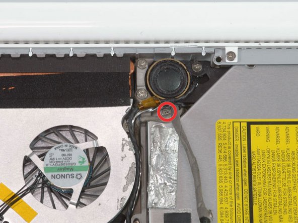

    8. MacBook Core Duo LCD Panel Replacement: step 20, image 1 of 1
      • Remove the 2.8 mm Phillips screw securing the optical drive.
      • The Bluetooth cable may be covering the screw; carefully push it aside before removing the screw.
      • Do not over-tighten this screw when re-mounting. You could break the plastic enclosure.
      • After removing the screw, push the metal tab backwards, towards the fan, to release the front of the optical drive.
      Ask FixBot

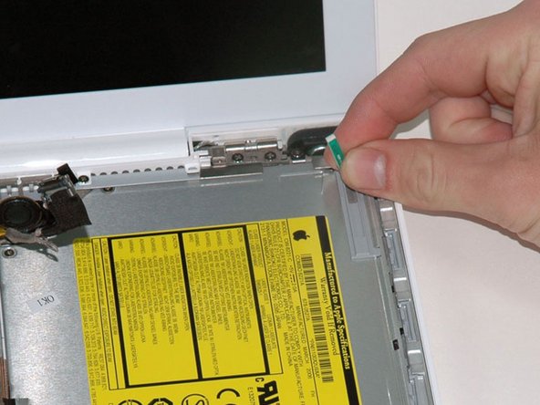

      • Lift the Bluetooth antenna board from the right side of the optical drive.
      Ask FixBot

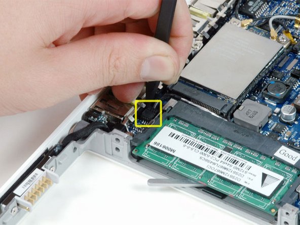

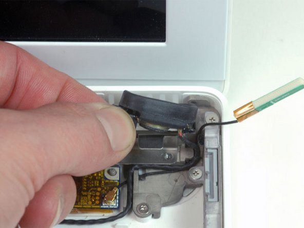

    1. MacBook Core Duo LCD Panel Replacement, Display: step 27, image 1 of 1
      • Use a spudger to carefully disconnect the microphone cable from the logic board. You'll want to work from side to side, and slowly wiggle the connector out of its socket.
      • Pulling on this connector vertically will break the socket off the logic board. This connector should be removed horizontally by gently pulling the microphone cable toward the screen while working a spudger between the connector and the socket.
      Ask FixBot

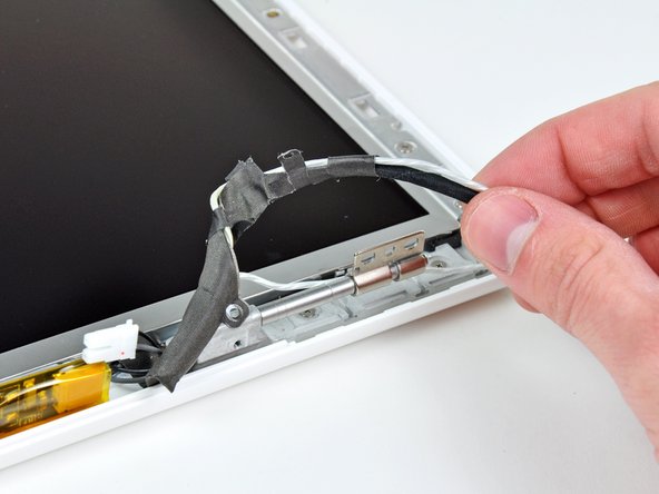

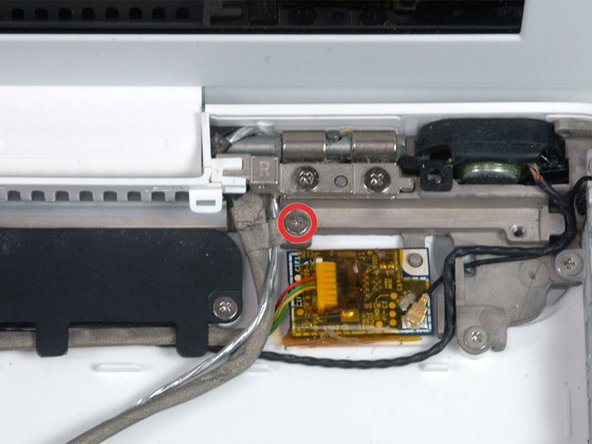

      • Remove the single 3.2 mm Phillips screw securing the ground loop in the display data cable located just above the Bluetooth board.
      Ask FixBot

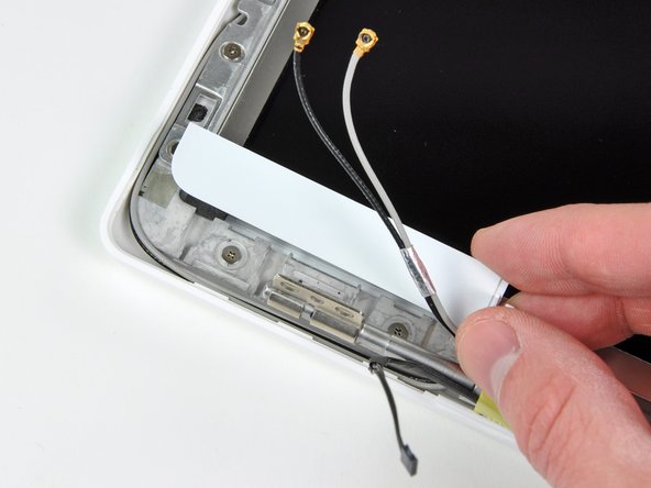

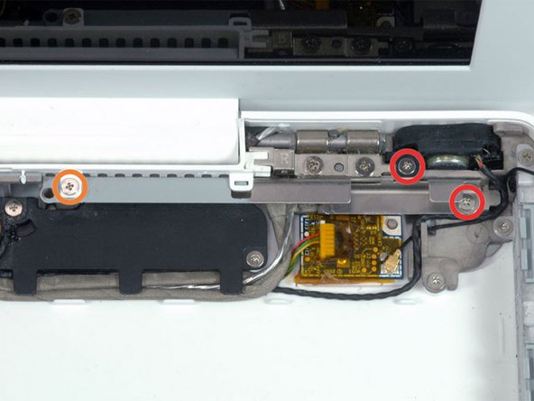

      • Disconnect the two antenna cables from the Airport card, and the black inverter cable from the logic board. (Pull vertically on all three.)
      Ask FixBot

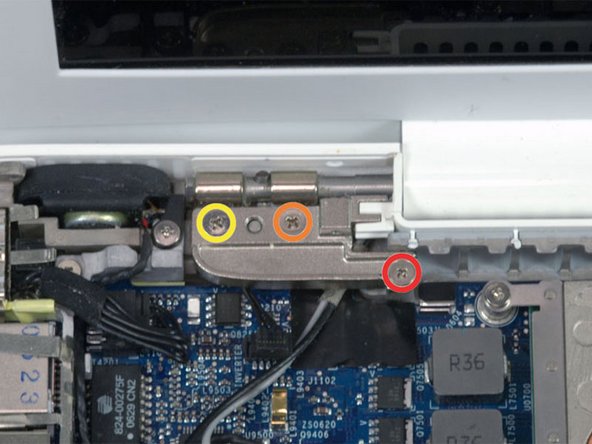

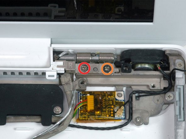

    6. MacBook Core Duo LCD Panel Replacement: step 32, image 1 of 1
      • Remove the following 2 screws from the right hinge mount:
      • One 6 mm Phillips on the left side of the hinge mount.
      • One 10 mm Phillips on the right side of the hinge mount.
      • Lift the right hinge mount out of the computer.
      Ask FixBot

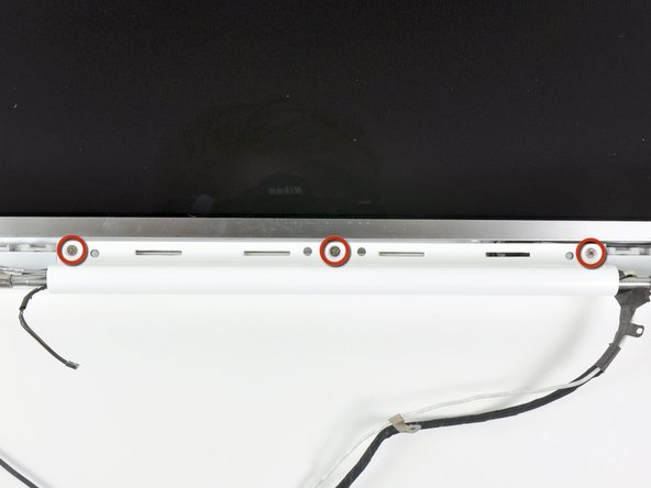

    7. MacBook Core Duo LCD Panel Replacement: step 33, image 1 of 1
      • Hold the display with one hand while removing the screws from the left hinge mount.
      • Remove the following 3 screws from the left hinge mount:
      • One 6 mm smaller diameter Phillips from the right side.
      • One 6 mm larger diameter Phillips from the middle.
      • One 10 mm Phillips from the left side.
      • Lift the left hinge mount out of the computer.
      Ask FixBot

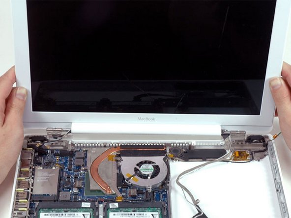

    8. MacBook Core Duo LCD Panel Replacement: step 34, image 1 of 1
      • Grasp the display assembly on either side, and lift it up and out of the computer.
      Ask FixBot

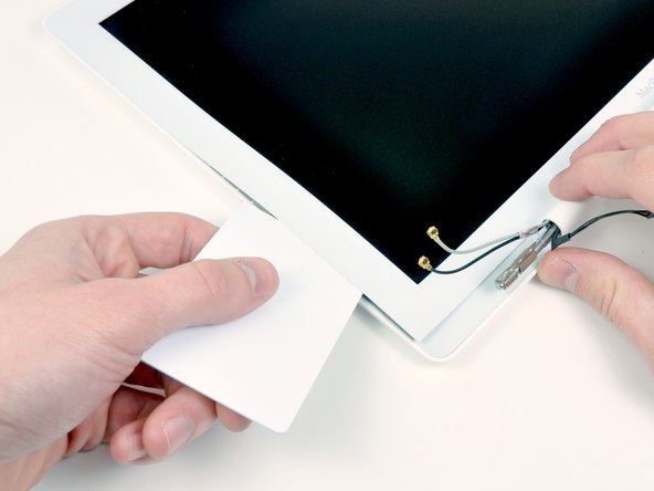

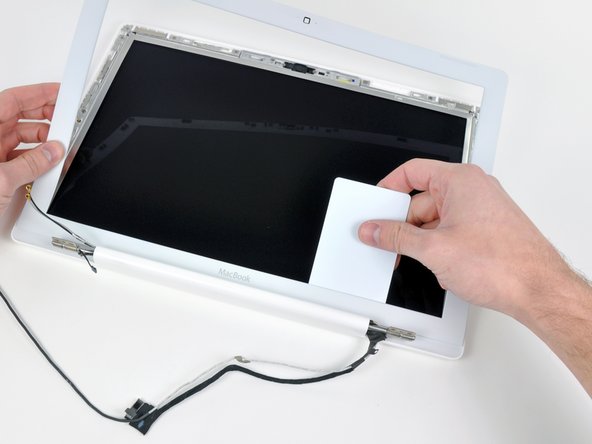

    1. MacBook Core Duo LCD Panel Replacement, Front Display Bezel: step 35, image 1 of 1
      Tool used on this step:
      Plastic Cards
      $2.99
      Buy

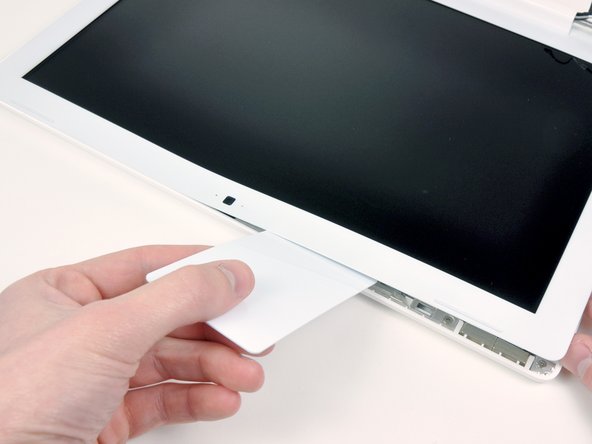

      • The following steps should be identical for both white and black MacBooks.
      • Use a thin plastic card to release the tabs and their clips holding the front display bezel to the display assembly. There are five tabs along the left side of the display bezel.
      • You may find some display bezels are easier to remove if you work from their inside edges, directly adjacent to/above the LCD panel.
      • Don't use a card that cannot be replaced if damaged. The clips can be difficult to remove and the card can bend and break, rendering it useless.
      Ask FixBot

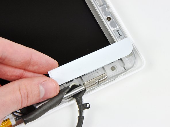

    3. MacBook Core Duo LCD Panel Replacement: step 37, image 1 of 1
      • Next, free the five tabs securing the display bezel on the right side.
      Ask FixBot

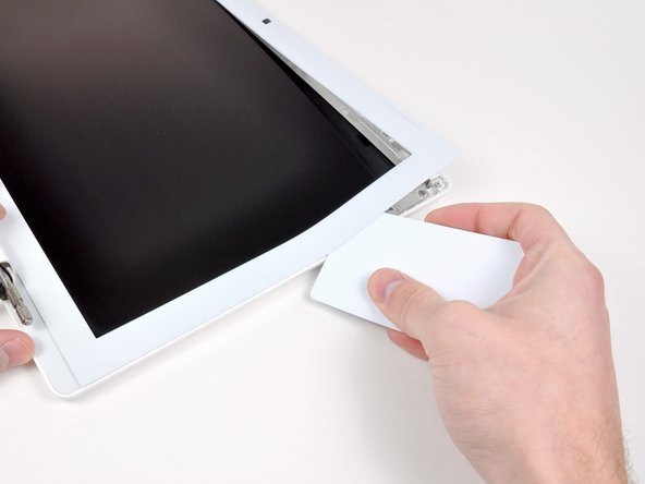

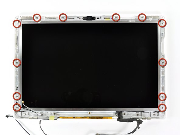

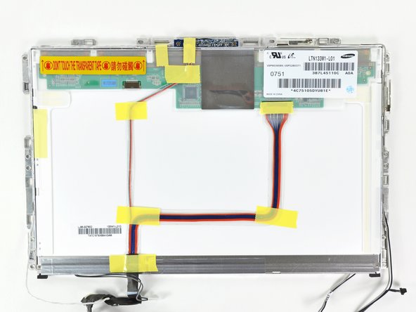

    4. MacBook Core Duo LCD Panel Replacement: step 38, image 1 of 2 MacBook Core Duo LCD Panel Replacement: step 38, image 2 of 2
      • Lift up the front display bezel from the top and use your plastic card to free the tabs along the bottom edge of the display bezel.
      • Make sure that your card is between the metal frame around the LCD panel and the display bezel and not touching the LCD panel itself.
      • After freeing all holding tabs, lift the front display bezel away from the display assembly.
      • When reinstalling the front display bezel onto the display housing, you may find it easier to get the tabs and clips to connect if you push on the four sides of the bezel in this order: top, bottom, then the sides (left or right). You may have to apply extra pressure along the bottom side of the bezel to get it to snap into place firmly.
      Ask FixBot

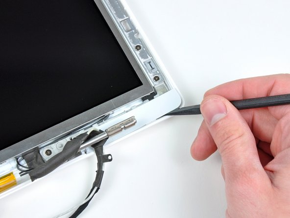

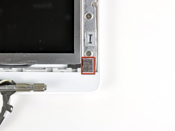

    5. MacBook Core Duo LCD Panel Replacement: step 39, image 1 of 2 MacBook Core Duo LCD Panel Replacement: step 39, image 2 of 2

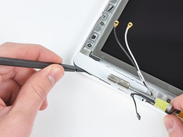

      • Sometimes when removing the front display bezel, the retaining clips that should remain captive in the LCD brackets come out with the front display bezel. Follow this and the next step to transfer the clips back to the LCD bracket.
      • Use a metal spudger or another thin tool to carefully pry the gray plastic clips off the tabs molded into the front display bezel. A 0.8mm flat screwdriver may be useful for this step. You may find that it's easier to remove some of these clips by prying up on their long sides.
      • Be careful, as the clips are made of thin plastic and are inherently delicate.
      Ask FixBot

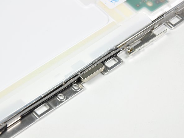

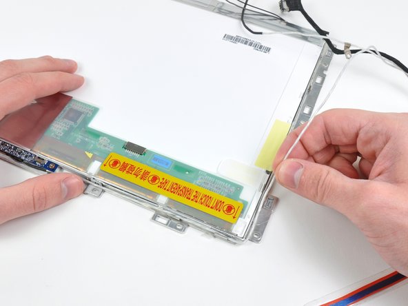

    6. MacBook Core Duo LCD Panel Replacement: step 40, image 1 of 2 MacBook Core Duo LCD Panel Replacement: step 40, image 2 of 2
      • Insert one end of the retaining clip beneath the edge of its recess cut into the LCD bracket.
      • Use the edge of a spudger to push the short hook tab on the underside of the other end of the retaining clip into the recess cut into the LCD bracket.

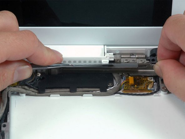

    1. MacBook Core Duo LCD Panel Replacement, Clutch Cover: step 41, image 1 of 1
      • Remove the three 4.2 mm Phillips screws securing the clutch cover.
      Ask FixBot
    2. MacBook Core Duo LCD Panel Replacement: step 42, image 1 of 1
      • While holding the display down with one hand, use your other hand to lift the left end of the clutch cover off the clutch hinge and guide the inverter cable and AirPort cables through the gap in the clutch cover. If the cables snag on the two hooked tabs on the inside end of the clutch cover, free them carefully.
      • It may help to wiggle the clutch cover as you pull it up from the display.
      • During reassembly, make sure not to pinch the black inverter cable or the Airport wires when snapping the left end of the clutch cover back into place. To avoid pinching, it may help to lift up and hold these cables and wires in place at the top of the hinge, rather than leaving them running along the sides of the hinge.
      Ask FixBot
    3. MacBook Core Duo LCD Panel Replacement: step 43, image 1 of 2 MacBook Core Duo LCD Panel Replacement: step 43, image 2 of 2
      • Lift up the right end of the clutch cover while guiding the display data and iSight cables through the gap and the two hooked tabs at the right end of the clutch cover. If the cables snag on the two hooked tabs, free them carefully.
      • Lift the clutch cover off of the display assembly.
      • During reassembly, avoid pinching the display data and iSight cables. While guiding the right end of the clutch cover into place, but before snapping it down, guide these cables between the two hooked tabs inside the right end of the clutch cover, and up into the curved area of the clutch cover, above the hinge.
      • Also avoid pinching the backlight wires (with the white connector on the end, plugged into the right end of the inverter). They should run under the upper right edge of the clutch cover. In some models, the two wires are gray and black, and in others they're white and pink. They lead into a hole in the lower right edge of the LCD to the backlight.

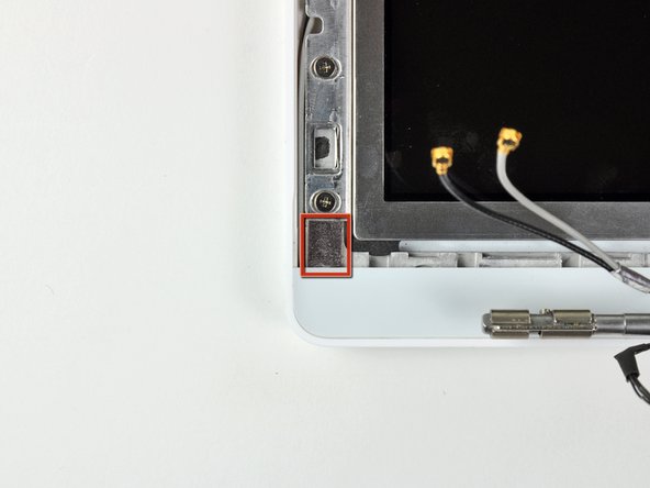

    1. MacBook Core Duo LCD Panel Replacement, LCD Assembly: step 44, image 1 of 2 MacBook Core Duo LCD Panel Replacement, LCD Assembly: step 44, image 2 of 2
      • Remove the small piece of foam tape stuck down above each of the bezel covers, at the lower left and right corners.

    2. MacBook Core Duo LCD Panel Replacement: step 45, image 1 of 2 MacBook Core Duo LCD Panel Replacement: step 45, image 2 of 2
      • Use a spudger to slide the left bezel cover towards the LCD panel.
      • Do not lift up vertically on the cover! Unlike the large display bezel, this one has horizontal hooks to keep it in place. These will break easily.
      • Lift the left bezel cover off the display assembly.

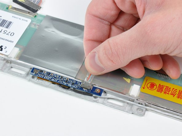

    4. MacBook Core Duo LCD Panel Replacement: step 47, image 1 of 2 MacBook Core Duo LCD Panel Replacement: step 47, image 2 of 2

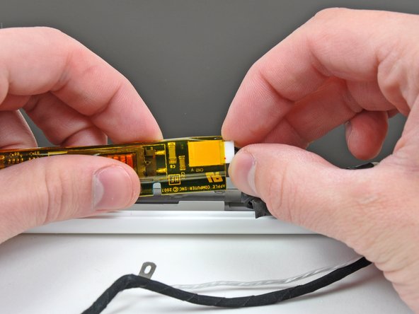

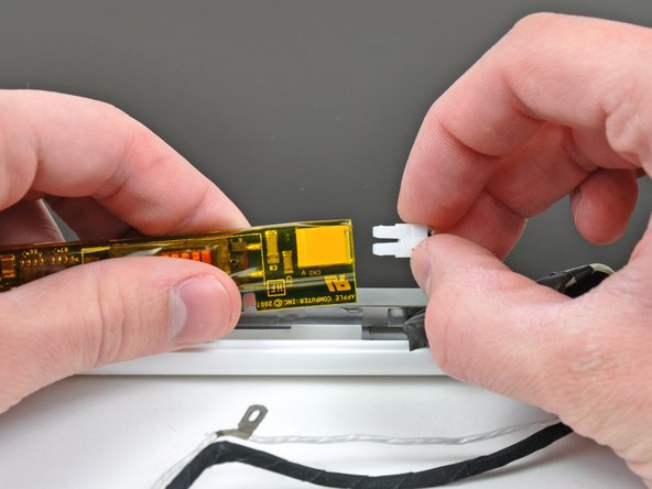

      • Lift the inverter out of the display slightly and disconnect the backlight cable from its right side.
      • Place the inverter back down in its recess.
      Ask FixBot

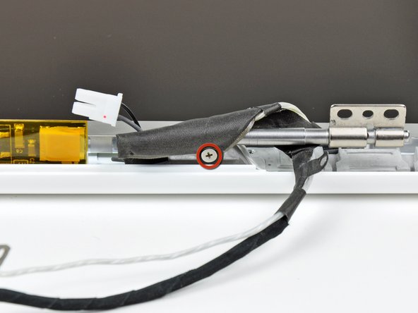

    5. MacBook Core Duo LCD Panel Replacement: step 48, image 1 of 1
      • Remove the single 3.2 mm Phillips screw securing the display data cable to the right clutch hinge.
      Ask FixBot
    6. MacBook Core Duo LCD Panel Replacement: step 49, image 1 of 1
      • Move the display data cable out from under the mounting arm of the right clutch hinge.
      Ask FixBot

      • Remove the twelve 4.2 mm Phillips screws securing the LCD assembly to the rear display bezel.
      • Make sure you pay attention to how the microphone cable (and antenna cable on some models) are routed around the outside of the two screws at the bottom left and right corners of the screen. It's easy to damage the cables if not routed properly when reinstalling these screws. To see the cable routing more clearly, click on the photo and zoom in.
      Ask FixBot
    8. MacBook Core Duo LCD Panel Replacement: step 51, image 1 of 1
      • Raise the bottom edge of the LCD assembly slightly, then slide it down slightly to free its upper edge from a slight overhang in the rear display bezel.
      • Lift it out of the rear display bezel, minding any cables that may get caught.
      • When reinstalling the LCD assembly back into the rear display bezel, before you tighten down any of its frame mounting screws, make sure the short brass posts, one each on the left and right sides of the bezel, fit into their corresponding holes in the LCD assembly frame.
      Ask FixBot
    9. MacBook Core Duo LCD Panel Replacement: step 52, image 1 of 2 MacBook Core Duo LCD Panel Replacement: step 52, image 2 of 2
      • Be sure to keep track of the small magnet along the left side of the display. It may be stuck to the LCD frames or to the rear display bezel.
      • When the display lid is closed, this magnet comes in proximity to a sensor on a small circuit board at the bottom end of the I/O board, to tell the Macbook that the display has been closed, so that the Macbook can go into clamshell sleep mode.
      • To reinstall this magnet, press it back into its cavity in the rear display bezel, with its short side facing up (see photo 2), then place the LCD panel back into the rear display bezel and screw it down so that the magnet doesn't drop out and disappear.
      Ask FixBot
    1. MacBook Core Duo LCD Panel Replacement, LCD Panel: step 53, image 1 of 1
      • Turn the LCD panel assembly over so that the screen is face down. You may want to use a cloth on your worksurface to prevent scratching the screen.
      • Peel up all the yellow tape securing the display data and iSight cables to the back of the LCD panel.
      • You'll need to transfer the tape over to your new display when reassembling the computer.
      Ask FixBot

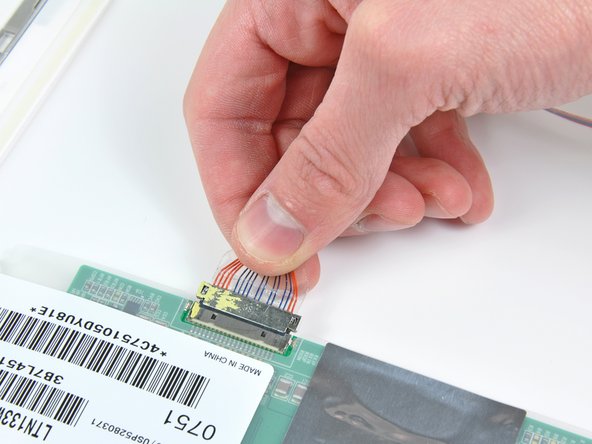

    2. MacBook Core Duo LCD Panel Replacement: step 54, image 1 of 1
      • Disconnect the display data cable from the back of the display.
      Ask FixBot

    4. MacBook Core Duo LCD Panel Replacement: step 56, image 1 of 1
      • Lift up the display data and iSight cables and move them to the side. It is not necessary to entirely remove these cables from the display assembly.
      • De-route the microphone cable from the right side of the LCD assembly.
      • On Core 2 Duo models, also de-route the antenna cable from the left side of the LCD assembly.

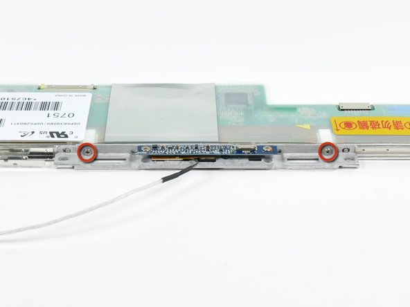

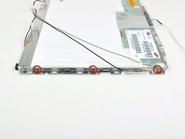

      • Remove the three 3.1 mm Phillips screws along the left edge of the display.
      Ask FixBot
    6. MacBook Core Duo LCD Panel Replacement: step 58, image 1 of 1
      • Remove the two 3.1 mm Phillips screws securing the iSight holder to the top of the display.
      • Make sure to remove the screws securing the metal bracket to the edge of the display and not the screws in the iSight board itself.
      • If you are replacing your screen with a new one, your part may not have these two screw holes. That's OK. You can still reassemble your computer without those screws in place.
      Ask FixBot

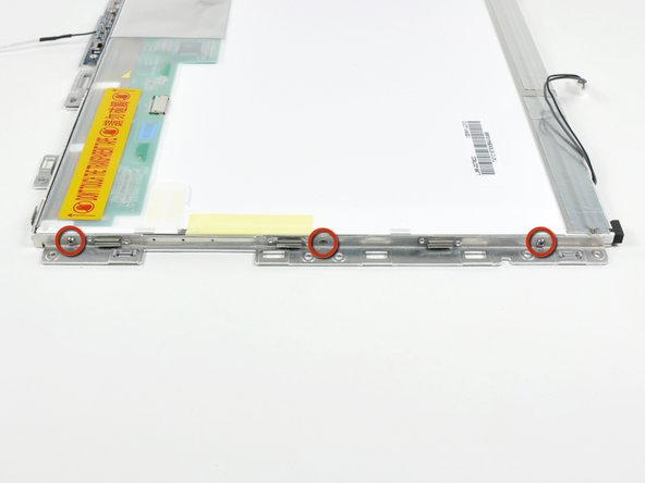

    7. MacBook Core Duo LCD Panel Replacement: step 59, image 1 of 1
      • Remove the three 3.1 mm Phillips screws along the right edge of the display.
      Ask FixBot

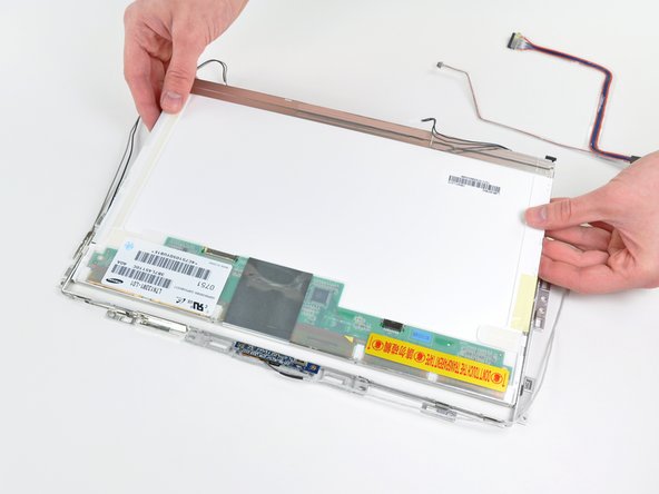

      • Lift up the LCD panel by its bottom edge and slide it out of the metal mounting brackets.
