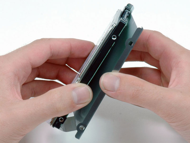

    1. MacBook Core Duo Hard Drive Replacement, Hard Drive: step 6, image 1 of 1
      • Remove the two black T8 Torx screws securing the silver bracket to the hard drive.
      Ask FixBot
    2. MacBook Core Duo Hard Drive Replacement: step 7, image 1 of 1
      • Rotate the hard drive and remove the two black T8 Torx screws on the other side of the drive.
      Ask FixBot
    3. MacBook Core Duo Hard Drive Replacement: step 8, image 1 of 1
      • Lift the silver metal hard drive bracket off of the hard drive.
      • You'll need to transfer this metal bracket to your new hard drive.
      • If you are installing a new hard drive, we have an OS X install guide to get you up and running.
