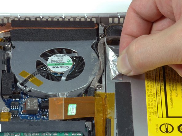

    1. MacBook Core Duo PRAM Battery Replacement, Logic Board: step 17, image 1 of 1
      • Peel up the foil tape between the fan and the optical drive.
      Ask FixBot

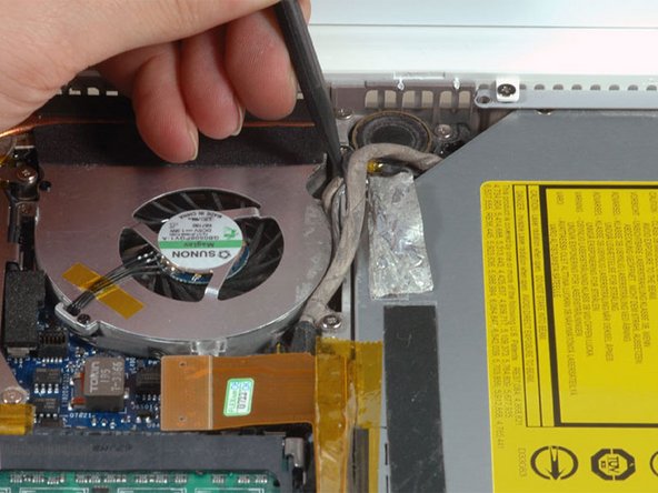

    2. MacBook Core Duo PRAM Battery Replacement: step 18, image 1 of 1
      • Use a spudger to move the gray display data and black speaker cables to the right. This will reveal a silver screw securing the fan housing to the lower case.

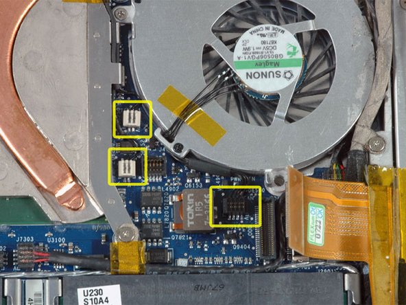

    5. MacBook Core Duo PRAM Battery Replacement: step 21, image 1 of 1

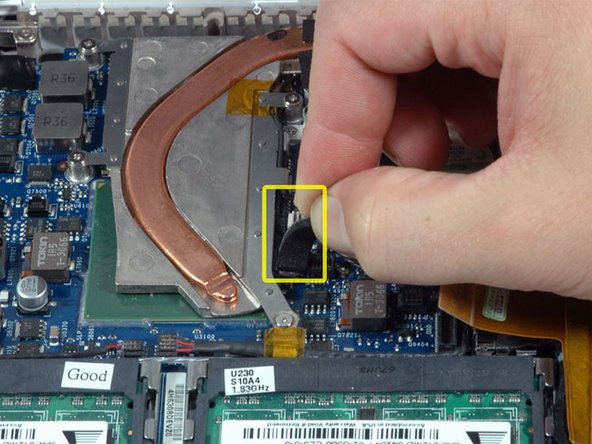

      • Disconnect the black fan connector and two white temperature sensor connectors from the logic board.
      Ask FixBot

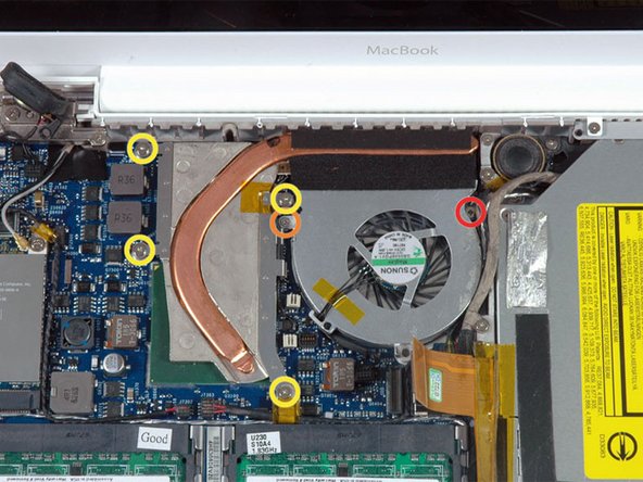

      • Remove the following 6 screws:
      • One 3 mm Phillips on the right side of the fan.
      • One 6 mm Phillips on the left side of the fan.
      • Four 9 mm Phillips securing the heat sink to the lower case.

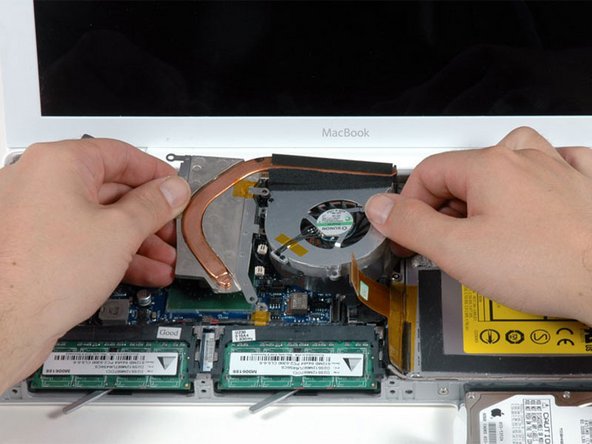

    7. MacBook Core Duo PRAM Battery Replacement: step 23, image 1 of 1
      • Hold the heat sink with one hand and the fan with your other hand, and lift the heat sink and fan assembly out of the computer. The fan is attached to the heat sink only with a strip of black felt tape, so be sure to remove both parts as a unit
      • If you need to mount the heat sink back into the laptop, we have a thermal paste guide that makes replacing the thermal compound easy.

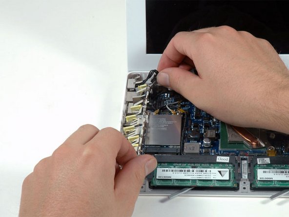

    8. MacBook Core Duo PRAM Battery Replacement: step 24, image 1 of 1
      • Disconnect the two antenna cables from the Airport card, and the black inverter cable from the logic board.
      Ask FixBot

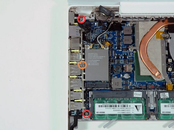

    9. MacBook Core Duo PRAM Battery Replacement: step 25, image 1 of 1

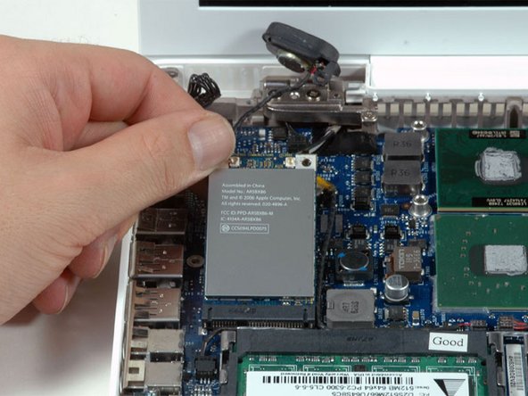

      • Remove the following 2 screws from the Airport card:
      • One 3 mm Phillips from the left side.
      • One 8 mm Phillips from the right side.
      Ask FixBot
    10. MacBook Core Duo PRAM Battery Replacement: step 26, image 1 of 1
      • Grasp the Airport card at its top and slide it toward the screen and out of the computer.

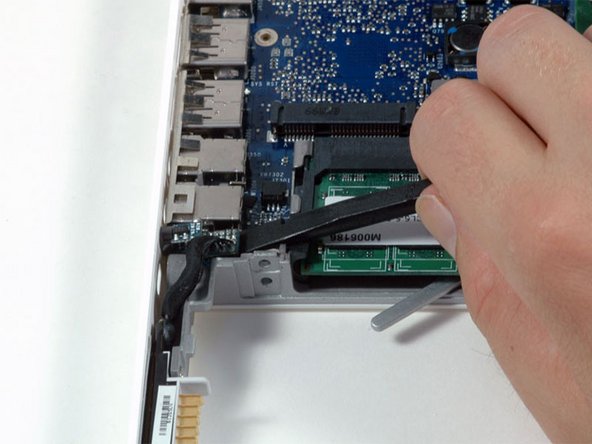

      • Use a spudger to disconnect the left speaker connector from the logic board.
      • Lift the left speaker out of the computer.

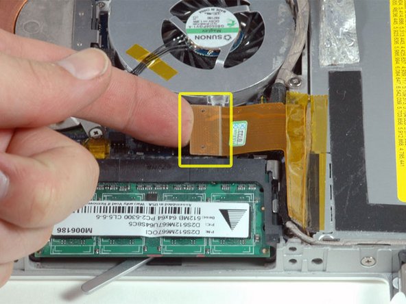

    12. MacBook Core Duo PRAM Battery Replacement: step 28, image 1 of 1
      • Disconnect the display data cable by pulling up on the black plastic pull-tab. If there is no pull-tab on the top of the connector, it may be helpful to use a spudger to disconnect this connector.

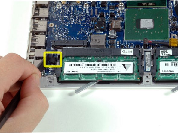

    14. MacBook Core Duo PRAM Battery Replacement: step 30, image 1 of 1
      • Use a spudger to disconnect the two speaker connectors from the logic board.

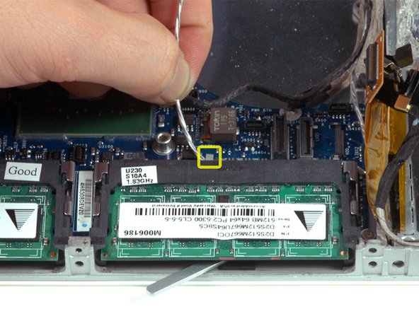

    16. MacBook Core Duo PRAM Battery Replacement: step 32, image 1 of 1
      • Deroute the silver microphone cable from the silver metal clip just above the right RAM slot.
      Ask FixBot

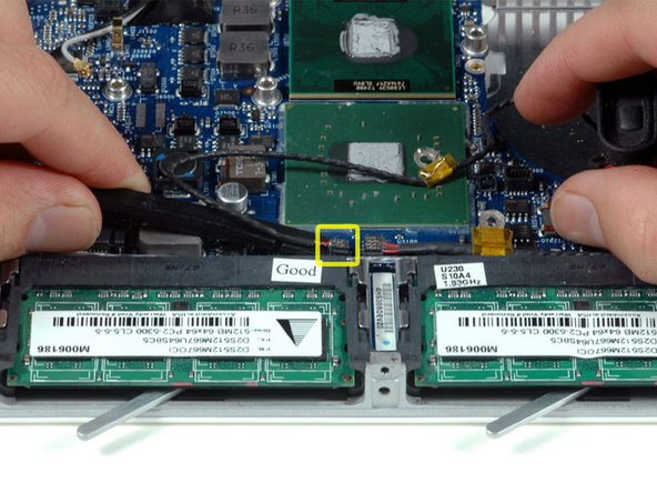

      • Use a spudger to carefully pry the battery connector up and disconnect it from the logic board.
      Ask FixBot

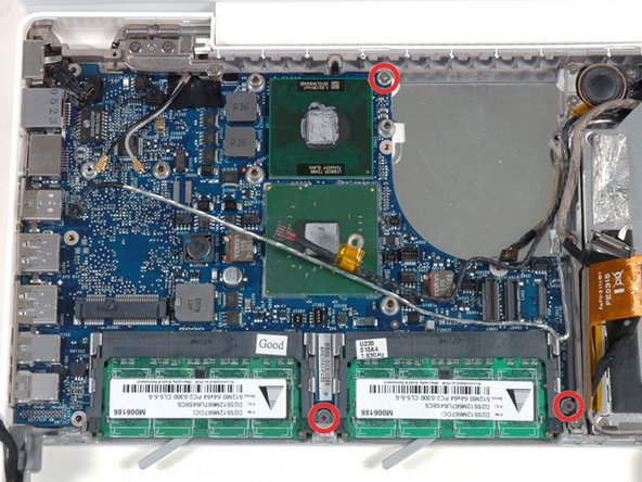

      • Remove the three 3 mm Phillips screws securing the logic board to the lower case.

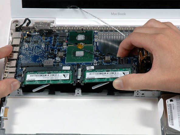

    19. MacBook Core Duo PRAM Battery Replacement: step 35, image 1 of 1
      • Lift the logic board up from the right side, and slide it up and out of the computer.
