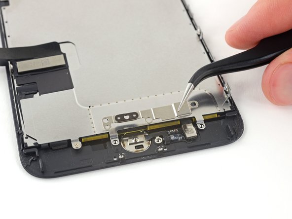

    1. iPhone 7 Plus Screen Replacement, Home/Touch ID Sensor: step 23, image 1 of 1
      • Remove the four Y000 screws securing the bracket over the home/Touch ID sensor:
      • One 1.1 mm screw
      • Three 1.3 mm screws
      • During reassembly, be careful not to overtighten these screws, or your home button may not work.
      Ask FixBot
    2. iPhone 7 Plus Screen Replacement: step 24, image 1 of 1
      • Remove the bracket that secures the home/Touch ID sensor.
      Ask FixBot

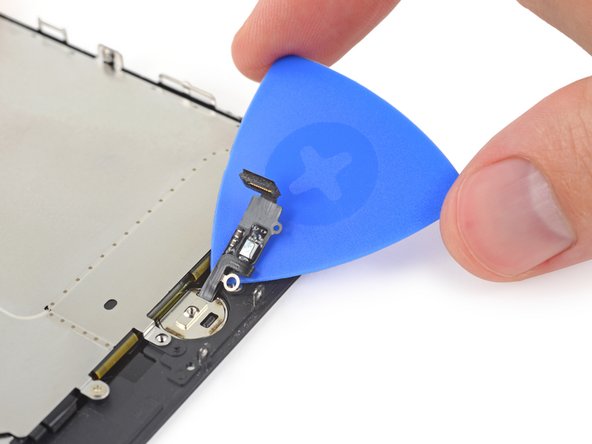

    4. iPhone 7 Plus Screen Replacement: step 26, image 1 of 2 iPhone 7 Plus Screen Replacement: step 26, image 2 of 2
      • Carefully pry up the underlying connector and move it out of the way of the home/Touch ID cable.
      • It's very easy to damage your iPhone during this step. Work slowly and take care where you pry with your tool. If you damage the Touch ID hardware, it can only be replaced by Apple.
      • If the connector doesn't pry up easily, use a hair dryer or iOpener to heat and soften the adhesive securing the connector, and then try again.
      • Don't try to detach the connector completely—simply flip it up slightly so that the underlying home/Touch ID sensor cable can be removed.
      Ask FixBot

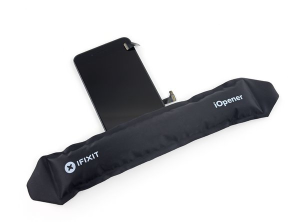

    5. iPhone 7 Plus Screen Replacement: step 27, image 1 of 1
      • Heating the area around the home/Touch ID sensor will help soften the adhesive holding its delicate cable in place, making it easier to remove safely.
      • Flip the display assembly over. Use a hairdryer or prepare an iOpener and apply it to the lower edge of the display for about 90 seconds in order to soften up the adhesive underneath.
      Ask FixBot

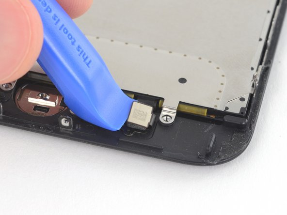

    6. iPhone 7 Plus Screen Replacement: step 28, image 1 of 3 iPhone 7 Plus Screen Replacement: step 28, image 2 of 3 iPhone 7 Plus Screen Replacement: step 28, image 3 of 3
      • Use an opening pick to gently separate the adhesive holding the home/Touch ID sensor cable to the back side of the display panel.
      Ask FixBot
    7. iPhone 7 Plus Screen Replacement: step 29, image 1 of 1
      • Remove the home/Touch ID sensor assembly by lifting it through the front side of the display.
      • To reinstall, first feed the cable through the hole in the front of the display.
      • Your replacement part may come with an extra Y000 screw already installed right of the Home Button. Remove the unnecessary screw so that you can reinstall the home button bracket.
      • Follow this guide to install replacement display adhesive on your screen.
