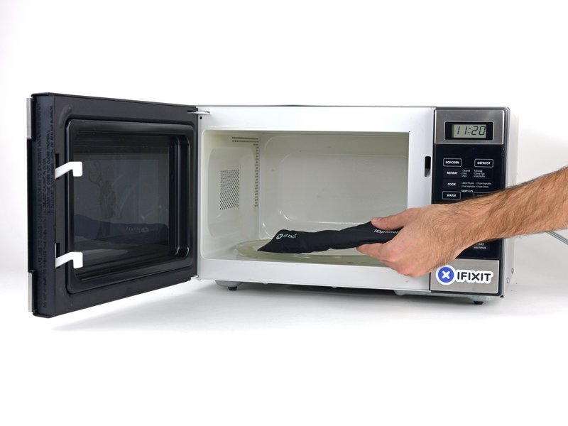

      • We recommend that you clean your microwave before proceeding, as any nasty gunk on the bottom may end up stuck to the iOpener.
      • Place the iOpener in the center of the microwave.
      • For carousel microwaves: Make sure the plate spins freely. If your iOpener gets stuck, it may overheat and burn.
      Ask FixBot
    2. iOpener Heating: step 2, image 1 of 1
      • Heat the iOpener for thirty seconds.
      • Depending on the wattage of your microwave, more or less time may be required. The iOpener is sufficiently heated when it's barely too hot to touch.
      • Throughout the repair procedure, as the iOpener cools, reheat it in the microwave for an additional thirty seconds at a time.
      • Be careful not to overheat the iOpener during the repair. Overheating may cause the iOpener to burst. Do not attempt to heat over 100˚C (212˚F).
      • Never touch the iOpener if it appears swollen.
      • If the iOpener is still too hot in the middle to touch, continue using it while waiting for it to cool down some more before reheating. A properly heated iOpener should stay warm for up to 10 minutes.
