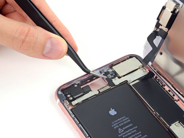

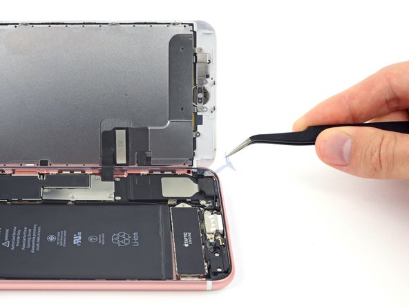

      • Begin by removing all the old display adhesive around the perimeter of your iPhone's case.
      • You can pull the adhesive off with tweezers, or roll it up on the tip of a spudger with a roll-and-pull motion.

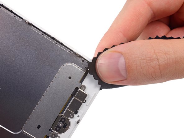

    3. iPhone Display Adhesive Replacement: step 3, image 1 of 1
      • If you're reinstalling your existing display rather than replacing it with a new one, be sure to remove any remaining adhesive from the back of your display as well.
      Ask FixBot

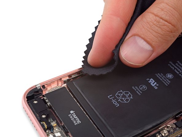

    4. iPhone Display Adhesive Replacement: step 4, image 1 of 2 iPhone Display Adhesive Replacement: step 4, image 2 of 2
      • Using a lint-free cloth (or coffee filter) with a bit of isopropyl alcohol, clean the areas of the case and rear display where you removed the old adhesive.
      • For best results, swipe your cleaning cloth in one direction, not back and forth.
      • This will help remove any remaining adhesive residue and prep the surface for the new adhesive.

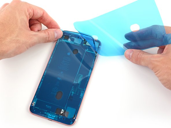

    5. iPhone Display Adhesive Replacement: step 5, image 1 of 2 iPhone Display Adhesive Replacement: step 5, image 2 of 2

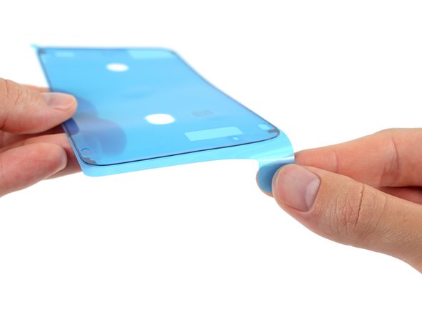

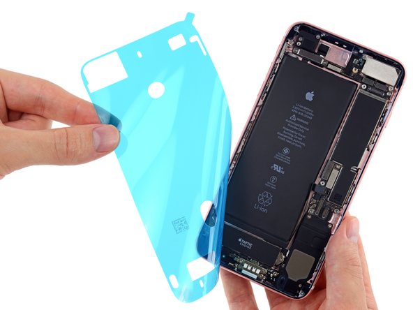

      • Begin peeling the large backing from your replacement adhesive, starting from the bottom edge.
      • You'll usually find a large tab of some kind on the bottom edge.
      Ask FixBot

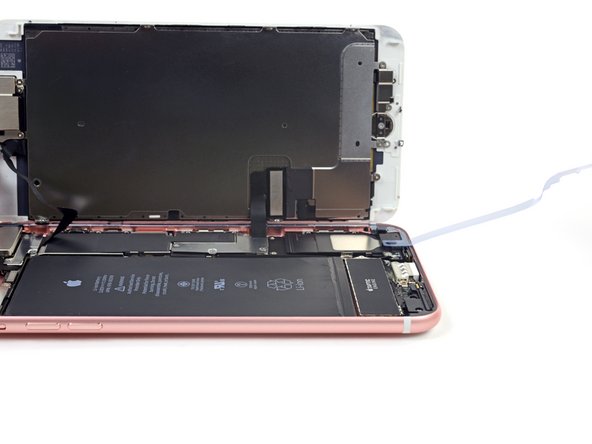

    6. iPhone Display Adhesive Replacement: step 6, image 1 of 3 iPhone Display Adhesive Replacement: step 6, image 2 of 3 iPhone Display Adhesive Replacement: step 6, image 3 of 3

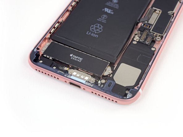

      • Before applying the adhesive, make sure your iPhone's battery connector lays flat so it doesn't press against the blue release liner. It's okay to temporarily reconnect the battery if needed—just be sure to disconnect it again before installing the display.

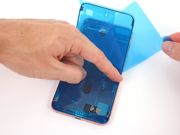

      • Carefully align the exposed lower edge of the adhesive strip with the bottom edge of your iPhone's case.
      • Once the adhesive is pressed into place, you can't reposition it—you'll have to remove it and start over with new adhesive.
      • When it's correctly aligned, gently press the exposed lower adhesive strip into place.
      Ask FixBot

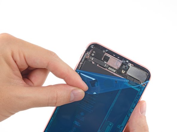

      • Continue peeling away the backing from the adhesive, gently pressing the adhesive into place from the bottom of your iPhone to the top.
      • If you correctly aligned the lower edge of the adhesive, the side and top edges will fall perfectly into place. If the adhesive is misaligned, remove it and start over with fresh adhesive.

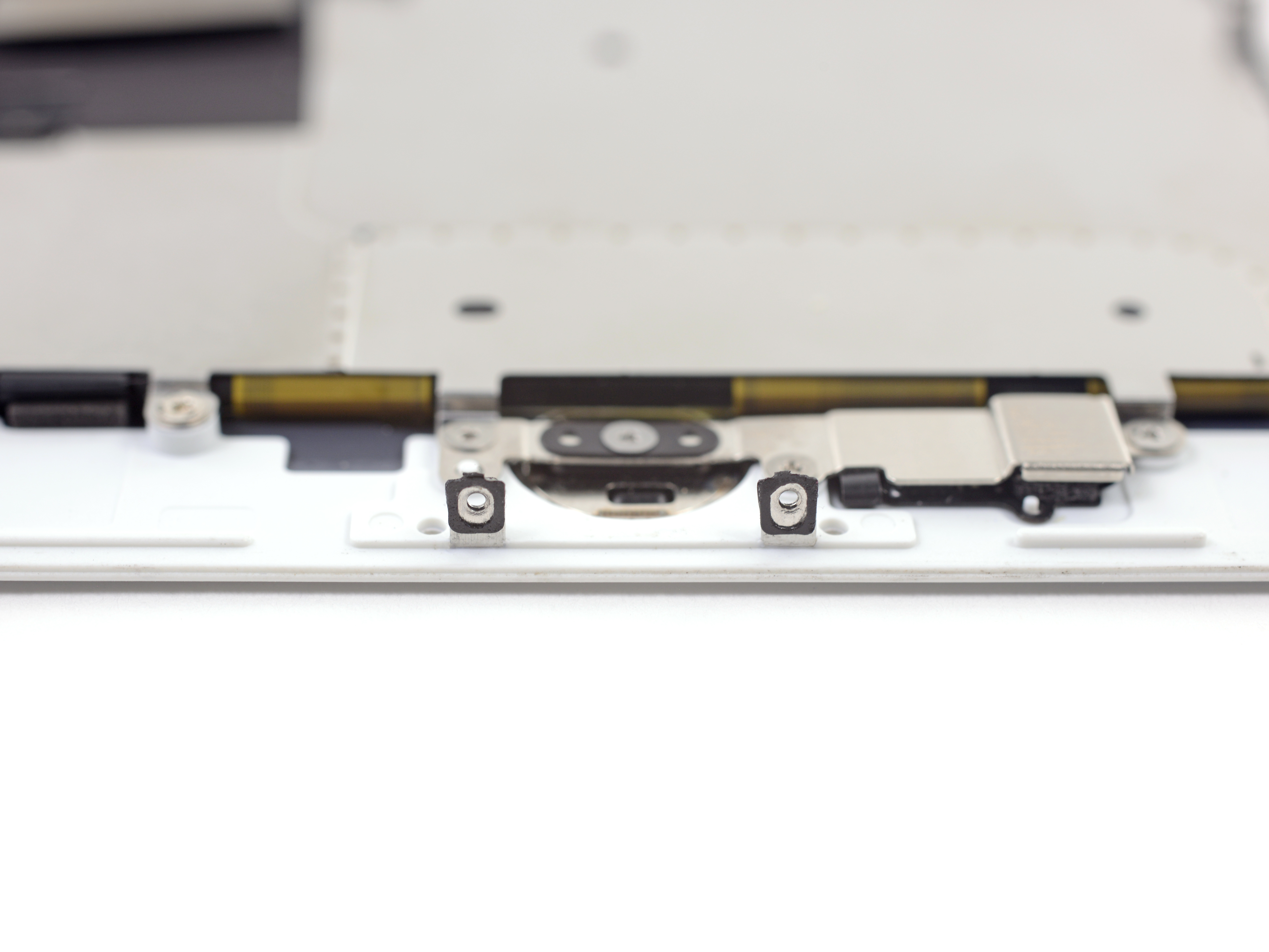

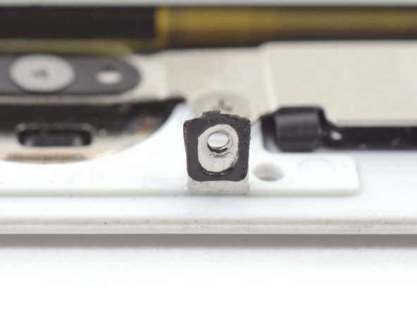

    14. iPhone Display Adhesive Replacement: step 14, image 1 of 2 iPhone Display Adhesive Replacement: step 14, image 2 of 2
      • iPhone 7 / 7 Plus only: Before installing your display, check the condition of the black gaskets on the two small screw bosses on the bottom edge of your display, near the home button.
      • If the gaskets are misaligned, use tweezers to carefully recenter them.
      • iPhone 6s and 6s Plus models don't have these gaskets.

    15. iPhone Display Adhesive Replacement: step 15, image 1 of 3 iPhone Display Adhesive Replacement: step 15, image 2 of 3 iPhone Display Adhesive Replacement: step 15, image 3 of 3
      • While supporting the display, use tweezers to begin peeling off the final release liners, exposing the adhesive.
      Ask FixBot

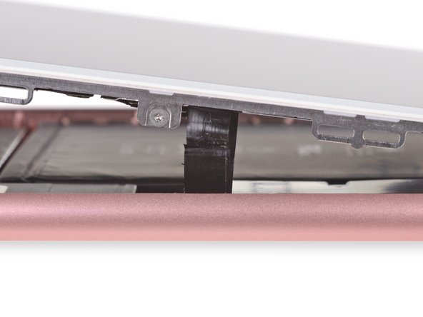

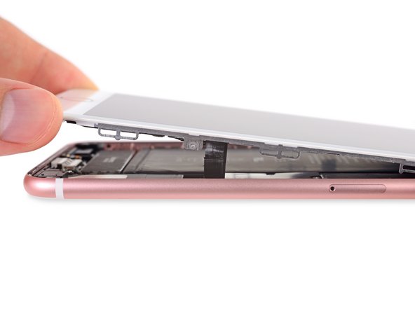

    20. iPhone Display Adhesive Replacement: step 20, image 1 of 2 iPhone Display Adhesive Replacement: step 20, image 2 of 2
      • Before closing up the display, check to make sure that all cables are clear.
      • If any cables get pinched between the edge of the display and the body of the iPhone, they may be damaged beyond repair.
      Ask FixBot

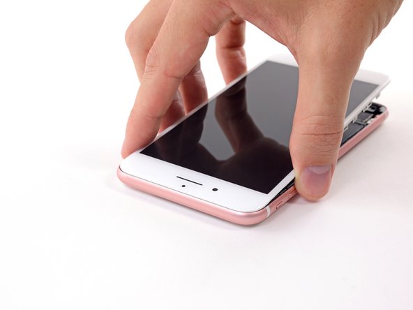

    21. iPhone Display Adhesive Replacement: step 21, image 1 of 3 iPhone Display Adhesive Replacement: step 21, image 2 of 3 iPhone Display Adhesive Replacement: step 21, image 3 of 3

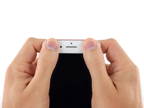

      • As you lower the display into place, apply gentle pressure against the display's bottom edge so that the top edge stays flush with the top edge of the iPhone.
      • This also prevents the two small gaskets near the home button from scraping against the iPhone's lower edge.
      • Press on the sides of the display near the top of the iPhone, and work your way down to click the display into place.
      Ask FixBot

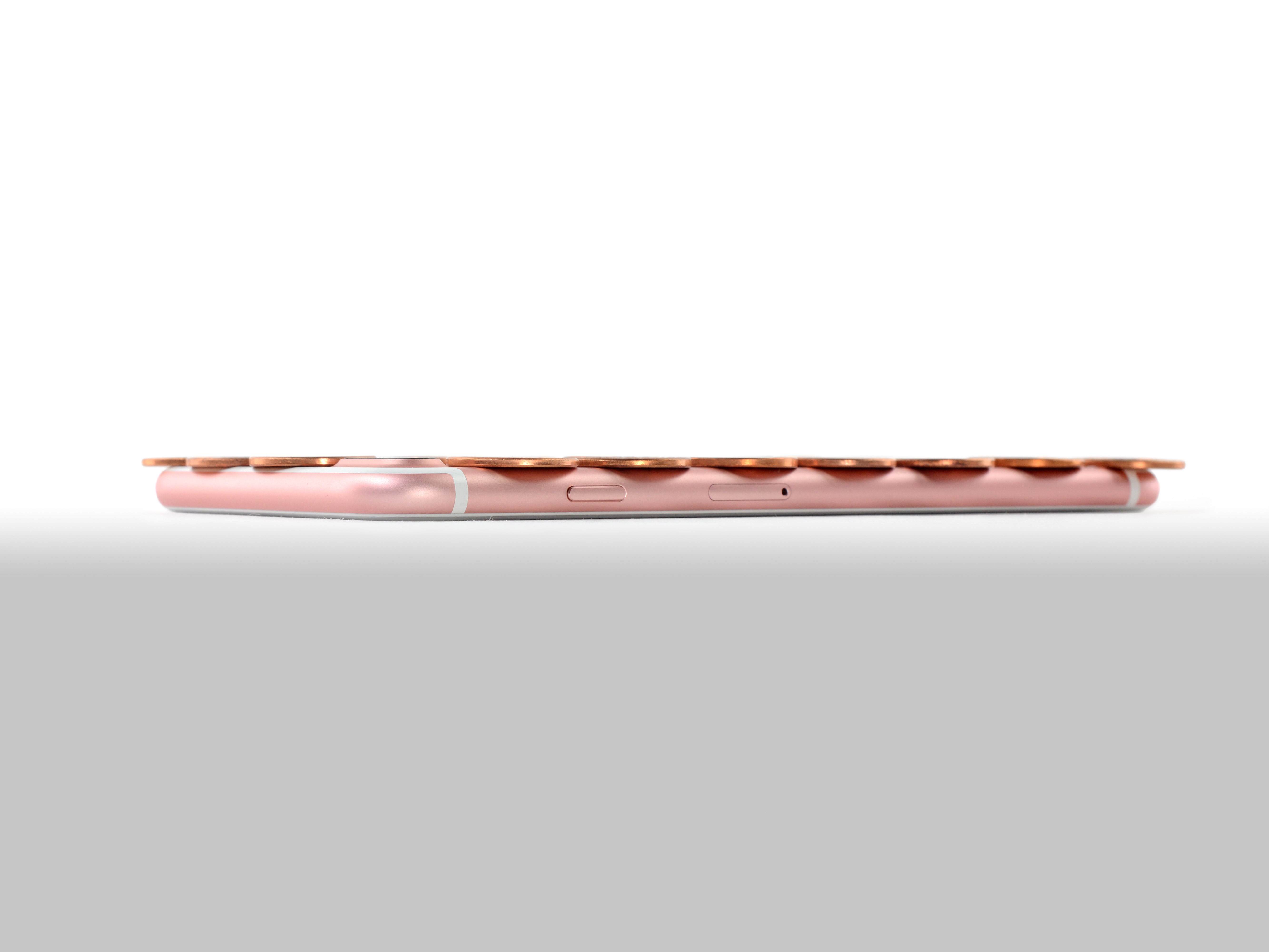

    22. iPhone Display Adhesive Replacement: step 22, image 1 of 3 iPhone Display Adhesive Replacement: step 22, image 2 of 3 iPhone Display Adhesive Replacement: step 22, image 3 of 3
      • In order for the adhesive to bond correctly, you'll need to apply even pressure around the perimeter of your iPhone. The camera bump complicates matters, but you can compensate by laying your iPhone face-down and placing coins around the perimeter.
      • Alternatively, you can use screen vise clamps around the perimeter of your device to set the new adhesive.
      • You can use coins of any denomination, so long as they are as thick or slightly thicker than the camera bump.
      • If your iPhone has a high-gloss finish, such as Jet Black, add a strip of tape around the perimeter to protect the finish before placing any coins.
      • Place a coin at each corner of your iPhone, and place two coins on either side of the camera bump.
      • Place additional coins around the entire perimeter of your iPhone.
      • Using a hair dryer or heat gun, evenly heat the side edges all the way around the iPhone until they are slightly too hot to touch. The heat will help the adhesive form a more complete bond. Don't overheat the iPhone, or you may cause the battery to ignite or damage other heat-sensitive components, like the display.
      Ask FixBot
    23. iPhone Display Adhesive Replacement: step 23, image 1 of 3 iPhone Display Adhesive Replacement: step 23, image 2 of 3 iPhone Display Adhesive Replacement: step 23, image 3 of 3
      • While the iPhone is still hot, grab at least four or five of your heaviest hardcover books, and place them squarely on top of your iPhone.
      • The coins may leave a slight impression on the bottom book cover, so don't use anything valuable.
      • Leave the books in place for about thirty minutes.
