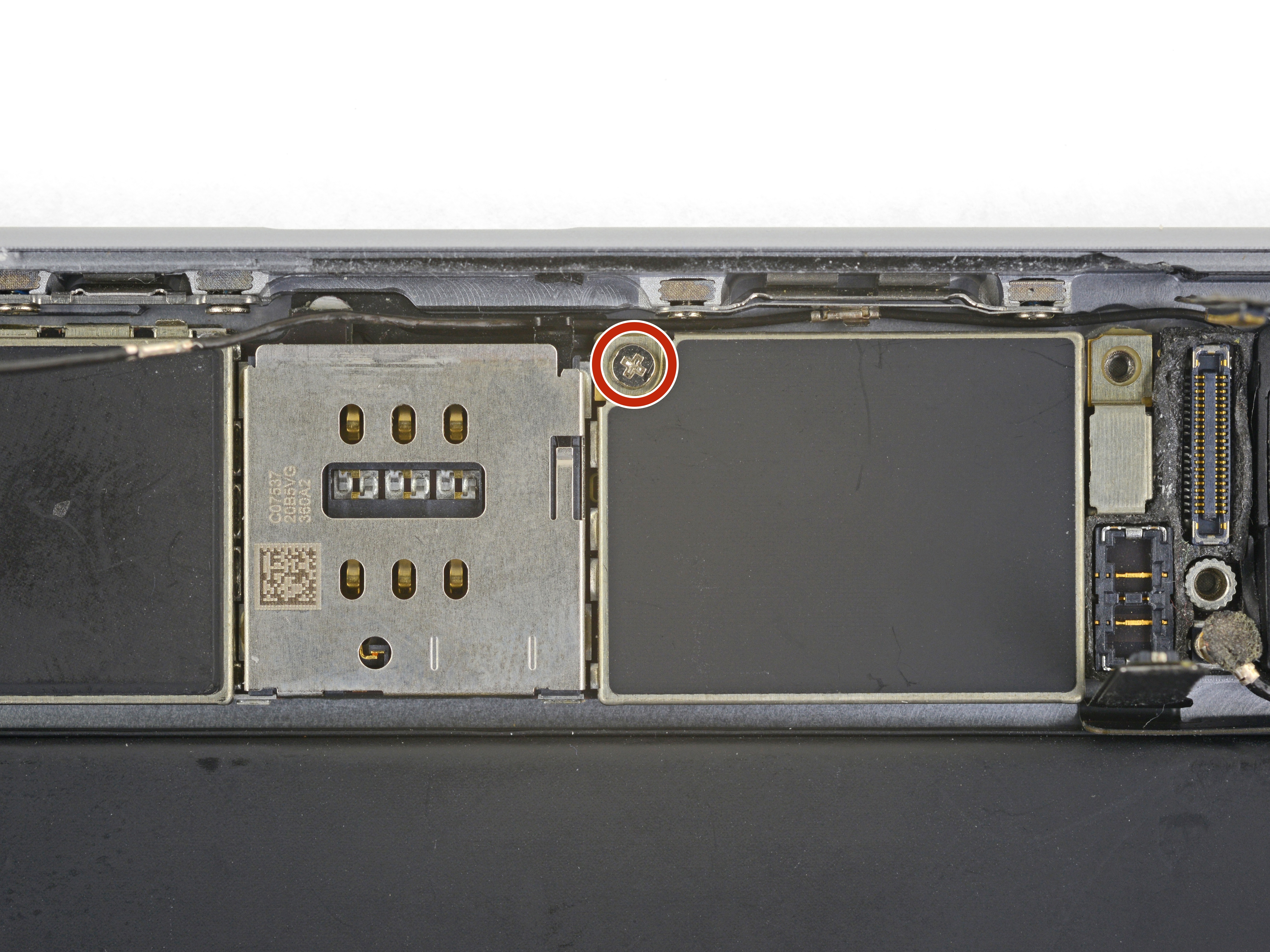

    4. iPhone 6s Lightning Connector Assembly Replacement: step 30, image 1 of 3 iPhone 6s Lightning Connector Assembly Replacement: step 30, image 2 of 3 iPhone 6s Lightning Connector Assembly Replacement: step 30, image 3 of 3
      • Carefully lift the antenna cable and de-route it from the edge of the phone. Use the point of a spudger to help lift the cable to free it from the retaining clips.
      • If the cable does not have enough room to lift up, loosen this Phillips screw securing the logic board so that the board can give more wiggle room.
      • Be sure to re-tighten this screw during re-installation.
      • During re-installation, be sure to route the antenna cable underneath the logic board corner.
      • During re-installation, you can also re-insert the SIM card tray after re-routing the antenna cable.
      • If you feel any resistance, stop and make sure that the tray isn't snagging the antenna cable.
