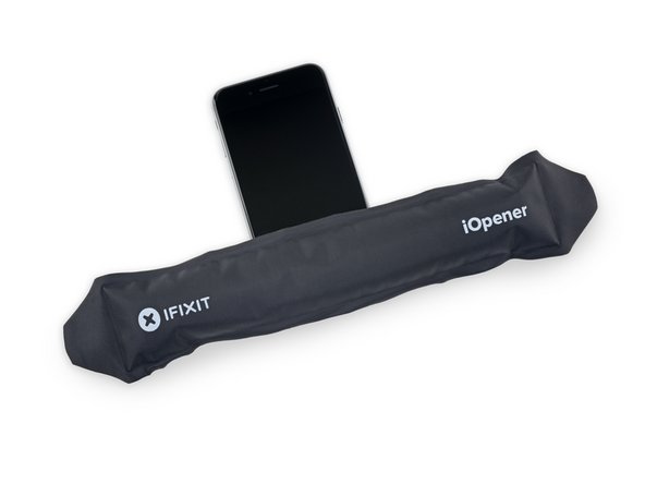

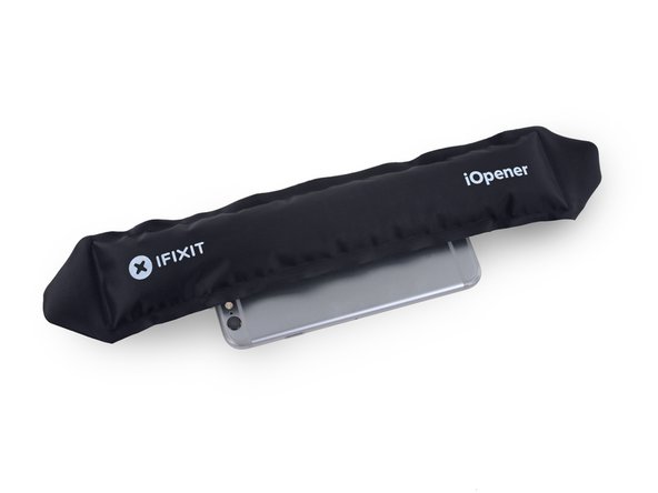

      • If you don't have an Anti-Clamp, follow the next three steps to use a suction handle.
      • Apply mild heat to the lower edge of the iPhone using an iOpener or hair dryer for about a minute.
      • Heat softens the adhesive securing the display, making it easier to open.

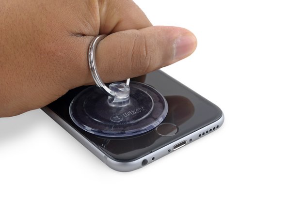

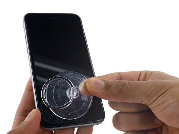

    2. iPhone 6s Battery Replacement: step 5, image 1 of 1
      • Opening the display on the 6s separates a thin strip of adhesive around the perimeter of the display. If you prefer to replace the adhesive, have a set of new adhesive strips ready before you continue. It's possible to complete the repair without replacing the adhesive, and you probably won't notice any difference in functionality.
      • Apply a suction cup to the lower left corner of the display assembly.
      • Take care not to place the suction cup over the home button.
      • If your display is badly cracked, covering it with a layer of clear packing tape may allow the suction cup to adhere. Alternatively, very strong tape may be used instead of the suction cup. If all else fails, you can superglue the suction cup to the broken screen.
      Ask FixBot

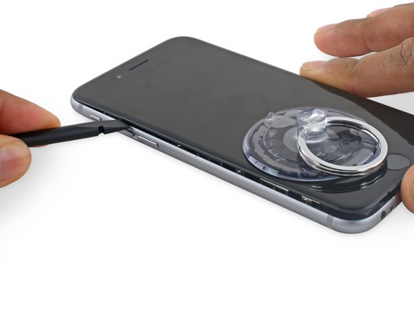

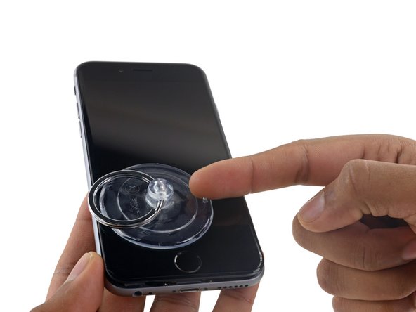

    3. iPhone 6s Battery Replacement: step 6, image 1 of 2 iPhone 6s Battery Replacement: step 6, image 2 of 2
      • Pull up on the suction cup with firm, constant pressure to create a slight gap between the front panel and rear case.
      • Take your time and apply firm, constant force. The display assembly is a much tighter fit than most devices and is held down with adhesive.
      • Pulling too hard may damage the display assembly. Apply just enough pressure to create a small gap between the display assembly and the rear case.
      • If you have any trouble, heat the front of the iPhone using an iOpener, hair dryer, or heat gun until it's slightly too hot to touch. This will help soften the adhesive securing the edges of the display.
      Ask FixBot

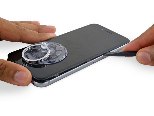

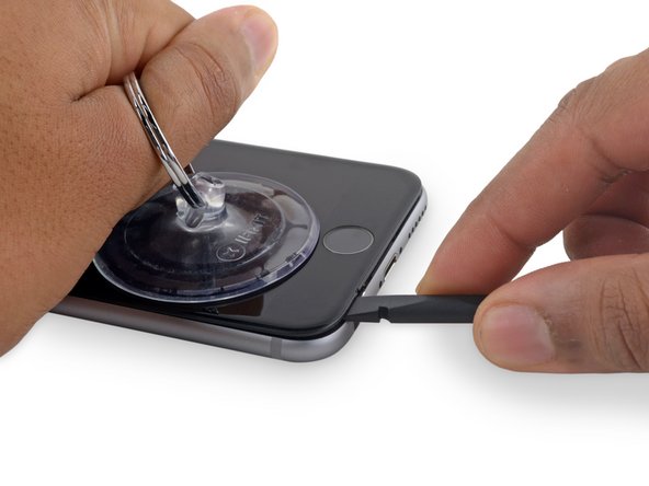

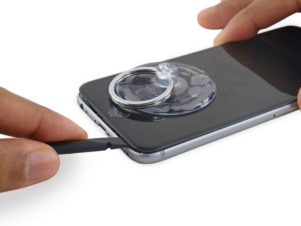

    4. iPhone 6s Battery Replacement: step 7, image 1 of 2 iPhone 6s Battery Replacement: step 7, image 2 of 2
      • There is a notch on the underside of the display, just above the headphone jack. This is the safest place to begin prying the phone open.
      • Place the flat edge of a spudger into the gap between the screen and rear case, directly above the headphone jack.
      Ask FixBot

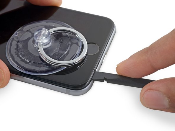

    5. iPhone 6s Battery Replacement: step 8, image 1 of 2 iPhone 6s Battery Replacement: step 8, image 2 of 2
      • Twist the spudger to widen the gap between the front panel assembly and the rest of the phone.

      • Insert the flat end of the spudger on the left side of the phone, between the display assembly and rear case.
      • Slide the spudger up the side of the phone to separate the adhesive and pop the clips free.

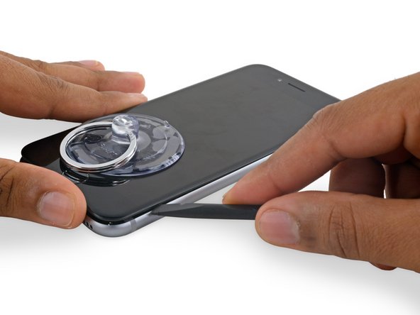

    7. iPhone 6s Battery Replacement: step 10, image 1 of 2 iPhone 6s Battery Replacement: step 10, image 2 of 2
      • Remove the spudger and reinsert it on the bottom edge, where you pried the phone open.
      • Slide the spudger to the right, along the bottom edge of the phone.
      Ask FixBot

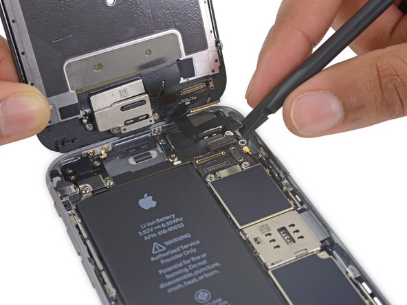

    11. iPhone 6s Battery Replacement: step 14, image 1 of 3 iPhone 6s Battery Replacement: step 14, image 2 of 3 iPhone 6s Battery Replacement: step 14, image 3 of 3
      • Gently grasp the display assembly and lift it up to open the phone, using the clips at the top of the front panel as a hinge.
      • Open the display to about a 90º angle, and lean it against something to keep it propped up while you're working on the phone.
      • Add a rubber band to keep the display securely in place while you work. This prevents undue strain on the display cables.
      • In a pinch, you can use an unopened canned beverage to hold the display.
      • During reassembly, pause here if you wish to replace the adhesive around the edges of the display.
      • During reassembly, the camera end of the screen body needs to hook under the edge of the body. The hooks of the screen frame need to be under the rim of the main body and snugged toward the camera end to easily close the cover and have it properly clip.
      • These hooks are not really a proper hinge but clasps that need to be under the rim of the main phone frame/edge!! This way the screen easily will return to its closed state nicely gently snapping into place.
      • During reassembly, reverse order for getting the screen clipped back in means pressing along the right side top to bottom corner. Then the left.

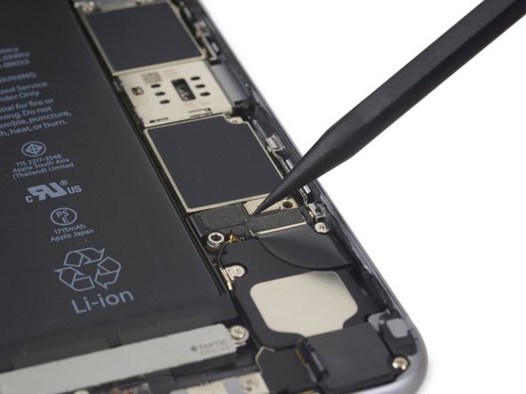

    3. iPhone 6s Battery Replacement: step 17, image 1 of 3 iPhone 6s Battery Replacement: step 17, image 2 of 3 iPhone 6s Battery Replacement: step 17, image 3 of 3
      • Use the point of a spudger to disconnect the battery connector by prying it straight up from the logic board.
      Ask FixBot
    4. iPhone 6s Battery Replacement: step 18, image 1 of 2 iPhone 6s Battery Replacement: step 18, image 2 of 2
      • Push the battery connector away from the logic board until it stays separated from its socket, so as to avoid any accidental connection to the battery while you work.

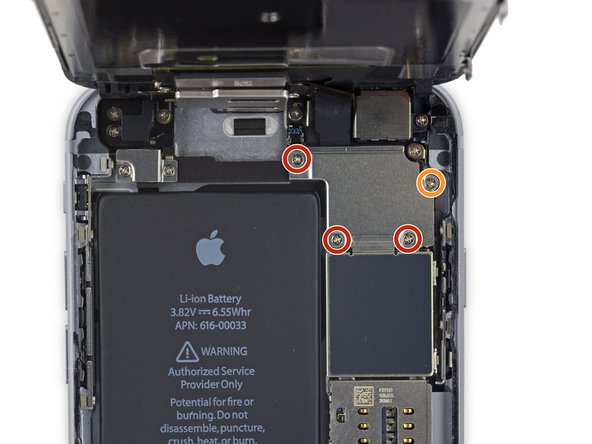

    1. iPhone 6s Battery Replacement, Unfasten the display cable bracket: step 19, image 1 of 1
      • Remove the following four Phillips screws securing the display cable bracket:
      • Three 1.2 mm screws
      • One 2.8 mm screw
      Ask FixBot
    2. iPhone 6s Battery Replacement: step 20, image 1 of 2 iPhone 6s Battery Replacement: step 20, image 2 of 2
      • Remove the display cable bracket.
      Ask FixBot

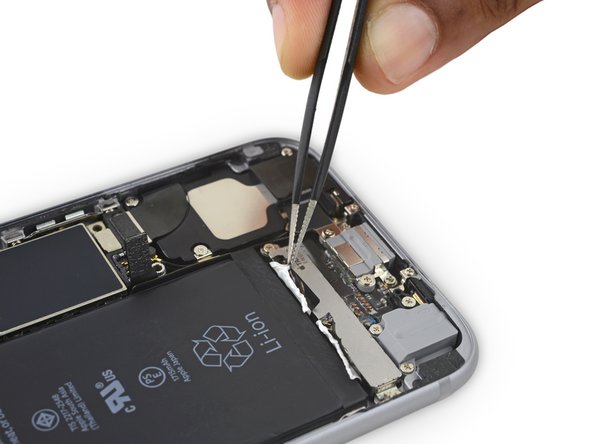

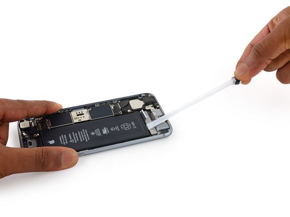

    1. iPhone 6s Battery Replacement, Battery: step 25, image 1 of 3 iPhone 6s Battery Replacement, Battery: step 25, image 2 of 3 iPhone 6s Battery Replacement, Battery: step 25, image 3 of 3
      Tool used on this step:
      Buy
      • Use tweezers to peel back the tips of the two adhesive strips along the bottom edge of the battery.
      • Use your fingers or blunt tweezers. Be careful when working near the battery; puncturing a lithium-ion battery can release dangerous chemicals and/or cause a fire.
      • Optionally, you can remove the Taptic Engine now. This will give you better access to the adhesive strips.
      Ask FixBot

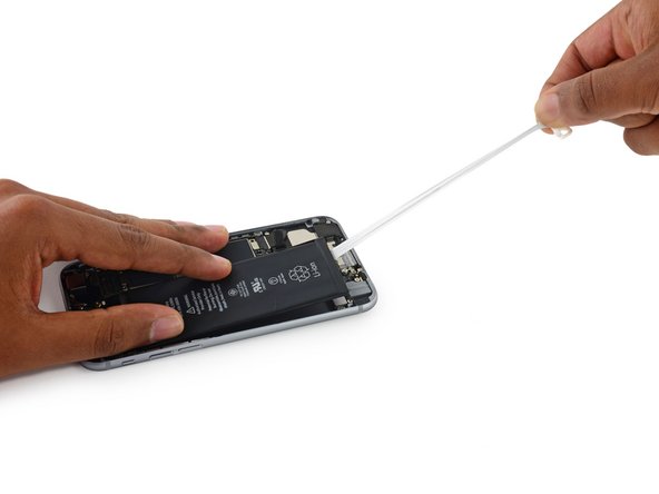

    2. iPhone 6s Battery Replacement: step 26, image 1 of 2 iPhone 6s Battery Replacement: step 26, image 2 of 2
      • Try to keep the strips flat and unwrinkled during this procedure; wrinkled strips will stick together and break instead of pulling out cleanly.
      • Slowly pull one battery adhesive tab away from the battery, toward the bottom of the iPhone.
      • To avoid tearing the adhesive strip, be careful not to snag it against the battery or lower components.
      • Pull steadily, maintaining constant tension on the strip until it slips out from between the battery and the rear case. For best results, pull the strip at a 60º angle or less.
      • The strip will stretch to many times its original length. Continue pulling and re-grab the strip near the battery if necessary.
      Ask FixBot

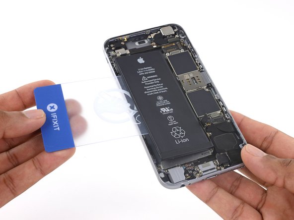

    4. iPhone 6s Battery Replacement, Alternative methods to unstick the battery from the case: step 28, image 1 of 1
      • If you successfully removed both adhesive strips, move on to the next step. Otherwise, you will need to pry the battery from the rear case.
      • Prepare an iOpener and apply it to the back of the rear case, directly over the battery. Otherwise, you can apply heat using a heat gun or hair dryer.
      • Then, use a plastic opening tool to gently lift the battery.
      • Overheating the iPhone may ignite the battery.
      • Alternatively, a piece of dental floss may be used to separate the battery from the rear case. A stronger alternative to dental floss is an unwound guitar string, such as a 0.009 E string from a 12-string set.
      • Thread the floss or string behind the upper battery corners, bring the ends together, wrap them around a folded cloth, and pull evenly.

Easy fix. I would recommend getting the adhesive for the screen, as I completely destroyed about half of it when I removed the screen.
cziebell937 - Reply Share
the adhesive strip under the battery do not use your hand to pull out, use tweezer and a stick roll it up slowly.......
luke foxy - Reply Share
That's a good idea! But on the other hand it looks a bit funny expanding it to about 1 meter ;-) - especially nice, if the owner is there watching …
Michael Gasperl - Reply Share
That was actually way better than the original suggestion. If you hold the tweezer a little to the side while you roll up the adhesive, it will come off a little bit easier.
KatSeiko - Reply Share
I found that instead of trying to pull the adhesive strips straight out, that by shifting the strip side to side as I pulled allowed it to “inch out” and break the bond more on a diagonal and snap out in one piece….
James Brewer - Reply Share
