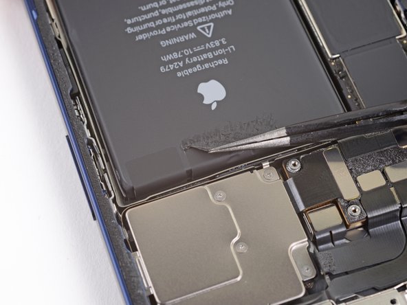

    1. iPhone 12 mini Battery Replacement, Remove the adhesive strips: step 29, image 1 of 2 iPhone 12 mini Battery Replacement, Remove the adhesive strips: step 29, image 2 of 2
      • Peel down the first battery adhesive pull-tab to un-stick it from the bottom edge of the battery.
      • Don't jab the battery with any sharp tools. A punctured battery may leak dangerous chemicals or catch fire.
      Ask FixBot

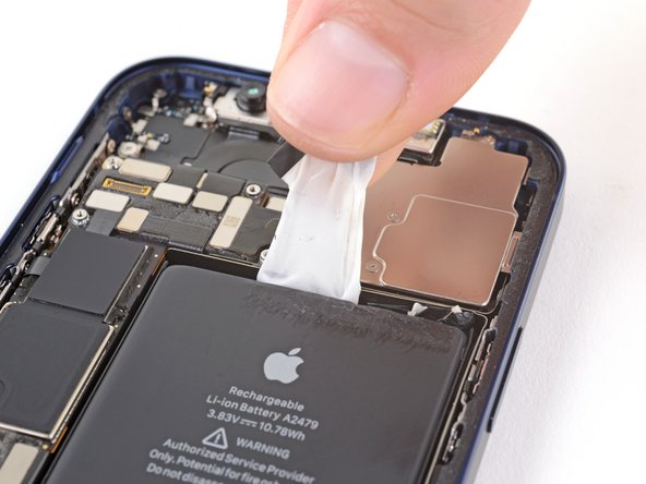

    3. iPhone 12 mini Battery Replacement: step 31, image 1 of 2 iPhone 12 mini Battery Replacement: step 31, image 2 of 2
      • Grab the wide pull tab with your fingers and slowly pull it away from the battery, toward the bottom of the iPhone.
      Ask FixBot
