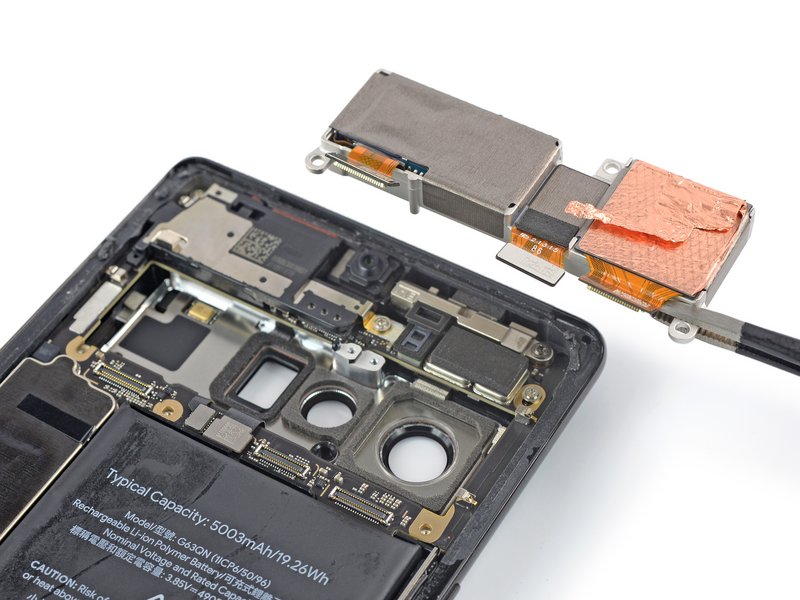

    1. Google Pixel 6 Pro Rear Camera Replacement, Unfasten the camera connector cover screws: step 26, image 1 of 1
      • Use a Torx T3 screwdriver to remove the two 5.1 mm-long 3IP Torx Plus screws securing the camera connector cover.
      Ask FixBot
    2. Google Pixel 6 Pro Rear Camera Replacement, Remove the camera connector cover: step 27, image 1 of 2 Google Pixel 6 Pro Rear Camera Replacement, Remove the camera connector cover: step 27, image 2 of 2
      Tool used on this step:
      Buy
      • Use a pair of tweezers to remove the camera connector cover.

    7. Google Pixel 6 Pro Rear Camera Replacement, Remove the camera assembly: step 32, image 1 of 3 Google Pixel 6 Pro Rear Camera Replacement, Remove the camera assembly: step 32, image 2 of 3 Google Pixel 6 Pro Rear Camera Replacement, Remove the camera assembly: step 32, image 3 of 3
      • Use a pair of tweezers or your fingers to carefully lift the camera assembly out of its recess and remove it.
      • Compare your new replacement part to the original part—you may need to transfer remaining components or remove adhesive backings from the new part before installing.
      • If your replacement camera module has a plastic spacer, be sure to remove it before you install the module.
      • Make sure the lens surface is smudge and dust free before you install the camera assembly.
