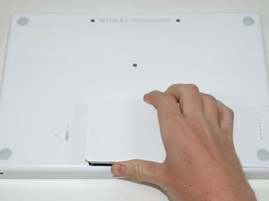

- Battery: Replacing the battery requires a coin or a flat-edge tool release the battery latch. The battery can be replaced in less than 30 seconds.
