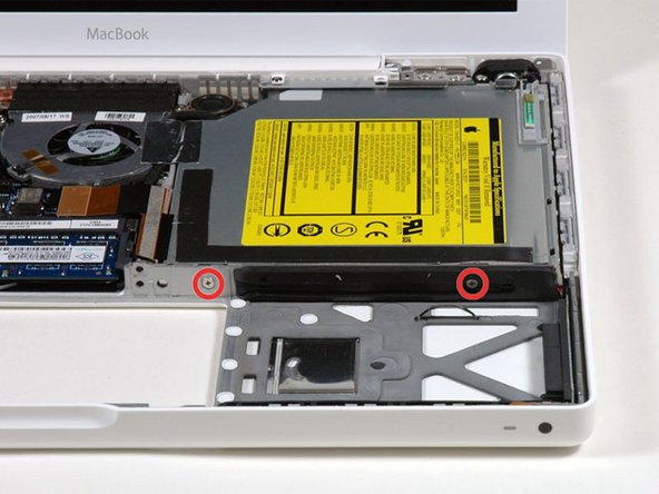

    2. MacBook Core 2 Duo Inverter Cable Replacement: step 14, image 1 of 1
      • Remove the two Phillips screws from the side of the optical drive.
      • Two 3.25 mm Phillips #000 (head: 4 mm. dia. x .3 mm thick)
      Ask FixBot

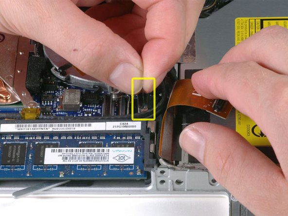

    4. MacBook Core 2 Duo Inverter Cable Replacement: step 16, image 1 of 1
      • Disconnect the newly revealed display data cable's plug from the logic board by pulling it upward using its black pull-tab.
      • If there is no pull-tab on top of the plug, it may be helpful to use a spudger to disconnect this plug.
      Ask FixBot

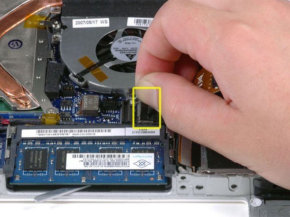

    5. MacBook Core 2 Duo Inverter Cable Replacement: step 17, image 1 of 1
      • Disconnect the newly-revealed hard drive cable's plug from the logic board by pulling it upward using its black tab.
      • When reconnecting the hard drive cable's plug to the logic board, make sure the plug is routed under the cables for the right speaker and the microphone, or else the plug won't sit flush with the logic board, which will prevent the plug from fully engaging with its socket on the logic board.
      Ask FixBot

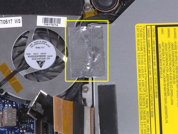

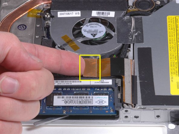

    6. MacBook Core 2 Duo Inverter Cable Replacement: step 18, image 1 of 1
      • Peel up the foil tape between the fan and the optical drive. Lift the foil tape from the fan side, leaving it attached to the optical drive.
      • During reassembly, be sure to route the cables beneath the tape before reattaching it.
      • If the adhesive on this foil tape no longer sticks, you can hold it in place using a regular piece of tape, but don't block the fan intake.
      Ask FixBot

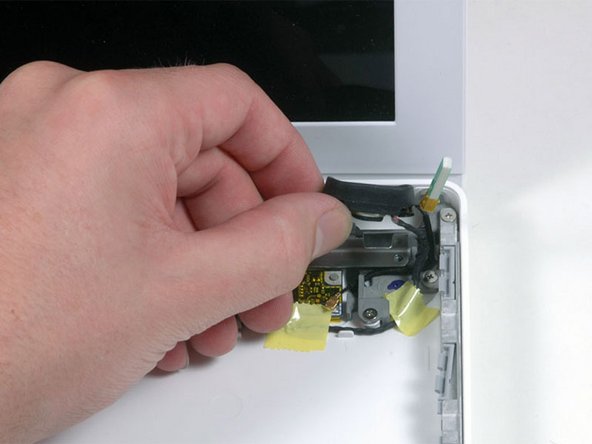

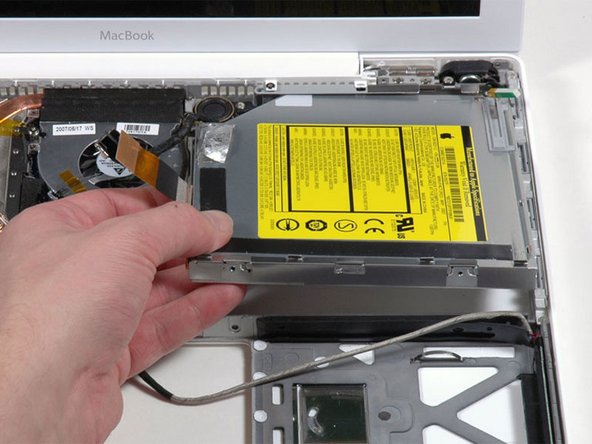

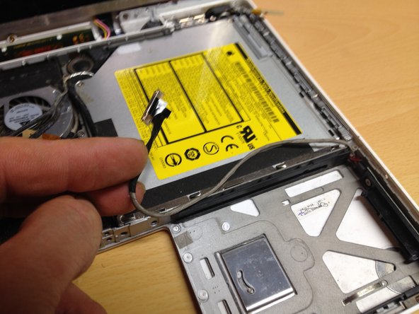

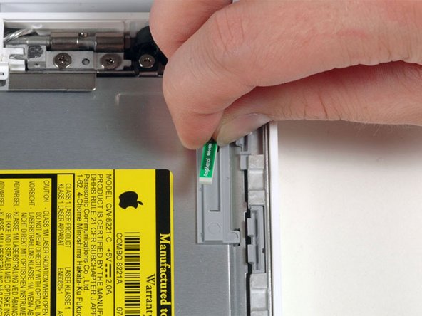

    9. MacBook Core 2 Duo Inverter Cable Replacement: step 21, image 1 of 1
      • Lift the Bluetooth antenna board from the front edge of the optical drive.
      Ask FixBot
    10. MacBook Core 2 Duo Inverter Cable Replacement: step 22, image 1 of 1
      • Deroute the hard drive cable from under the clips along the near side of the optical drive.
      • During reassembly, reroute the cable under these clips.
      Ask FixBot
    11. MacBook Core 2 Duo Inverter Cable Replacement: step 23, image 1 of 1
      • Lift the side of the optical drive closest to you, then slide the drive towards you, and up and out of the computer.
      • Follow these steps to reinstall the optical drive:
      • First, slide its side nearest to the rear of the Macbook under the edge of the rear frame to the left of the hinge, while also sliding the optical drive's mounting tab at its upper left corner under the cables at this location.
      • Lower the drive partially into the lower housing. Keep the hard drive cable away from the optical drive bay.
      • Before dropping the drive fully in place, use a spudger to push forward (towards the front of the drive) on the screw hole in the drive's mounting tab.
      • Push forward the slider, which runs along the far side of the drive, to insert the end of this slider into a small channel in the lower case's frame. This helps hold the drive in place.
      • When you push the slider forward, if the screw hole in the drive's mounting tab doesn't line up over its threaded brass insert in the lower case, the front end of the slider hasn't fully inserted into its channel in the frame. Keep trying, but if the slider won't move further to the right, remove the drive to see if the end of the slider is bent.
      • If the front end of the slider isn't bent, it may be slightly too long. Use a pair of fine cutters to clip off the narrower portion of the end of the slider. The optical drive will still remain firmly in place.
      Ask FixBot

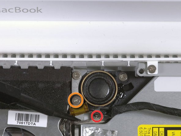

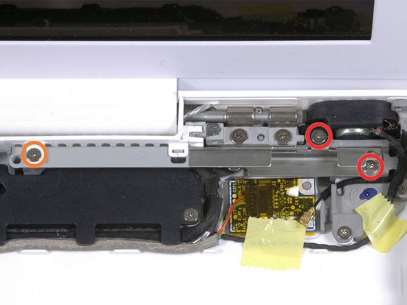

    1. MacBook Core 2 Duo Inverter Cable Replacement, C-Channel: step 24, image 1 of 1
      • For original Macbook Core Duo and Core 2 Duo models, remove these 3 screws:
      • Two 3 mm Phillips near the right speaker.
      • One 6 mm Phillips threaded through a hole in a plastic finger above the subwoofer.
      • When reinstalling the screw above the subwoofer, be careful not to over-tighten it or the subwoofer's plastic could crack.
      • For Santa Rosa/Penryn and 2009 models, which don't have a c-channel:
      • Remove only the single 3 mm Phillips screw from the right speaker, and skip step 26.
      Ask FixBot

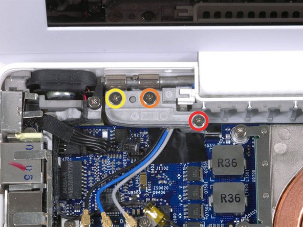

    3. MacBook Core 2 Duo Inverter Cable Replacement: step 29, image 1 of 1
      • If you didn't remove the ground lug retaining screw in step 20 above, remove it now. It's a 7mm (may be 4mm or 3mm in Santa Rosa/Penryn and 2009 models) Phillips screw securing the ground lugs on the right speaker cable and microphone cable to the metal frame.
      Ask FixBot
    4. MacBook Core 2 Duo Inverter Cable Replacement: step 30, image 1 of 2 MacBook Core 2 Duo Inverter Cable Replacement: step 30, image 2 of 2
      • Deroute the microphone cable and the black display data cable from the tabs at the bottom of the subwoofer.
      • During reassembly, while there may seem to be more than one way to route the cables, the best way is as shown in photo 2. Click on the photo for a larger view.
      Ask FixBot
    5. MacBook Core 2 Duo Inverter Cable Replacement: step 31, image 1 of 1
      • Remove the single 3 mm Phillips screw securing the ground lug in the display data cable located just above the Bluetooth board. This screw may also be securing a ground lug in the speaker cable.
      Ask FixBot

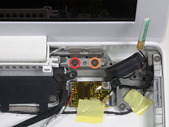

    6. MacBook Core 2 Duo Inverter Cable Replacement: step 32, image 1 of 2 MacBook Core 2 Duo Inverter Cable Replacement: step 32, image 2 of 2
      • Disconnect the antenna cables from the Airport card:
      • If you have an original MacBook Core Duo or Core 2 Duo model, see the first picture, which shows that there are three antenna cables.
      • If you have a MacBook Core 2 Duo Santa Rosa/Penryn or 2009 model, there are only two antenna cables, and the plug/socket for the black inverter cable is in a different location. There may be a square foam piece over the plug/socket for the inverter board connector.
      • Disconnect the inverter cable from its socket by inserting a spudger between the right or left ends of the plug and the socket, and prying gently vertically. Do NOT pry up on the socket--you must pull up on the plug alone, vertically out of the socket. Do not pull in the direction of the cable wires or you will tear the socket off the logic board.
      Ask FixBot

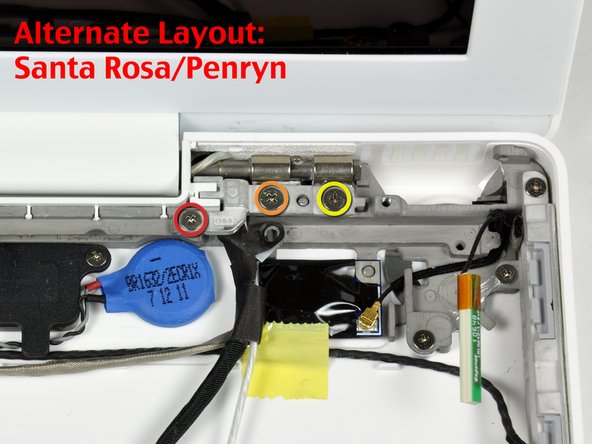

    7. MacBook Core 2 Duo Inverter Cable Replacement: step 33, image 1 of 2 MacBook Core 2 Duo Inverter Cable Replacement: step 33, image 2 of 2
      • For original Macbook Core Duo and Core 2 Duo models, see first picture and remove the following 2 screws from the right hinge mount:
      • One 6 mm Phillips on the left side of the hinge mount.
      • One 10 mm Phillips on the right side of the hinge mount.
      • For Santa Rosa/Penryn and 2009 models, see second picture and remove the following 3 screws from the right hinge mount:
      • One 3 mm smalller diameter Phillips on the far left.
      • One 5.2 mm larger diameter, 4.2 mm head Phillips in the middle.
      • One 10 mm larger diameter, 4.2mm head Phillips from the far right.
      • Before removing the right hinge mount, take care to see how its pieces fit together, including the small white plastic piece. Knowing how the mount pieces fit together will help with reassembly. Lift the right hinge mount with the small white plastic piece out of the computer.

      • Hold the display with one hand while removing the following 3 screws from the left hinge mount:
      • One 7.2 mm smaller diameter Phillips from the right side.
      • One 5.2 mm larger diameter Phillips from the middle.
      • One larger diameter 10 mm Phillips from the left side.
      • Before removing the left hinge mount, take care to see how its pieces fit together, including the small white plastic piece. Knowing how the mount pieces fit together will help with reassembly.
      • In 2009 models, the shape of the left hinge mount may be different than shown in the photo, but the locations and sizes of its screws are the same.
      • Lift the left hinge mount with white plastic piece out of the computer.
      • Check that the cables coming out of the right end of the left hinge are not trapped under other cables.
