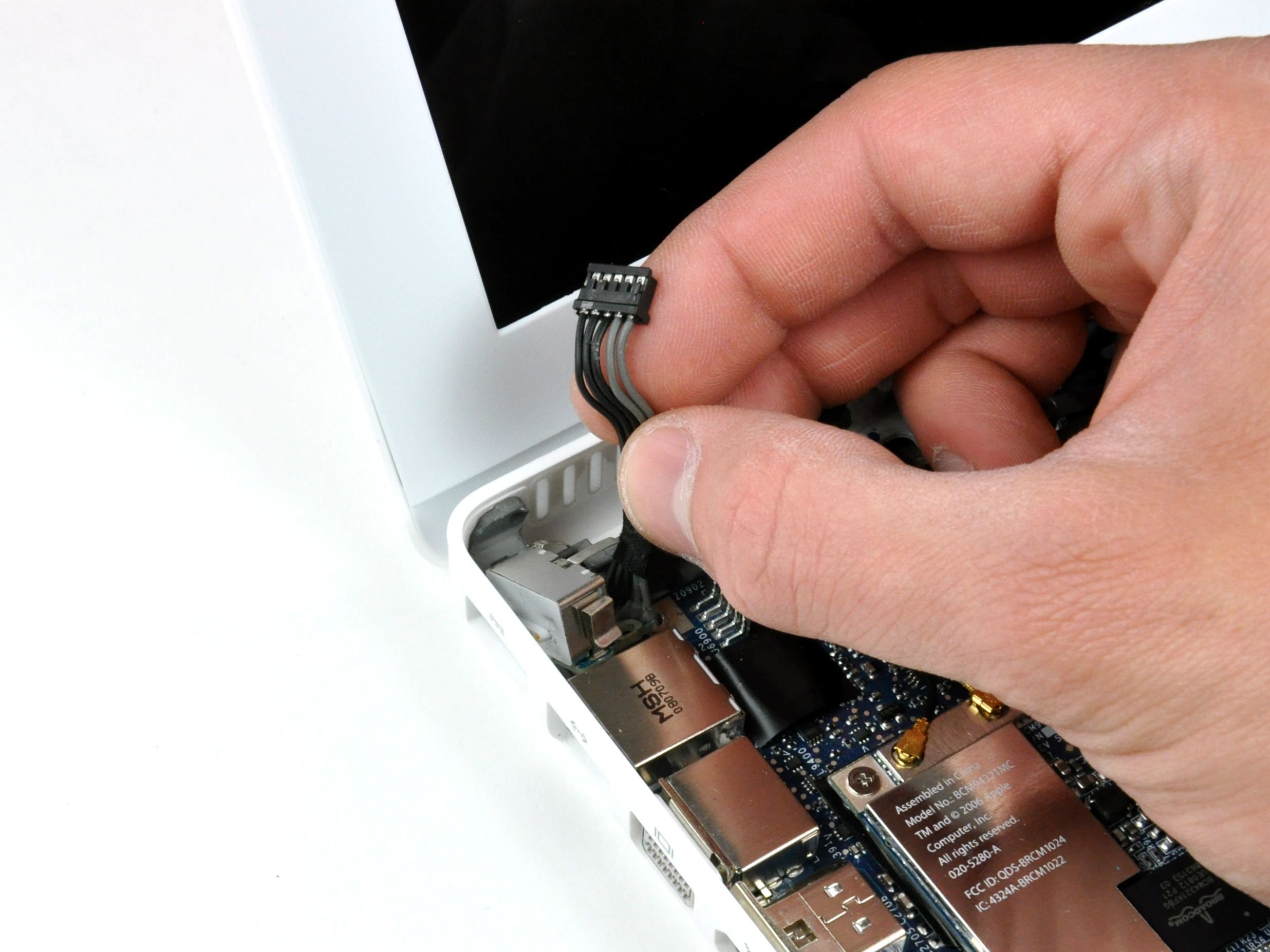

      • Gently de-route the speaker cable from the left I/O frame.
      • Use a spudger to lift the left speaker out of its housing. Grasp it with your fingers and move it out of the way.
      • Do not attempt to fully remove the speaker from the laptop, it is still attached the the logic board.

      • The MagSafe board connector is underneath the wires, be sure to pull on the connector itself pulling parallel to the socket.
      • Disconnect the MagSafe board connector from the logic board.
