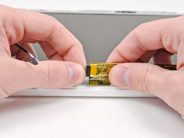

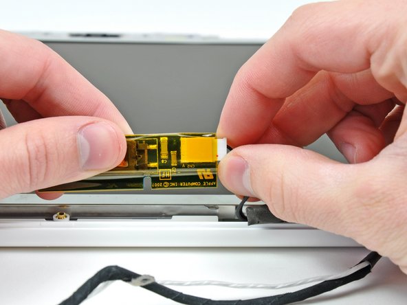

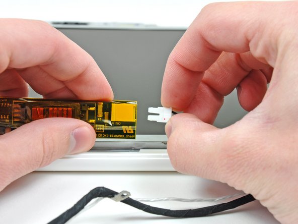

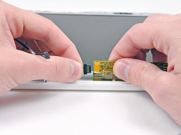

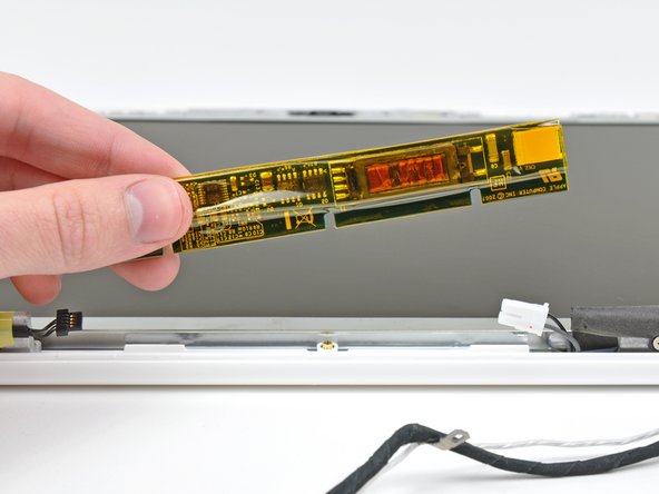

    6. MacBook Core 2 Duo Inverter Replacement: step 32, image 1 of 2 MacBook Core 2 Duo Inverter Replacement: step 32, image 2 of 2
      • Disconnect the antenna cables from the Airport card:
      • If you have an original MacBook Core Duo or Core 2 Duo model, see the first picture, which shows that there are three antenna cables.
      • If you have a MacBook Core 2 Duo Santa Rosa/Penryn or 2009 model, there are only two antenna cables, and the plug/socket for the black inverter cable is in a different location. There may be a square foam piece over the plug/socket for the inverter board connector.
      • Disconnect the inverter cable from its socket by inserting a spudger between the right or left ends of the plug and the socket, and prying gently vertically. Do NOT pry up on the socket--you must pull up on the plug alone, vertically out of the socket. Do not pull in the direction of the cable wires or you will tear the socket off the logic board.
      Ask FixBot

    1. MacBook Core 2 Duo Inverter Replacement, Inverter: step 45, image 1 of 2 MacBook Core 2 Duo Inverter Replacement, Inverter: step 45, image 2 of 2
      • Slightly lift the newly-revealed inverter board out of its housing and disconnect the black inverter cable from the left end of the board.

    2. MacBook Core 2 Duo Inverter Replacement: step 46, image 1 of 2 MacBook Core 2 Duo Inverter Replacement: step 46, image 2 of 2
      • Disconnect the white inverter cable from the right end of the inverter board.

    3. MacBook Core 2 Duo Inverter Replacement: step 47, image 1 of 1
      • Remove the inverter board from the display.
