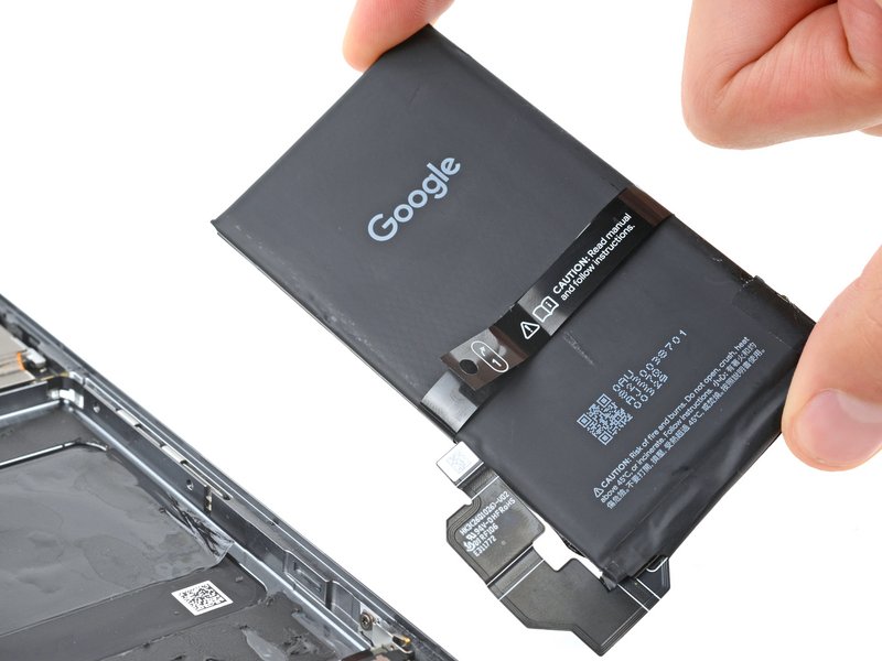

Follow this guide to replace a dead or worn out battery in your Google Pixel 8 Pro.
If your battery is swollen, take appropriate precautions.
Lithium-ion batteries have a limited lifespan. If your phone doesn't hold a charge or dies unexpectedly, it might be time to replace the battery.
You'll need replacement screen adhesive to complete this repair.
Note: This guide was made with the 5G mmWave antenna model of the Pixel 8 Pro. If you have the non-mmWave version, you can still use this guide—just skip the steps that mention the 5G mmWave antenna.

    1. Google Pixel 8 Pro Battery Replacement, Prepare your Pixel for disassembly: step 1, image 1 of 3 Google Pixel 8 Pro Battery Replacement, Prepare your Pixel for disassembly: step 1, image 2 of 3 Google Pixel 8 Pro Battery Replacement, Prepare your Pixel for disassembly: step 1, image 3 of 3
      • Let your Pixel's battery drain below 25% before starting this repair. A charged lithium‑ion battery may catch fire if damaged.
      • Unplug all cables from your phone.
      • Completely power off your phone.
      • Press the power and volume up buttons at the same time to bring up the shutdown menu.

    1. Google Pixel 8 Pro Battery Replacement, Disconnect the 5G mmWave antenna: step 24, image 1 of 2 Google Pixel 8 Pro Battery Replacement, Disconnect the 5G mmWave antenna: step 24, image 2 of 2
      • The next few steps show how to disconnect and detach the 5G mmWave antenna cable. If your phone doesn't have a 5G mmWave antenna, skip the next four steps.
      • Be very careful not to scrape off or damage any surface mounted components during this step.
      • Insert the tip of a spudger under the top edge of the 5G mmWave antenna's press connector.
      • Gently pry up and disconnect the cable.

    5. Google Pixel 8 Pro Battery Replacement, Remove the battery: step 39, image 1 of 3 Google Pixel 8 Pro Battery Replacement, Remove the battery: step 39, image 2 of 3 Google Pixel 8 Pro Battery Replacement, Remove the battery: step 39, image 3 of 3
      • Use the opening pick to lift the battery and separate the remaining adhesive.
      • Remove the battery.
      • During reassembly, follow this guide to remove the old adhesive and install your battery.
