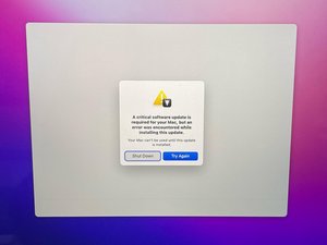

Error messages are amongst the most helpful clues you can get during troubleshooting procedures. They can point you toward a specific hardware fault, or a troublesome app. But what happens when the error message is vague and seems to repeat despite corrective efforts? Usually rampant frustration. Keep reading for some clarity on this one.
This particular error only effects MacBook Pros 2016 and newer, with a Touch Bar. If your Mac doesn't have a Touch Bar, check the MacBook troubleshooting page for help that's more relevant.

Causes
Solution: Update firmware or macOS
Any part of the T1 or T2 chip's `systems can be the cause of this issue, but start by trying to get the update to process. If you still don't get normal boot after these steps you're sure to have a hardware failure.

The Whole Issue
For Extra Credit
MacBook Pros, starting with the 2016 Touch Bar model, include a coprocessor alongside the Intel CPU. It manages some of the peripherals, especially ones involved in secure operations.
Apple called the initial version T1, followed in 2017 by T2. These coprocessors are modified CPUs from other Apple devices. They are intended to optimize security and power efficiency by offloading tasks from the more power hungry Intel CPU. They utilize their own operating system (bridgeOS) and are responsible most notably for Touch ID and Touch Bar function as well as integration with the webcam and ambient light sensor systems. T2 also works with the microphone and sound systems to help support security features in addition to the voice recognition component of “Hey Siri.”
Even though it is involved in so many parts of the MacBook, a malfunctioning coprocessor usually will not prevent the MacBook from turning on, or booting. But your Mac will throw a tantrum if it’s not behaving properly.
When your MacBook Pro is harassing you about this mysterious firmware update, what it’s actually trying to tell you is that something with your coprocessor (or one of the systems it operates) isn’t working correctly and it can’t be used. The Mac defaults to reinstalling, or updating its firmware to correct this, but often the issue is deeper and you’ll get stuck in a loop.
