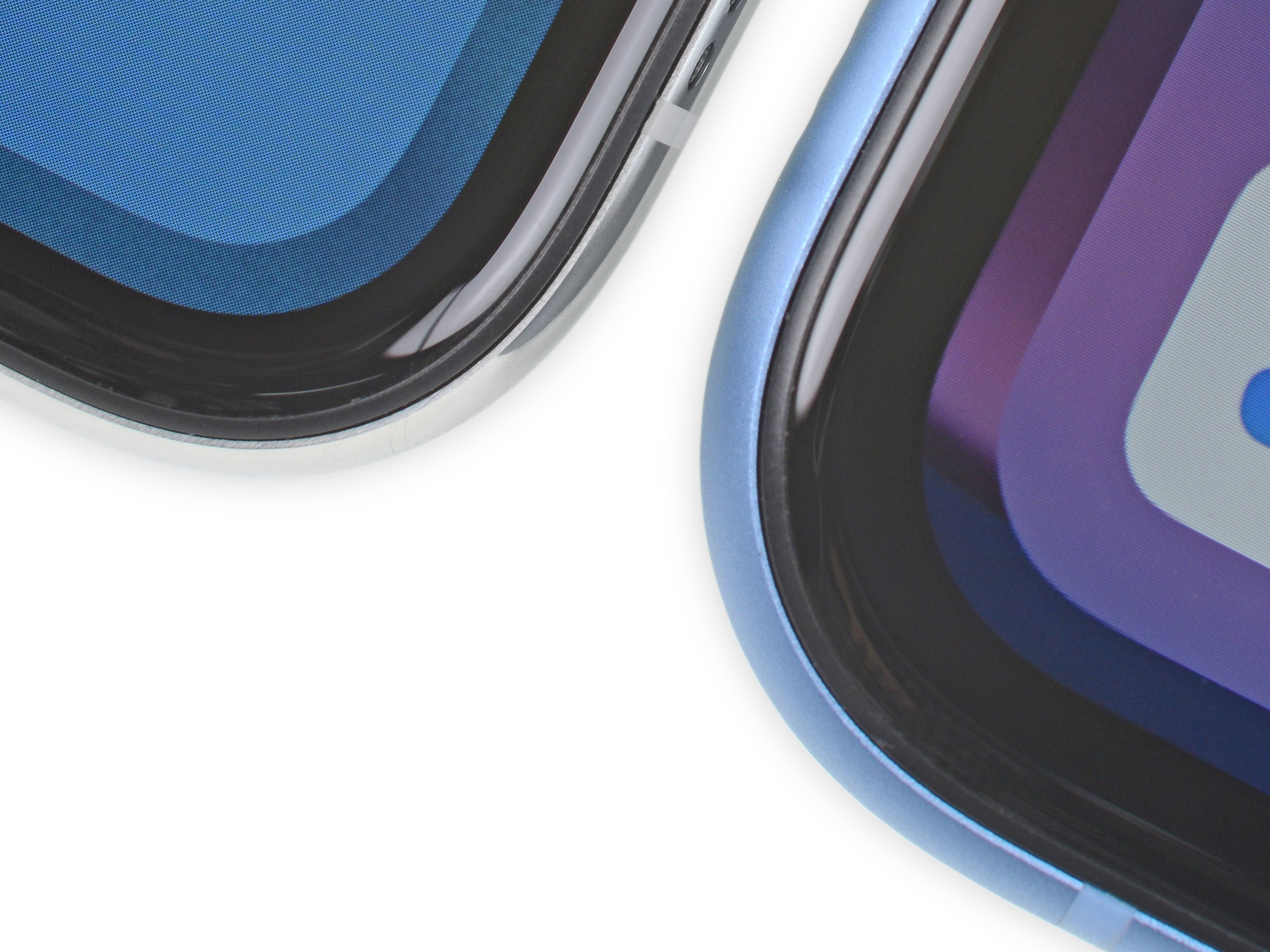

    • Switching on the displays, it's easy to see that the XR's bezels are a bit bigger—and if you get really close, the curves start to get a little rough around the edges.
