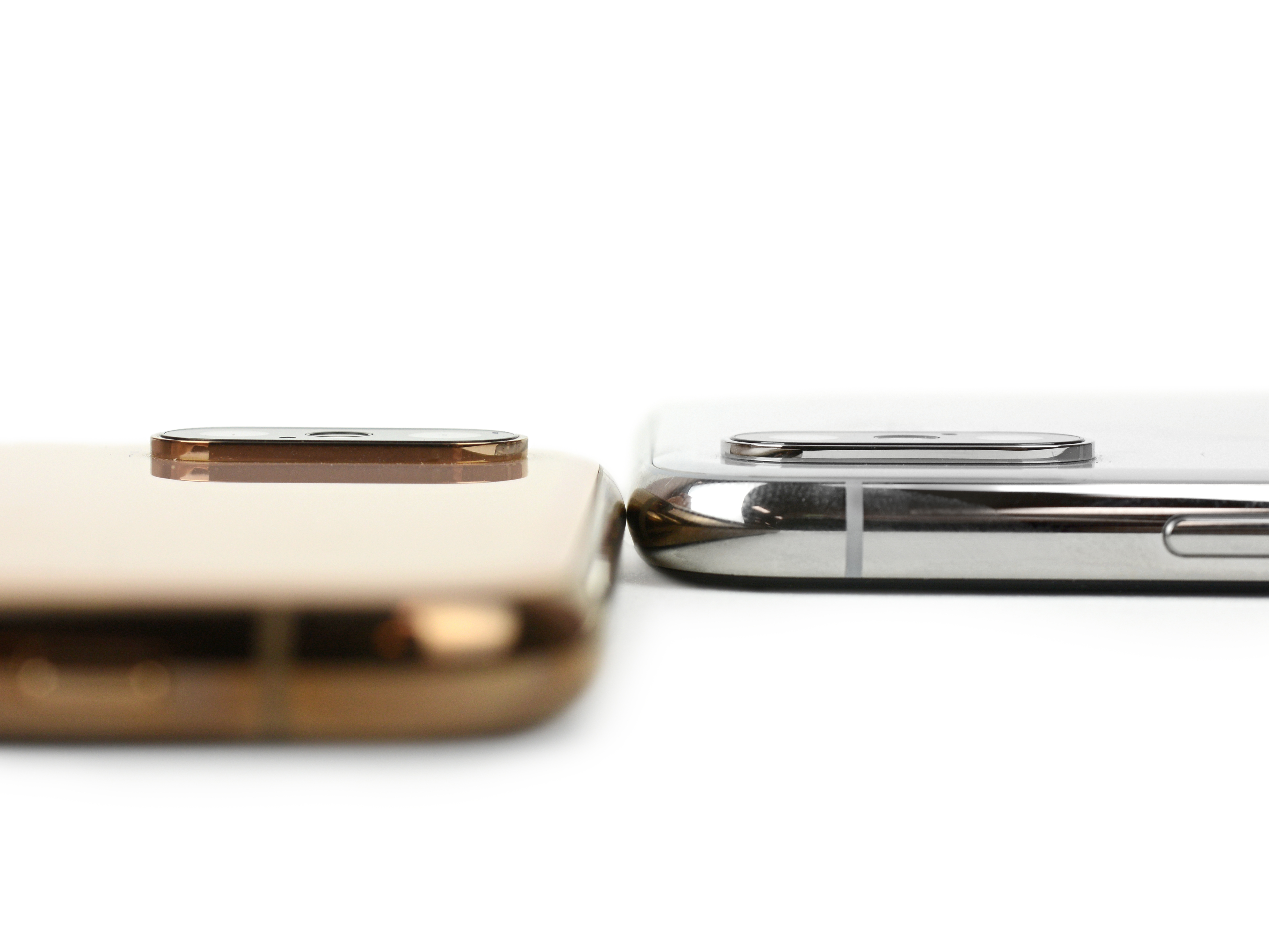

    • We aren't one to judge a book by its Gorilla Glass cover, but these covers don't suggest that much has changed since the last X we saw on this table.
    • ... Besides the luxurious gold color and the new XL size option, that is.
