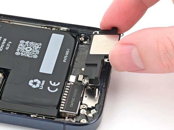

    2. iPhone 15 Pro Battery Replacement, Remove the loudspeaker: step 25, image 1 of 3 iPhone 15 Pro Battery Replacement, Remove the loudspeaker: step 25, image 2 of 3 iPhone 15 Pro Battery Replacement, Remove the loudspeaker: step 25, image 3 of 3
      • A plastic buffer is adhered to the top edges of the loudspeaker and Taptic Engine.
      • Lift the bottom edge of the loudspeaker until you can grab it with your fingers.
      • Peel the loudspeaker from the plastic buffer on its top edge and remove it.

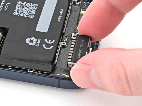

    1. iPhone 15 Pro Battery Replacement, Disconnect the Taptic Engine: step 26, image 1 of 2 iPhone 15 Pro Battery Replacement, Disconnect the Taptic Engine: step 26, image 2 of 2
      • Use the point of a spudger to pry up and disconnect the Taptic Engine press connector.
      Ask FixBot
    2. iPhone 15 Pro Battery Replacement, Unfasten the Taptic Engine: step 27, image 1 of 2 iPhone 15 Pro Battery Replacement, Unfasten the Taptic Engine: step 27, image 2 of 2
      • Use a Phillips #000 screwdriver to remove the two 2 mm‑long screws securing the Taptic Engine.
      Ask FixBot

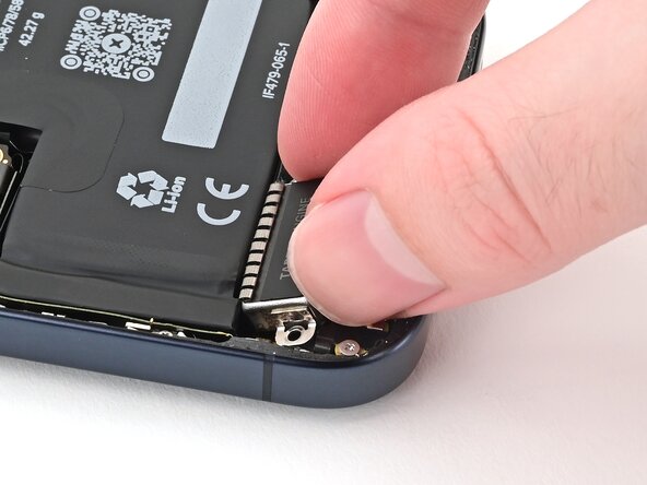

    3. iPhone 15 Pro Battery Replacement, Remove the Taptic Engine: step 28, image 1 of 1
      • Remove the Taptic Engine.
      Ask FixBot

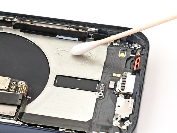

    4. iPhone 15 Pro Battery Replacement, Alternate method to remove the battery: step 32, image 1 of 2 iPhone 15 Pro Battery Replacement, Alternate method to remove the battery: step 32, image 2 of 2
      • If you removed all three stretch release adhesive strips, congratulations—you can now remove the battery! If not, follow the next two steps to separate the adhesive with isopropyl alcohol and a plastic card.
      • If the top strip remains, prop up the top edge of the phone.
      • If either of the bottom strips remain, prop up the left edge of the phone (the side with the volume buttons).
      • Use a pipette or syringe to apply a few drops of highly-concentrated isopropyl alcohol (over 90%) to the elevated edge of the battery.

    1. iPhone 15 Pro Battery Replacement, Clean the frame: step 36, image 1 of 3 iPhone 15 Pro Battery Replacement, Clean the frame: step 36, image 2 of 3 iPhone 15 Pro Battery Replacement, Clean the frame: step 36, image 3 of 3
      • Use cotton swabs or a lint‑free cloth and high‑concentration (>90%) isopropyl alcohol to wipe off any battery adhesive residue from the iPhone's frame.

    8. iPhone 15 Pro Battery Replacement, Install the Taptic Engine: step 43, image 1 of 3 iPhone 15 Pro Battery Replacement, Install the Taptic Engine: step 43, image 2 of 3 iPhone 15 Pro Battery Replacement, Install the Taptic Engine: step 43, image 3 of 3
      • Place the Taptic Engine into its recess in the frame.
      Ask FixBot

    10. iPhone 15 Pro Battery Replacement, Connect the Taptic Engine: step 45, image 1 of 2 iPhone 15 Pro Battery Replacement, Connect the Taptic Engine: step 45, image 2 of 2
      • Use the flat end of a spudger to connect the Taptic Engine press connector.

    11. iPhone 15 Pro Battery Replacement, Install the loudspeaker: step 46, image 1 of 3 iPhone 15 Pro Battery Replacement, Install the loudspeaker: step 46, image 2 of 3 iPhone 15 Pro Battery Replacement, Install the loudspeaker: step 46, image 3 of 3
      • Place the loudspeaker into its recess in the frame.
      Ask FixBot
    12. iPhone 15 Pro Battery Replacement: step 47, image 1 of 1
      • Use a Phillips #000 screwdriver to install the four screws securing the loudspeaker:
      • One 2.7 mm‑long screw
      • Three 2 mm‑long screws
