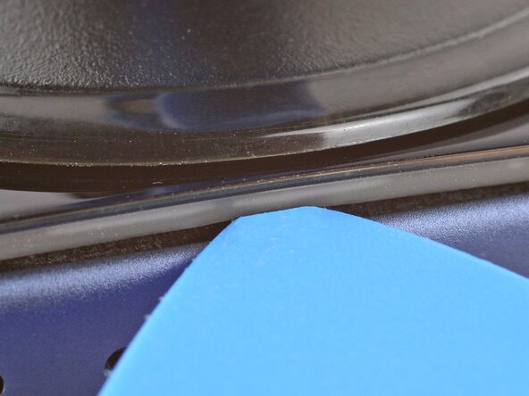

    7. iPhone 13 Screen Replacement, Screen information: step 9, image 1 of 3 iPhone 13 Screen Replacement, Screen information: step 9, image 2 of 3 iPhone 13 Screen Replacement, Screen information: step 9, image 3 of 3
      • To avoid damaging your screen in the next step, note the following:
      • There's a plastic bezel on the underside of the screen. Your opening pick will go underneath this bezel.
      • There's a seam between the plastic bezel and the display panel. Don't insert your pick here or you'll damage the screen.
      • Sometimes the display panel separates from the bezel before you even get a chance to insert a pick. This may be unavoidable depending on the condition of the adhesive. In this case, you’ll most likely need to replace your entire screen.
      Ask FixBot
    8. iPhone 13 Screen Replacement, Lift the screen slightly: step 10, image 1 of 3 iPhone 13 Screen Replacement, Lift the screen slightly: step 10, image 2 of 3 iPhone 13 Screen Replacement, Lift the screen slightly: step 10, image 3 of 3
      • Pull up on the suction handle with firm, constant pressure to create a slight gap under the screen’s plastic bezel.
      • The adhesive holding the screen in place is very strong. If you're having a hard time, be patient, apply more heat, and try again.
      • Insert an opening pick into the gap.
      • Remember to insert the opening pick under the thick plastic bezel to avoid damaging your screen.

    13. iPhone 13 Screen Replacement, Disconnect the microphone: step 33, image 1 of 3 iPhone 13 Screen Replacement, Disconnect the microphone: step 33, image 2 of 3 iPhone 13 Screen Replacement, Disconnect the microphone: step 33, image 3 of 3
      • Insert an opening pick under the microphone cable, close to the microphone (the metal rectangle).
      • Slide the opening pick around the perimeter of the microphone to separate its adhesive.
      Ask FixBot
