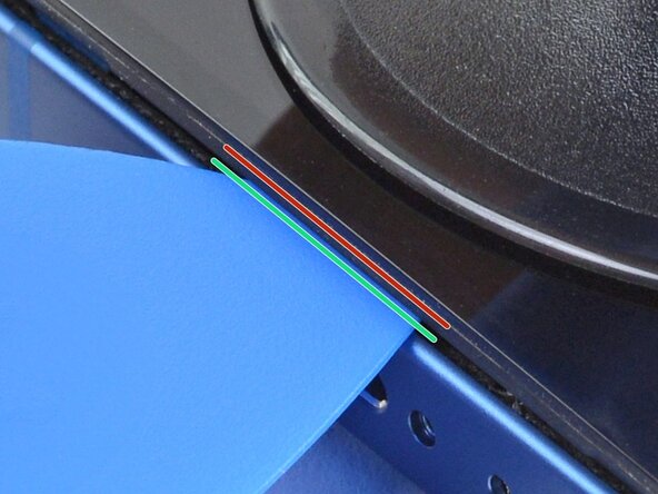

    2. iPhone 12 Pro Max Screen Replacement, Screen damage warning: step 4, image 1 of 3 iPhone 12 Pro Max Screen Replacement, Screen damage warning: step 4, image 2 of 3 iPhone 12 Pro Max Screen Replacement, Screen damage warning: step 4, image 3 of 3
      • To avoid damaging your screen in the next steps, note the following:
      • There's a plastic bezel on the underside of the screen. Your opening pick will go underneath this bezel.
      • There's a seam between the plastic bezel and the display panel. Don't insert your pick here or you'll damage the screen.
      • Sometimes the display panel separates from the bezel before you even get a chance to insert a pick. This may be unavoidable depending on the condition of the adhesive. In this case, you’ll most likely need to replace your entire screen.
