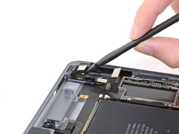

    1. iPad Pro 9.7" Rear Camera Replacement, Disconnect the rear camera: step 46, image 1 of 2 iPad Pro 9.7" Rear Camera Replacement, Disconnect the rear camera: step 46, image 2 of 2
      • Use the pointed end of a spudger to disconnect the rear camera's press connector from its socket.
      • Be careful to pry only under the edge of the connector, and not under the socket itself. If you pry under the socket, you will separate it from the circuit board.
      • To reconnect, align the connector carefully over its socket and press down with your fingertip—first at one side, then the other—until it clicks into place.
      • Do not press down on the middle until the connector is fully seated—if it's misaligned, the connector can bend, causing permanent damage.

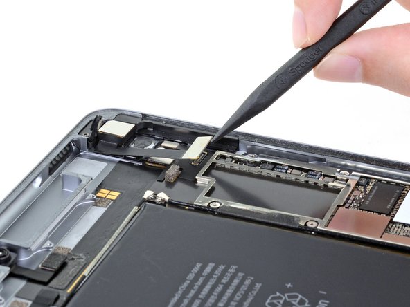

    2. iPad Pro 9.7" Rear Camera Replacement, Pry up the rear camera: step 47, image 1 of 2 iPad Pro 9.7" Rear Camera Replacement, Pry up the rear camera: step 47, image 2 of 2
      • Insert the flat end of a spudger under the bottom edge of the rear camera and pry up to detach it from the frame.
      • If it doesn't detach from the frame when you pry up, apply a few drops of high-concentration (90% or higher) isopropyl alcohol to the perimeter of the rear camera. Wait thirty seconds for the isopropyl alcohol to weaken the adhesive.
      • If you're going to reuse the rear camera, don't use an excessive amount of isopropyl alcohol and don't get any on the camera lens. Isopropyl alcohol on the lens may cause permanently foggy photos.
