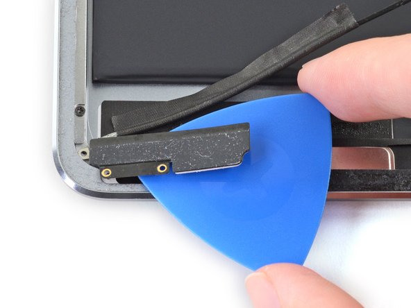

  53. iPad Pro 9.7" Left Wi-Fi/Bluetooth Antenna Replacement, Detach the left antenna bracket: step 53, image 1 of 2 iPad Pro 9.7" Left Wi-Fi/Bluetooth Antenna Replacement, Detach the left antenna bracket: step 53, image 2 of 2
    • Use an opening pick to detach the left antenna bracket from the frame.
    • The left antenna bracket is adhered to the frame with a thin foam adhesive piece.
    • If the thin foam adhesive piece isn't sufficiently tacky during reassembly, apply a few strips of pre-cut adhesive under the bracket to secure it to the frame.
