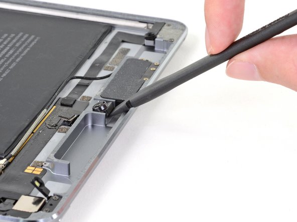

    2. iPad Pro 9.7" Front Camera Replacement, Pry up the front camera: step 47, image 1 of 2 iPad Pro 9.7" Front Camera Replacement, Pry up the front camera: step 47, image 2 of 2
      • Insert the flat end of a spudger under the top edge of the front camera and pry up to detach it from the frame.
      • If it doesn't detach from the frame when you pry up, apply a few drops of high-concentration (90% or higher) isopropyl alcohol to the perimeter of the front camera. Wait thirty seconds for the isopropyl alcohol to weaken the adhesive.
      • If you're going to reuse the front camera, don't use an excessive amount of isopropyl alcohol and don't get any on the camera lens. Isopropyl alcohol on the lens may cause permanently foggy photos.

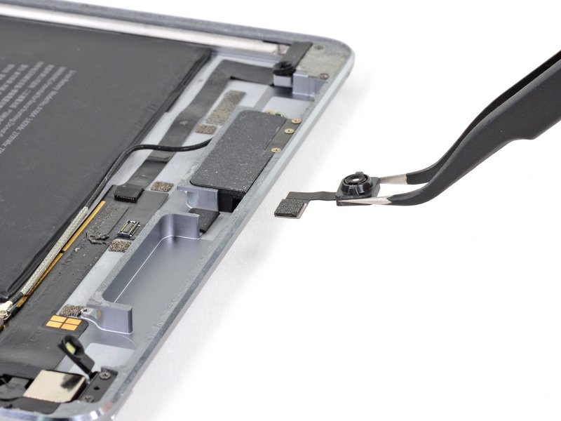

    3. iPad Pro 9.7" Front Camera Replacement, Remove the front camera: step 48, image 1 of 1
      Tool used on this step:
      Buy
      • Use a pair of tweezers to remove the front camera.
      • If you plan to reuse the front camera, be careful not to scratch the lens.
      • If there's any alcohol solution remaining in the device, carefully wipe it off or allow it to air dry before installing your front camera.
      • During reassembly, follow this guide if you are using a pre-cut adhesive card to secure the front camera to the frame.
