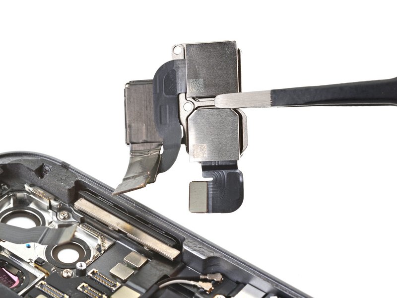

    6. iPad Pro 12.9" 5th Gen Rear Camera Assembly Replacement, Remove the rear camera assembly: step 37, image 1 of 3 iPad Pro 12.9" 5th Gen Rear Camera Assembly Replacement, Remove the rear camera assembly: step 37, image 2 of 3 iPad Pro 12.9" 5th Gen Rear Camera Assembly Replacement, Remove the rear camera assembly: step 37, image 3 of 3
      • Insert a spudger between the right edge of the rear camera assembly and the frame.
      • Pry up to separate the rear camera from the frame.
      • Remove the rear camera assembly.
