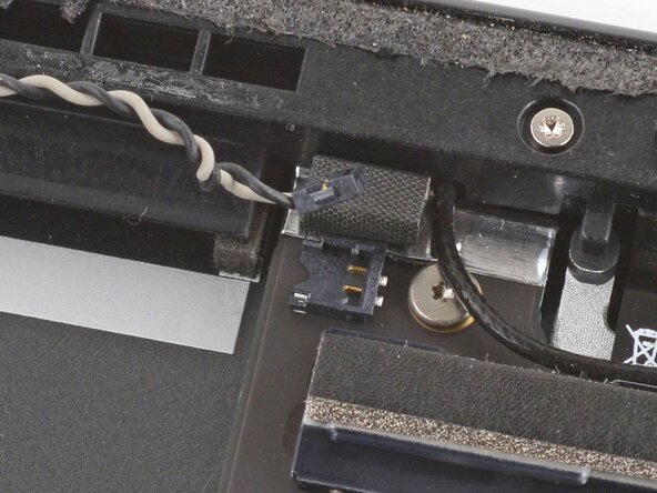

    3. Microsoft Surface Pro 8 Battery Replacement, Reassembly note: step 21, image 1 of 3 Microsoft Surface Pro 8 Battery Replacement, Reassembly note: step 21, image 2 of 3 Microsoft Surface Pro 8 Battery Replacement, Reassembly note: step 21, image 3 of 3
      • During reassembly:
      • Check if the speaker wire got disconnected near the top edge of the fan.
      • If it did, align the connector over its socket and push down with the flat end of a spudger to reconnect it—the connector should click into place.
      Ask FixBot

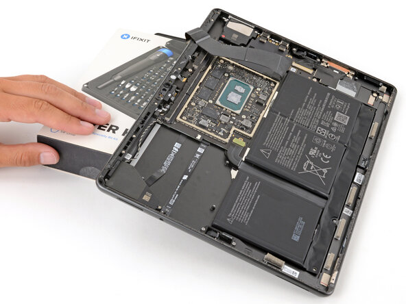

    6. Microsoft Surface Pro 8 Battery Replacement, Remove the fan and heatsink assembly: step 24, image 1 of 2 Microsoft Surface Pro 8 Battery Replacement, Remove the fan and heatsink assembly: step 24, image 2 of 2
      • Use two hands to grip the fan and heatsink assembly close to the center and lift to remove it.
      Ask FixBot
    7. Microsoft Surface Pro 8 Battery Replacement, Remove the metal gasket: step 25, image 1 of 2 Microsoft Surface Pro 8 Battery Replacement, Remove the metal gasket: step 25, image 2 of 2
      • Use your fingers to gently remove the metal heat sink gasket and set it aside.
      • The gasket will either be on the motherboard or on the bottom of the heat sink.
      Ask FixBot

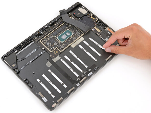

    3. Microsoft Surface Pro 8 Battery Replacement, Adhesive information: step 30, image 1 of 2 Microsoft Surface Pro 8 Battery Replacement, Adhesive information: step 30, image 2 of 2
      • Eight strips of stetch-release adhesive secure the battery cells to the frame.
      • Be careful not to damage the battery when removing the strips—it can leak dangerous chemicals and/or catch fire.
      Ask FixBot

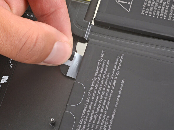

    4. Microsoft Surface Pro 8 Battery Replacement, Peel up the pull tab: step 31, image 1 of 3 Microsoft Surface Pro 8 Battery Replacement, Peel up the pull tab: step 31, image 2 of 3 Microsoft Surface Pro 8 Battery Replacement, Peel up the pull tab: step 31, image 3 of 3
      • Start with the three strips on the left battery cell. They have better access, making it easier to get a feel for how to properly remove the strips.
      • Slide the tip of an opening pick under one of the pull tabs and use your fingers to fully separate it from the battery.
      Ask FixBot

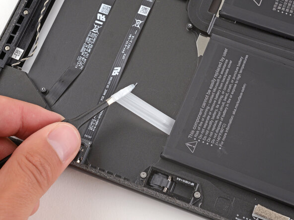

    5. Microsoft Surface Pro 8 Battery Replacement, Remove the adhesive strip: step 32, image 1 of 3 Microsoft Surface Pro 8 Battery Replacement, Remove the adhesive strip: step 32, image 2 of 3 Microsoft Surface Pro 8 Battery Replacement, Remove the adhesive strip: step 32, image 3 of 3
      • It takes time and constant tension to release the adhesive strips. Be patient and don't yank on them.
      • Grip the pull tab with a pair of blunt-nose tweezers and slowly pull the strip out from under the battery at a shallow angle.
      • Twist the adhesive around the tweezers while continuing to pull until the whole strip comes out.
      • The strip may make a "squeaking" noise—that's normal and means the adhesive is releasing.
      • If a strip or its pull tab breaks off, use tweezers to try and retrieve it. If you can't reach it, leave it—a different method for separating any leftover adhesive will be shown later in the guide.
      Ask FixBot
    6. Microsoft Surface Pro 8 Battery Replacement, Remove the remaining adhesive strips: step 33, image 1 of 2 Microsoft Surface Pro 8 Battery Replacement, Remove the remaining adhesive strips: step 33, image 2 of 2
      • Remove the seven remaining adhesive strips from the top edge of the battery.
      • Because the motherboard is so close to the strips on the middle and right battery cells, you'll need to pull the strips out at an angle. Make sure they don't rub against the motherboard, or the strips may break.
      • Remember: if a strip breaks and you can't retrieve it, move on to the next one.

      • Insert a plastic card under the top edge of the battery where the adhesive strips broke off.
      • You can use any rigid card the size of a standard credit card.
      • Slide the card under the battery and lift to separate the adhesive.
      • Repeat the last two steps to separate any other sections of the battery where the adhesive strips broke off.

    9. Microsoft Surface Pro 8 Battery Replacement, Remove the battery: step 36, image 1 of 2 Microsoft Surface Pro 8 Battery Replacement, Remove the battery: step 36, image 2 of 2
      • Use two hands to grip the outer edges of the battery and remove it.
      • Check your replacement battery for any liners and remove them.
      • Remove all remaining adhesive liners from the battery and frame, so the battery adhesive is exposed.
      • Lay the battery into place, making sure the small cutouts on the bottom corners go over their alignment posts.
      • Take your time aligning the battery—once the adhesive sticks, it's very hard to reposition.
      Ask FixBot
