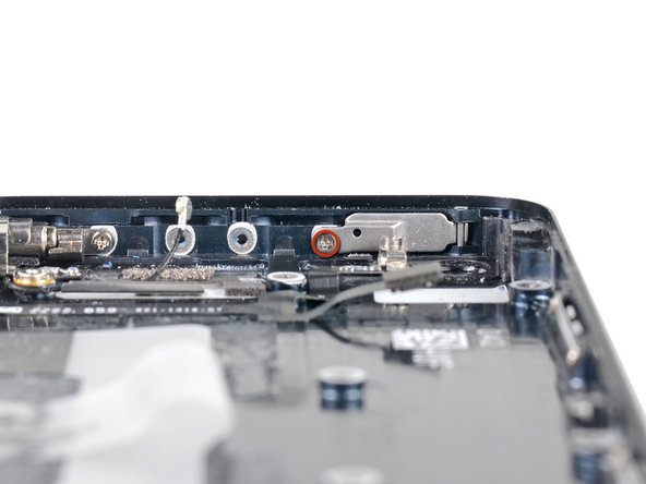

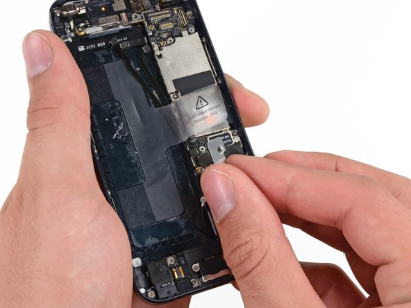

  20. iPhone 5 Power Button Replacement, Logic Board Assembly: step 20, image 1 of 1

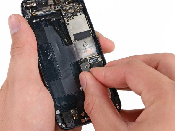

    • Use the tip of a spudger to pry the cellular data antenna cable connector up from its socket on the logic board, just above the speaker enclosure.
  21. iPhone 5 Power Button Replacement: step 21, image 1 of 1
    • Remove the following two screws securing the top logic board bracket to the rear case:
    • One 1.5 mm Phillips screw
    • One 2.3 mm Phillips screw

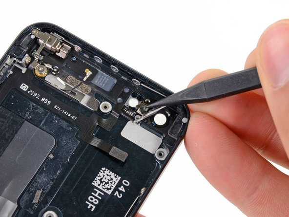

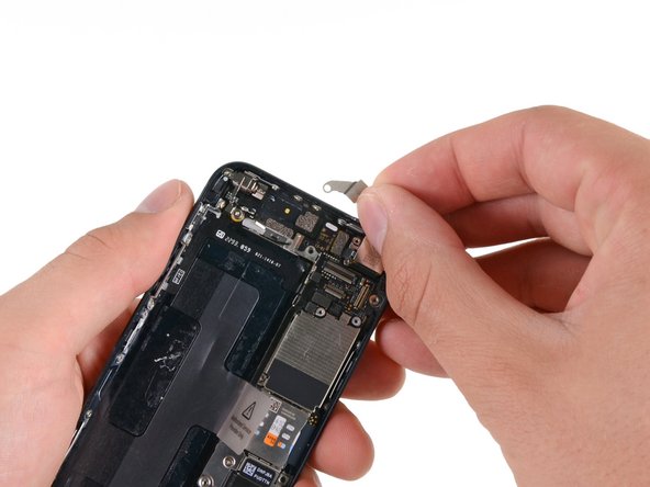

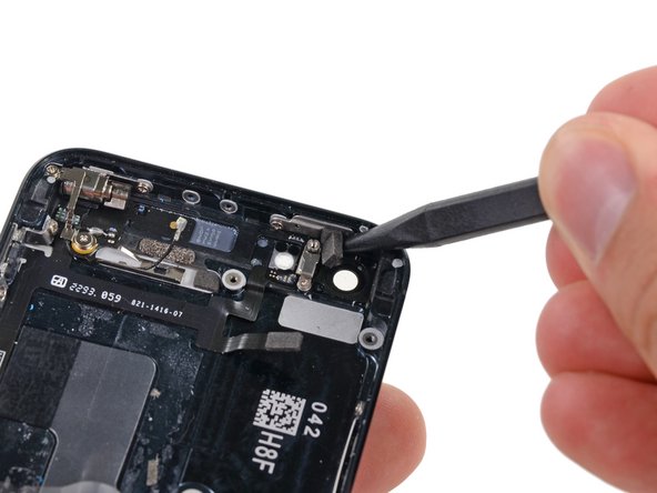

  22. iPhone 5 Power Button Replacement: step 22, image 1 of 2 iPhone 5 Power Button Replacement: step 22, image 2 of 2
    • Remove the bracket from the top of the logic board.
    • Be sure not to break off the tiny grounding tab that sticks up off of the bracket next to the rear facing camera.
    • On newer models, the bracket may be attached to the camera housing and will not come completely out.

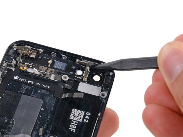

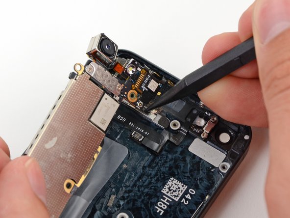

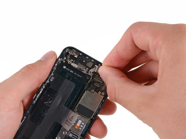

  23. iPhone 5 Power Button Replacement: step 23, image 1 of 3 iPhone 5 Power Button Replacement: step 23, image 2 of 3 iPhone 5 Power Button Replacement: step 23, image 3 of 3
    • Use the flat end of a spudger to disconnect the following three cables from the logic board:
    • Upper interconnect cable
    • Button assembly cable
    • Lower interconnect cable

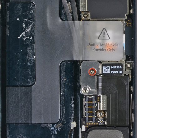

  29. iPhone 5 Power Button Replacement: step 29, image 1 of 1
    Tool used on this step:
    Standoff Screwdriver for iPhones
    $5.49
    Buy
    • Remove the following screws securing the logic board to the rear case:
    • Two 2.3 mm Phillips screws
    • Two 2.7 mm standoff screws
    • Standoff screws are best removed using a standoff screwdriver or bit.
    • In a pinch, a small flathead screwdriver will do the job—but use extra caution to ensure it doesn't slip and damage surrounding components.
    • One non-magnetic 2.7 mm standoff screw
    • Be sure to put this screw back in its original position at the top of the logic board. A magnetized screw may interfere with the digital compass.

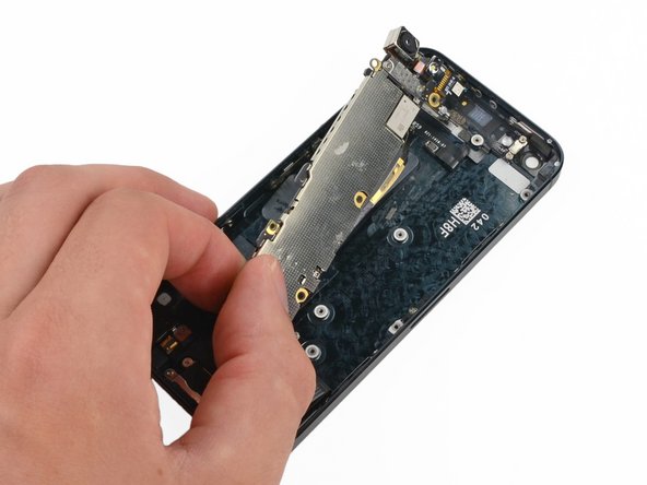

  30. iPhone 5 Power Button Replacement: step 30, image 1 of 3 iPhone 5 Power Button Replacement: step 30, image 2 of 3 iPhone 5 Power Button Replacement: step 30, image 3 of 3
    • Rotate the logic board assembly toward the battery side of the rear case.
    • Do not attempt to completely remove the logic board assembly from the rear case, yet; there is still one cable connected to the underside of the logic board.
    • The flash surround is adhered to the flash unit and the rear case. If it stays on the rear case remove with tweezers and mount it back on the flash unit.

    • Use the tip of a spudger to pry the Wi-Fi antenna cable connector up from its socket on the underside of the logic board.

    • Remove the logic board assembly from the rear case.
    • While your logic board is out of your phone, keep it on a grounded anti-static mat to prevent any damage to the circuitry.

    • Use the tip of a spudger to remove the rubber bumper from below the power button.
  34. iPhone 5 Power Button Replacement: step 34, image 1 of 2 iPhone 5 Power Button Replacement: step 34, image 2 of 2
    $5.49
    Buy
    • Remove the following screws from the metal bracket between the rear facing flash and camera windows:
    • One 2.9 mm standoff screw
    • Standoff screws are best removed with a standoff screwdriver or standoff driver bit. A small flathead screwdriver can also do the job—but use extra caution to ensure it doesn't slip and damage surrounding components.
    • One 1.6 mm Phillips screw
    • One 1.9 mm Phillips screw
  35. iPhone 5 Power Button Replacement: step 35, image 1 of 1
    • Remove the metal bracket between the rear facing flash and camera windows.
  36. iPhone 5 Power Button Replacement: step 36, image 1 of 2 iPhone 5 Power Button Replacement: step 36, image 2 of 2
    • Use the tip of a spudger to flip the metal bracket holding the power switch away from the top of the rear case.
  37. iPhone 5 Power Button Replacement: step 37, image 1 of 3 iPhone 5 Power Button Replacement: step 37, image 2 of 3 iPhone 5 Power Button Replacement: step 37, image 3 of 3
    • Press the power button into the rear case from the outside of the phone with the tip of a spudger.
    • Remove the power button.
    • When installing the power button, make sure the hinged metal loop on the back is flipped up, as shown—not down.
