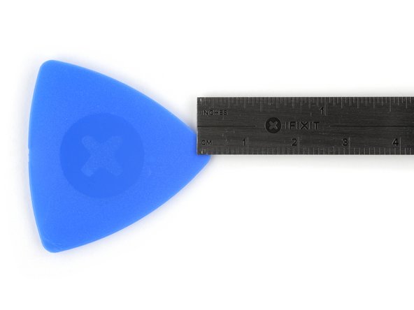

    2. Google Pixel 8 Back Cover Replacement, Mark your opening picks: step 2, image 1 of 3 Google Pixel 8 Back Cover Replacement, Mark your opening picks: step 2, image 2 of 3 Google Pixel 8 Back Cover Replacement, Mark your opening picks: step 2, image 3 of 3
      • You'll be using opening picks to separate the screen from the frame. If inserted too far, a pick can damage your device. Follow this step to mark your pick and prevent damage.
      • Measure 3 mm from the tip and mark the opening pick with a permanent marker.
      • Alternatively, tape a coin to a pick 3 mm from the tip.

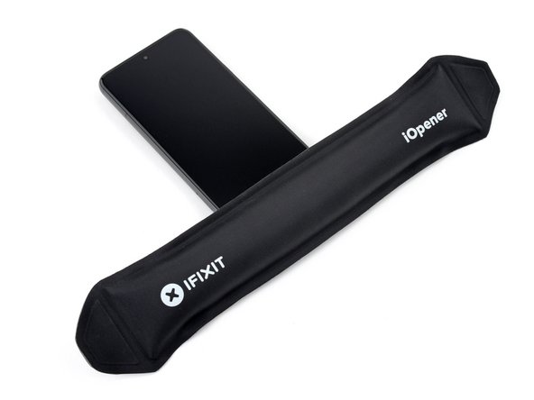

    3. Google Pixel 8 Back Cover Replacement, Heat the bottom edge adhesive: step 3, image 1 of 1
      • Adhesive and clips secure the screen to the frame. Heating the screen softens the adhesive, making it easier to separate.
      • Heat an iOpener and lay it on the bottom edge of the screen for two minutes to soften the adhesive.
      • Alternatively, you can use a hair dryer, heat gun, or hot plate—but be careful as extreme heat can damage the screen and/or battery.

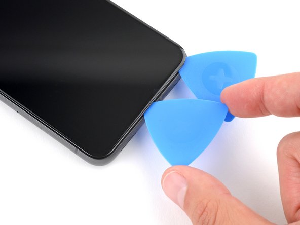

    10. Google Pixel 8 Back Cover Replacement, Separate the bottom edge adhesive: step 10, image 1 of 3 Google Pixel 8 Back Cover Replacement, Separate the bottom edge adhesive: step 10, image 2 of 3 Google Pixel 8 Back Cover Replacement, Separate the bottom edge adhesive: step 10, image 3 of 3
      • Slide the opening pick along the bottom edge to separate the adhesive securing it.
      • Leave the pick in the bottom right corner to prevent the adhesive from resealing.

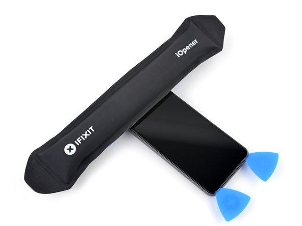

    11. Google Pixel 8 Back Cover Replacement, Heat the right edge adhesive: step 11, image 1 of 1
      • Apply a heated iOpener to the right edge of the screen for two minutes.

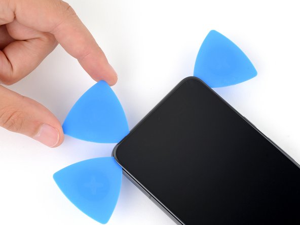

    13. Google Pixel 8 Back Cover Replacement, Leave a pick in the bottom left corner: step 13, image 1 of 3 Google Pixel 8 Back Cover Replacement, Leave a pick in the bottom left corner: step 13, image 2 of 3 Google Pixel 8 Back Cover Replacement, Leave a pick in the bottom left corner: step 13, image 3 of 3
      • Insert a third opening pick under the bottom edge of the screen.
      • Slide the new pick to the bottom left corner.
      • Leave the pick in the bottom left corner to prevent the adhesive from resealing.
