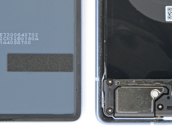

    6. Google Pixel 7a Loudspeaker Replacement, Adhesive information: step 8, image 1 of 2 Google Pixel 7a Loudspeaker Replacement, Adhesive information: step 8, image 2 of 2
      • The rear cover is secured with adhesive around the perimeter of the frame and near the cameras. Use this picture as a reference while you slice the adhesive.

    19. Google Pixel 7a Loudspeaker Replacement, Remove the rear cover: step 21, image 1 of 2 Google Pixel 7a Loudspeaker Replacement, Remove the rear cover: step 21, image 2 of 2
      • Remove the rear cover.

    12. Google Pixel 7a Loudspeaker Replacement, Replace the thermal pad: step 50, image 1 of 2 Google Pixel 7a Loudspeaker Replacement, Replace the thermal pad: step 50, image 2 of 2
      • During reassembly:
      • If you're reusing your logic board and the thermal pad is damaged, remove the old thermal pad, clean the surface, and apply a new one.
      • If you have a new logic board and it doesn't come with a thermal pad pre-installed, apply the new thermal pad now.
