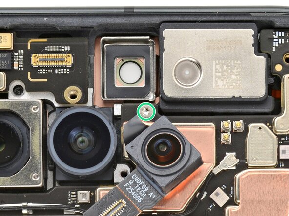

    1. Google Pixel 10a Loudspeaker Replacement, Disconnect the front camera: step 16, image 1 of 3 Google Pixel 10a Loudspeaker Replacement, Disconnect the front camera: step 16, image 2 of 3 Google Pixel 10a Loudspeaker Replacement, Disconnect the front camera: step 16, image 3 of 3
      • Insert the point of a spudger under the top-left corner of the front camera connector and pry up to disconnect it.
      • Flip the camera module out of its recess and onto the logic board, making sure not to tear the copper foil.

    2. Google Pixel 10a Loudspeaker Replacement, Remove the logic board screws: step 17, image 1 of 2 Google Pixel 10a Loudspeaker Replacement, Remove the logic board screws: step 17, image 2 of 2
      • Use a Torx Plus 3IP screwdriver to remove the two 2.9 mm‑long screws securing the logic board:
      • One at the top near the front camera
      • One near the bottom-right corner
      Ask FixBot

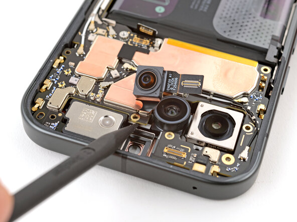

    3. Google Pixel 10a Loudspeaker Replacement, Remove the logic board: step 18, image 1 of 2 Google Pixel 10a Loudspeaker Replacement, Remove the logic board: step 18, image 2 of 2
      • Insert the point of a spudger under the logic board near the front camera and pry up to loosen the board.
      Ask FixBot

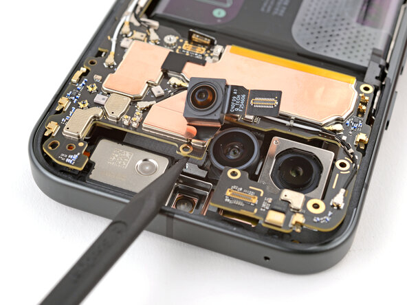

    4. Google Pixel 10a Loudspeaker Replacement: step 19, image 1 of 2 Google Pixel 10a Loudspeaker Replacement: step 19, image 2 of 2
      • Make sure you've ejected the SIM card tray.
      • Insert the point of a spudger in the notch at the bottom-right corner of the logic board and pry up to loosen the board.
      Ask FixBot

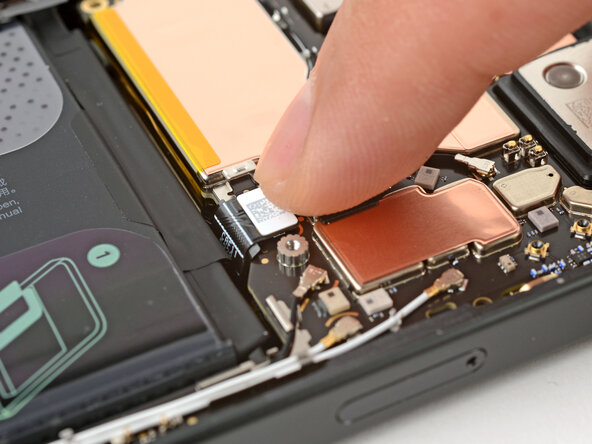

    5. Google Pixel 10a Loudspeaker Replacement: step 20, image 1 of 1
      • Bend the battery connector away from the logic board so it won't catch when you remove the board.
      Ask FixBot
    6. Google Pixel 10a Loudspeaker Replacement: step 21, image 1 of 2 Google Pixel 10a Loudspeaker Replacement: step 21, image 2 of 2
      • Use your fingers to carefully lift and remove the logic board.
      Ask FixBot

    1. Google Pixel 10a Loudspeaker Replacement, Connect the battery: step 32, image 1 of 2 Google Pixel 10a Loudspeaker Replacement, Connect the battery: step 32, image 2 of 2
      • Use your finger to align and press the battery press connector over its socket.
      • Don't try to force the connector into place. If you're having trouble, reposition it and try again.
      Ask FixBot
