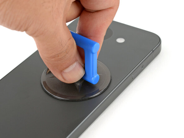

    2. Google Pixel 10a Battery Replacement, Create an opening gap: step 3, image 1 of 2 Google Pixel 10a Battery Replacement, Create an opening gap: step 3, image 2 of 2
      • Apply a suction handle near the center of the rear cover's right edge, as close to the edge as possible.
      Ask FixBot

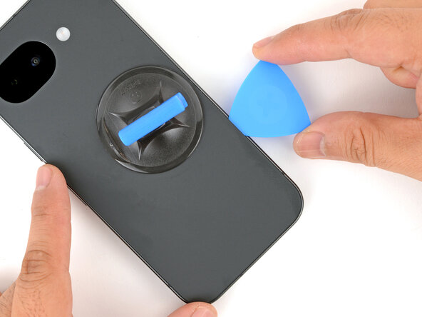

    3. Google Pixel 10a Battery Replacement: step 4, image 1 of 3 Google Pixel 10a Battery Replacement: step 4, image 2 of 3 Google Pixel 10a Battery Replacement: step 4, image 3 of 3
      • Pull up on the suction handle with strong, steady force until a gap forms between the cover and frame.
      • If you're having trouble, reheat the edge and try again.
      • Insert the tip of an opening pick into the gap.

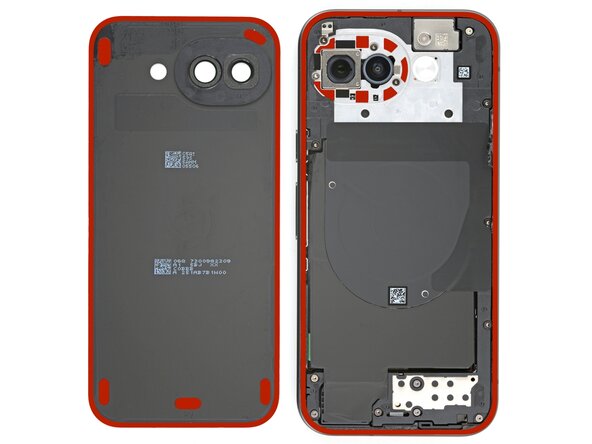

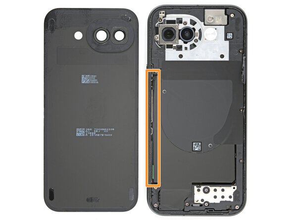

    4. Google Pixel 10a Battery Replacement, Adhesive information: step 5, image 1 of 2 Google Pixel 10a Battery Replacement, Adhesive information: step 5, image 2 of 2
      • The rear cover is secured with adhesive around the frame perimeter and near the cameras. Use this picture as a reference while you separate the adhesive.
      • When separating the left edge adhesive, don't insert your pick more than 3 mm to avoid damaging the wireless charging coil and its graphite film.
      Ask FixBot

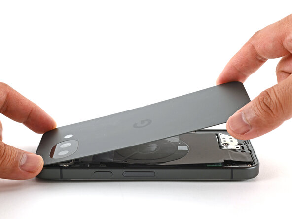

    5. Google Pixel 10a Battery Replacement, Separate the rear cover: step 6, image 1 of 3 Google Pixel 10a Battery Replacement, Separate the rear cover: step 6, image 2 of 3 Google Pixel 10a Battery Replacement, Separate the rear cover: step 6, image 3 of 3
      • Slide the opening pick around the entire perimeter to separate the adhesive.
      • If you're having trouble separating the adhesive, apply more heat and try again.
      Ask FixBot

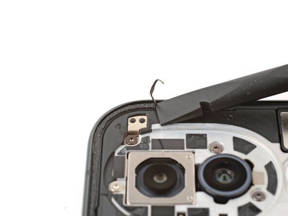

    6. Google Pixel 10a Battery Replacement: step 7, image 1 of 3 Google Pixel 10a Battery Replacement: step 7, image 2 of 3 Google Pixel 10a Battery Replacement: step 7, image 3 of 3
      • Insert the opening pick deeper near the top-left corner and pry to separate the adhesive around the camera bezel.
      Ask FixBot
    7. Google Pixel 10a Battery Replacement: step 8, image 1 of 2 Google Pixel 10a Battery Replacement: step 8, image 2 of 2
      • Slowly peel up and remove the rear cover.

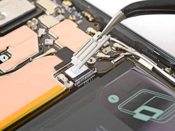

    1. Google Pixel 10a Battery Replacement, Remove the battery connector cover: step 12, image 1 of 1
      • Use a Torx Plus 3IP screwdriver to remove the 1.9 mm‑long screw securing the battery connector cover.
      Ask FixBot
    2. Google Pixel 10a Battery Replacement: step 13, image 1 of 2 Google Pixel 10a Battery Replacement: step 13, image 2 of 2
      • Remove the battery connector cover.
      Ask FixBot
    3. Google Pixel 10a Battery Replacement, Disconnect the battery: step 14, image 1 of 3 Google Pixel 10a Battery Replacement, Disconnect the battery: step 14, image 2 of 3 Google Pixel 10a Battery Replacement, Disconnect the battery: step 14, image 3 of 3
      • Insert the point of a spudger under the top-right corner of the battery connector.
      • Pry up to disconnect the battery.
      • Throughout the repair, pry only at the instructed area (also marked by a gold line on the circuit board) to prevent damage to the delicate components near the connector socket.

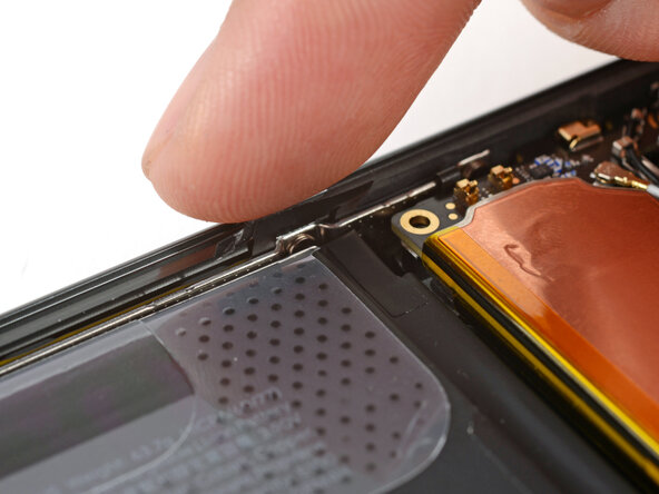

    1. Google Pixel 10a Battery Replacement, Move the side button cable: step 15, image 1 of 3 Google Pixel 10a Battery Replacement, Move the side button cable: step 15, image 2 of 3 Google Pixel 10a Battery Replacement, Move the side button cable: step 15, image 3 of 3
      • Use your fingernail or a spudger to peel up the left-side button cable and flip it over the side of your phone.
      • Be careful not to poke the battery.

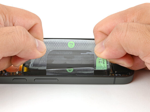

    2. Google Pixel 10a Battery Replacement, Peel the pull tabs: step 16, image 1 of 3 Google Pixel 10a Battery Replacement, Peel the pull tabs: step 16, image 2 of 3 Google Pixel 10a Battery Replacement, Peel the pull tabs: step 16, image 3 of 3
      • Use your fingers or an opening pick to peel up a corner of the battery pull tab labeled "2".
      • Grab the tab with your fingers and peel it off the top of the battery.
      • Peel the pull tab labeled "1" completely off the top of the battery.
      Ask FixBot
    3. Google Pixel 10a Battery Replacement, Separate the battery: step 17, image 1 of 2 Google Pixel 10a Battery Replacement, Separate the battery: step 17, image 2 of 2
      • With both hands, firmly grab the pull tab labeled "2" as close to the left edge as possible. Brace your hands against the rest of the phone frame.
      • Pull up with firm, steady force until the battery separates.
      • The battery adhesive is strong and may require multiple attempts before it separates.
      • If you can't loosen the battery, follow the next step for an alternate method.

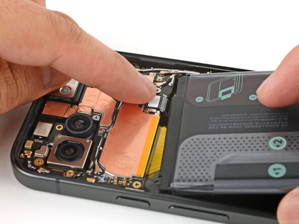

    5. Google Pixel 10a Battery Replacement, Remove the battery and liner: step 19, image 1 of 2 Google Pixel 10a Battery Replacement, Remove the battery and liner: step 19, image 2 of 2
      • Peel and remove the battery and its plastic liner from the phone.

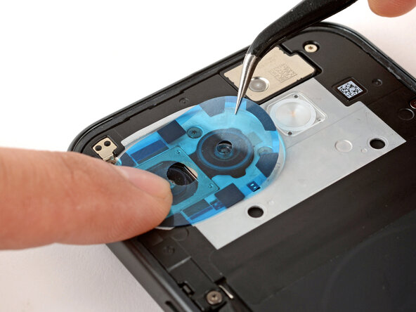

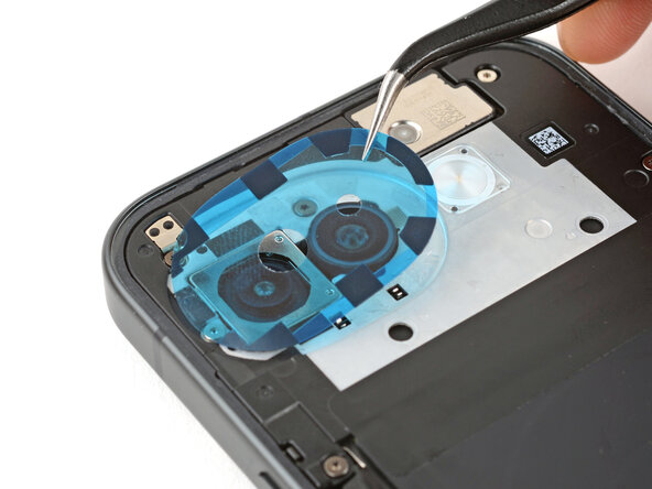

    2. Google Pixel 10a Battery Replacement, Replace the camera bezel adhesive: step 34, image 1 of 2 Google Pixel 10a Battery Replacement, Replace the camera bezel adhesive: step 34, image 2 of 2
      • Inspect the adhesive blocks surrounding the rear cameras. If they're clean and unwrinkled, you can reuse them and skip down three steps.
      • Use the point of a spudger to pry up and remove the seven adhesive blocks surrounding the rear cameras.
      Ask FixBot

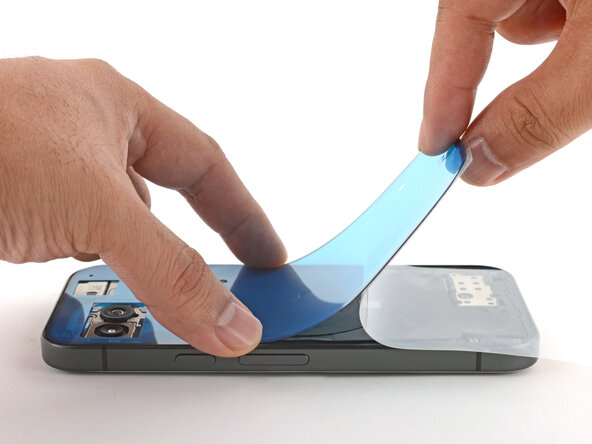

    3. Google Pixel 10a Battery Replacement: step 35, image 1 of 3 Google Pixel 10a Battery Replacement: step 35, image 2 of 3 Google Pixel 10a Battery Replacement: step 35, image 3 of 3
      • Peel the clear liner from the camera bezel adhesive.
      • Carefully align and lay the adhesive in place. Use the rear cameras to help with alignment.
      Ask FixBot

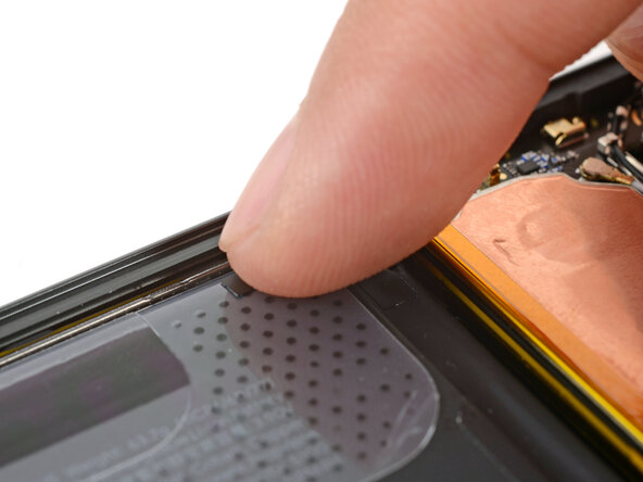

    4. Google Pixel 10a Battery Replacement: step 36, image 1 of 3 Google Pixel 10a Battery Replacement: step 36, image 2 of 3 Google Pixel 10a Battery Replacement: step 36, image 3 of 3
      • Use your fingers to press the camera bezel adhesive onto the frame.
      • Peel and remove the top blue liner from the adhesive.
      • There will still be a thin liner covering the adhesive.

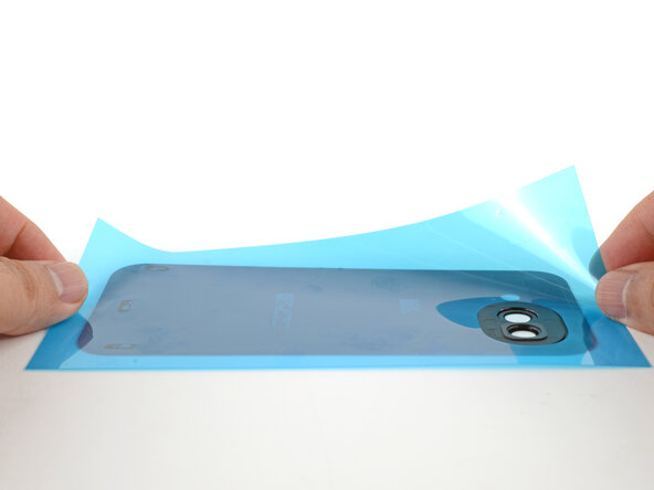

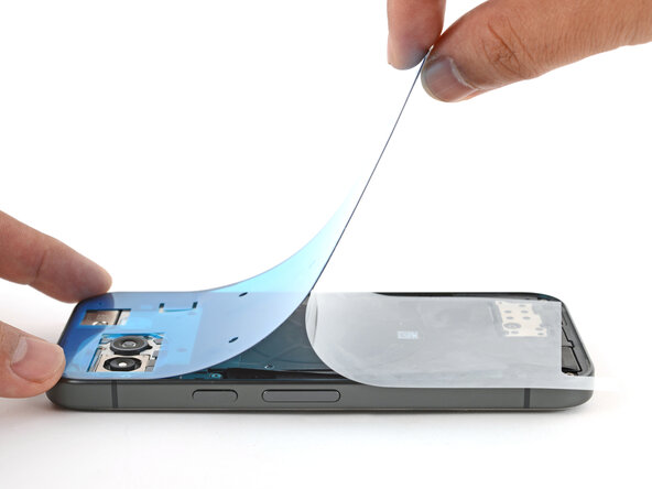

    7. Google Pixel 10a Battery Replacement, Install the rear cover adhesive: step 39, image 1 of 1
      • Without peeling any liners, hold the rear cover adhesive over the phone to figure out how it'll sit on the frame. Use the camera cutout to help with orientation.
      Ask FixBot
    8. Google Pixel 10a Battery Replacement: step 40, image 1 of 1
      • Peel down the top half of the clear liner to expose the adhesive—don't fully remove the liner yet.

    9. Google Pixel 10a Battery Replacement: step 41, image 1 of 3 Google Pixel 10a Battery Replacement: step 41, image 2 of 3 Google Pixel 10a Battery Replacement: step 41, image 3 of 3
      • Take your time aligning the adhesive to the frame. If you apply it incorrectly, you'll need to restart with new adhesive.
      • Align and lay the top edge of the adhesive onto the frame.
      • Press down along the top edge to secure the alignment.
      • Slowly peel away the clear liner as you press the rest of the adhesive in place.

    10. Google Pixel 10a Battery Replacement: step 42, image 1 of 2 Google Pixel 10a Battery Replacement: step 42, image 2 of 2
      • Use a spudger to press the adhesive onto the entire frame perimeter.

    11. Google Pixel 10a Battery Replacement: step 43, image 1 of 2 Google Pixel 10a Battery Replacement: step 43, image 2 of 2
      • Peel up and remove the large liner from the rear cover adhesive.

    12. Google Pixel 10a Battery Replacement: step 44, image 1 of 1
      • If you installed replacement camera bezel adhesive, remove all remaining liners from it.

    15. Google Pixel 10a Battery Replacement, Install the rear cover: step 47, image 1 of 3 Google Pixel 10a Battery Replacement, Install the rear cover: step 47, image 2 of 3 Google Pixel 10a Battery Replacement, Install the rear cover: step 47, image 3 of 3
      • Lay the rear cover over the frame.
      • Firmly press around the perimeter to secure the adhesive.
      • You can also hold your phone and squeeze firmly around the perimeter to strengthen the adhesive bond.
      • For an even more secure bond, lay your phone screen-down on a clean and flat surface underneath a few books overnight.
