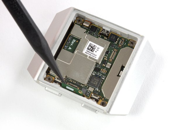

    3. Fitbit Ionic Battery Replacement: step 22, image 1 of 3 Fitbit Ionic Battery Replacement: step 22, image 2 of 3 Fitbit Ionic Battery Replacement: step 22, image 3 of 3
      • Insert a spudger into the gap between the watchcase and the upper edge of the motherboard.
      • Use the spudger to pry up the motherboard.
      • Avoid damaging the battery and heart rate sensor cables during the motherboard removal procedure.
      • Remove the motherboard.
      Ask FixBot
