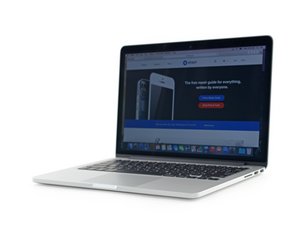

At their March 9 keynote, Apple sprung four new MacBooks on us. As always, we had to get our paws on the revised MacBook Pro.
On the outside, the MacBook Pro 13" Retina Display Early 2015 looks a lot like its older sibling; it includes the same Retina display and aluminum unibody construction. But with a newfangled Force Touch trackpad and Intel's latest Broadwell-U processors, this MacBook promises to be a whole new animal. Join us as we dive into the belly of this beast!

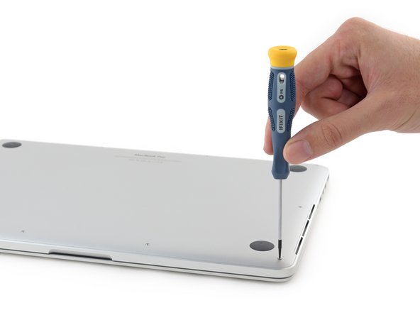

Image 1/2: Let's take a peek at the ports: Image 2/2: On the right side, this MacBook is equipped with an SDXC card slot, HDMI port, and a USB 3 port.

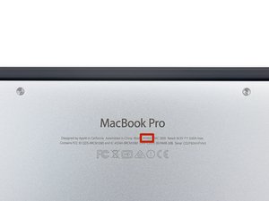

  • A quick look at the bottom panel reveals no surprises—this machine shares the A1502 designation with the late 2013 Macbook Pro.
  • Let's take a peek at the ports:
    • On the right side, this MacBook is equipped with an SDXC card slot, HDMI port, and a USB 3 port.
    • To the left (to the left), we have a MagSafe 2 port, two Thunderbolt 2 ports, another USB 3.0 port, a headphone jack, and dual microphones (plus everything we own, in a box).

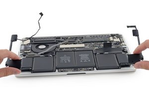

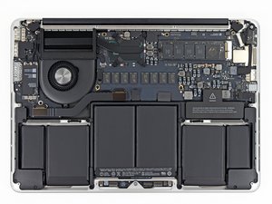

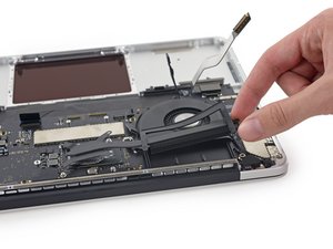

Image 1/3: It looks like this MacBook Pro inherited the single fan gene from its [guide|18695|predecessor|stepid=53214|new_window=true]... among other things. Image 2/3: Actually, the only immediate difference we note is the trackpad cable, newly slung over the top of the battery. Other than that, it's very similar to the Late 2013 version (last image). Image 3/3: We'll have to cut a bit deeper to get to the good stuff.
  • Let the reveal commence. Drumroll, please!
  • It looks like this MacBook Pro inherited the single fan gene from its predecessor... among other things.
  • Actually, the only immediate difference we note is the trackpad cable, newly slung over the top of the battery. Other than that, it's very similar to the Late 2013 version (last image).
  • We'll have to cut a bit deeper to get to the good stuff.

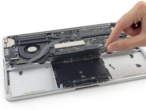

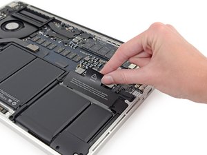

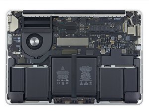

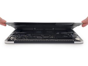

Image 1/3: Okay, maybe just relocated... But spoilers! We're not removing the battery just yet. Image 2/3: The mystery of the Force Touch trackpad unfolds layer by layer as we first remove its cable. Image 3/3: Apple leaves us with [http://www.apple.com/macbook-pro/features-retina#force-click/|enticing instructions|new_window=true] for this trackpad: "Press a little deeper, do a lot more." Okay, Apple, [https://www.youtube.com/watch?v=QKzxsFixwq4|if you insist!]
  • Is Apple actually beckoning us in? The warning text on the battery that we've seen in the MacBook Pro 13" Retina Display Late 2013 Teardown (center) has disappeared. Well then, let's dig in!
    • Okay, maybe just relocated... But spoilers! We're not removing the battery just yet.
  • The mystery of the Force Touch trackpad unfolds layer by layer as we first remove its cable.
  • Apple leaves us with enticing instructions for this trackpad: "Press a little deeper, do a lot more." Okay, Apple, if you insist!

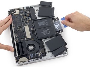

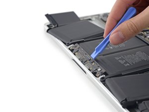

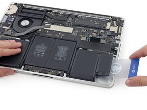

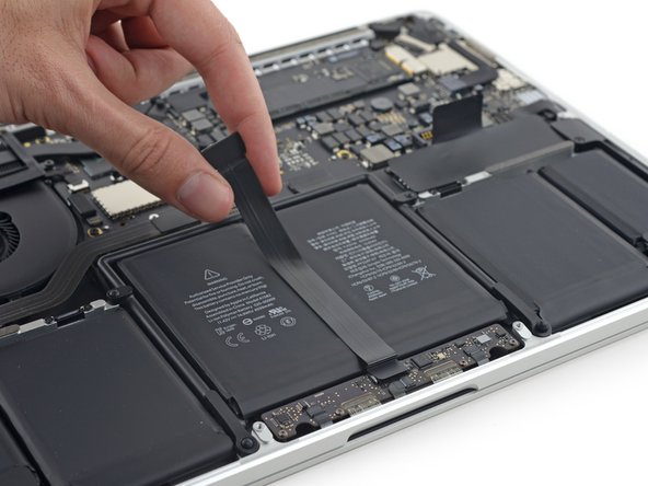

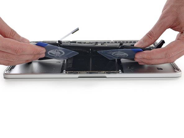

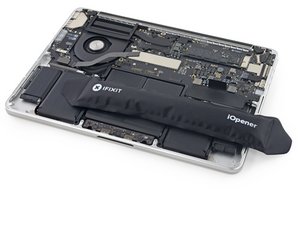

Image 1/2: Where once there were four screws holding the battery frame in place (perhaps superfluously, with all of the adhesive used), there are now four rubber stoppers. Image 2/2: The previous gen's adhesive seemed plenty strong—so, is Apple poofing away these screws because they weren't ever needed, or because they aren't needed ''now''? Perhaps a  ''stronger'' adhesive made these screws unnecessary? We shudder at the thought.
  • Operation: Battery Extraction is underway! Since we've seen retinas before, we've got a bit of an eye-dea how to proceed, but you aren't going to hear it since the speakers are out next.
  • Where once there were four screws holding the battery frame in place (perhaps superfluously, with all of the adhesive used), there are now four rubber stoppers.
    • The previous gen's adhesive seemed plenty strong—so, is Apple poofing away these screws because they weren't ever needed, or because they aren't needed now? Perhaps a stronger adhesive made these screws unnecessary? We shudder at the thought.
  • If it's a battle you want, Apple, it's a battle you'll get. As the old Klingon proverb says, today is a good day to die trying to unseat a battery.
  • Armed with our trusted tools, iOpener and plastic card, we begin heating and prying the battery, taking care not to puncture anything with "potential for fire or burning."

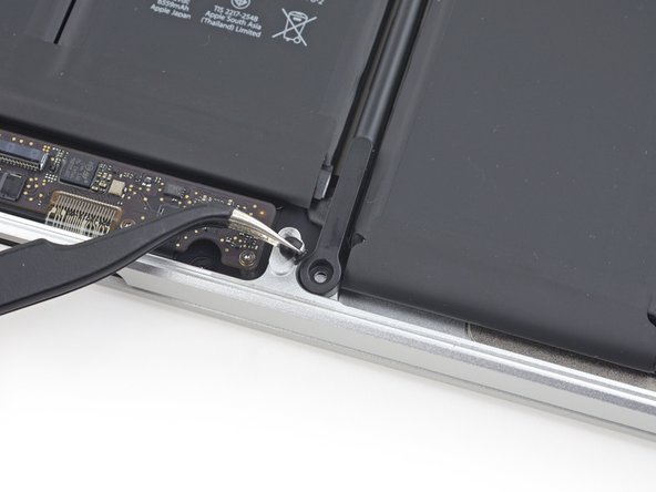

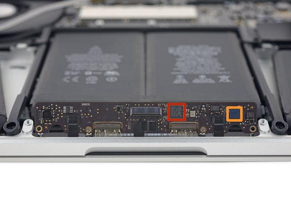

Image 1/2: Apple decided to solder the largest cables onto the trackpad board, meaning we'll have to just flip it out of the way for now. [http://i.ytimg.com/vi/S-dbAUr6I7E/hqdefault.jpg|Y U NO ZIF|new_window=true], Apple? Image 2/2: The new trackpad board has some interesting ICs:
  • These components are putting up an orchestrated effort to avoid our eyes. We use our plastic opening tool to nudge the trackpad control board out of our way, but not remove it...
  • Apple decided to solder the largest cables onto the trackpad board, meaning we'll have to just flip it out of the way for now. Y U NO ZIF, Apple?
  • The new trackpad board has some interesting ICs:
    • ST Microelectronics 32F103 ARM Cortex-M based microcontroller
    • Broadcom BCM5976 touch screen controller
Image 1/3: We know Apple can do better, since [guide|38268|we've seen it|stepid=86839|new_window=true], like, [guide|38266|yesterday|stepid=86815|new_window=true]. Image 2/3: The central cells seem tougher to remove than in in years gone by. Maybe we're just weaker. Image 3/3: Peeling back the battery reveals... gunk. Either Apple doesn't think you need to replace this battery, or someone accidentally dipped it in [https://www.youtube.com/watch?v=JO1dtHJF5bc&t=33|tar|new_window=true].

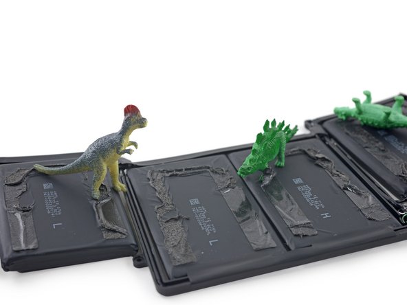

  • Arrrgh. We begin the arduous process of carding this underaged battery for substance abuse. In our view, adhesive should be a controlled substance, and only used responsibly.
  • The central cells seem tougher to remove than in in years gone by. Maybe we're just weaker.
  • Peeling back the battery reveals... gunk. Either Apple doesn't think you need to replace this battery, or someone accidentally dipped it in tar.

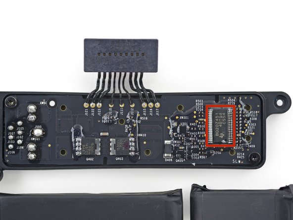

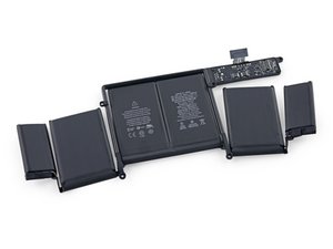

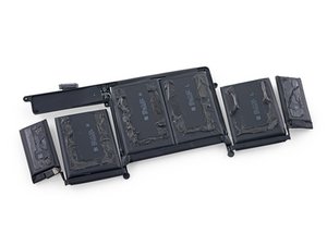

Image 1/3: Apple claims that this new 11.42 V, 74.9 Whr battery provides up to 10 hours of web browsing and up to 12 hours of video playback. Image 2/3: For the [guide|18695|Late 2013|stepid=53238|new_window=true] model, we got 71.8 Whr—so we're up a whole 4% capacity, for an extra 11% runtime. We're gonna chalk the rest of the boost up to the Broadwell architecture's efficiency gains. Image 3/3: The [guide|36157|Dell XPS 13|stepid=80995], however, manages an HD screen and an (alleged) 11 hours of run time on a 52 Wh battery.
  • We performed a battery of procedures in order to remove this 74.9-watt-hour array of lithium-polymer cells.
  • Apple claims that this new 11.42 V, 74.9 Whr battery provides up to 10 hours of web browsing and up to 12 hours of video playback.
    • For the Late 2013 model, we got 71.8 Whr—so we're up a whole 4% capacity, for an extra 11% runtime. We're gonna chalk the rest of the boost up to the Broadwell architecture's efficiency gains.
    • The Dell XPS 13, however, manages an HD screen and an (alleged) 11 hours of run time on a 52 Wh battery.
  • This familiar Retina denizen, the Texas Instruments BQ20Z451 Gas Gauge IC, measures battery life.
    • This IC should be similar to the older BQ20Z45, or its replacement, the BQ20Z45-R1.

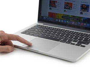

Image 1/3: Thusfar, Gus is unimpressed. (Maybe he's not pressing hard enough?) Image 2/3: You can't judge a trackpad by its cover, so we remove the 10 screws securing it. Image 3/3: We're ''trying'' not to judge it; at least it's not [guide|27413|adhesive|stepid=67190]. But the sight of 10 ''more'' screws in the trackpad underneath the cover makes us groan. Just how much force is in this trackpad?
  • Here it is, folks—the all-new Force Touch trackpad. To put it to the test, we bring in our littlest employee, Gus the Ewok Cavapoo, to investigate.
    • Thusfar, Gus is unimpressed. (Maybe he's not pressing hard enough?)
  • You can't judge a trackpad by its cover, so we remove the 10 screws securing it.
    • We're trying not to judge it; at least it's not adhesive. But the sight of 10 more screws in the trackpad underneath the cover makes us groan. Just how much force is in this trackpad?

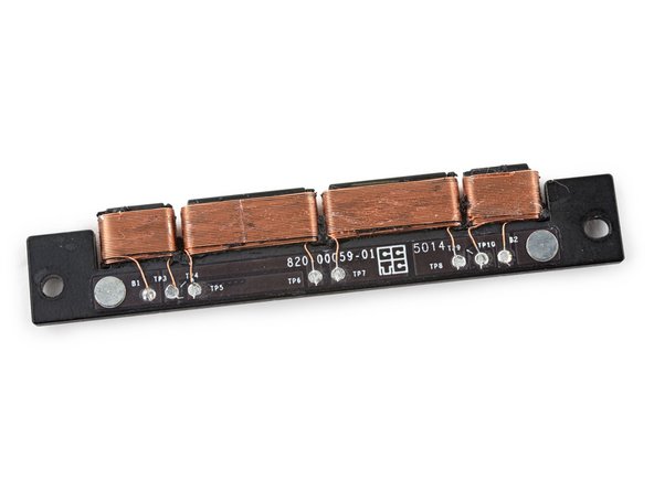

  • Let's take a gander under the hood of the Taptic Engine, shall we?
  • The rubber we hoped to simply cut open needed to be cut away chunk by chunk.
  • Finally, the coils are free! Well, bare at least.
  • Force Touch looks to be a clever application of a technology that dates back a ways—the year 1824, to be exact.
    • Made of wire coils surrounding a ferromagnetic core, the electromagnet in the Force Touch Trackpad is used to create the vibrational feedback you feel.
  • We're guessing that the four separate coils here are used to vary the feedback given to the user. Turning different sets of the four coils on and off varies the strength and direction of the vibration, and how it feels to your finger.

  • Let's continue unraveling the secrets of the trackpad, starting with the coils—we were hoping to find some evidence of linear oscillators in the taptic engine, but it looks like it's just a series of electromagnets.
  • The magnets rapidly push and pull against a metal rail mounted beneath the trackpad, to create a tiny "buzz" of feedback with each click (and a second buzz for a "force click").
  • So that explains the buzzing, but what about the sensing?

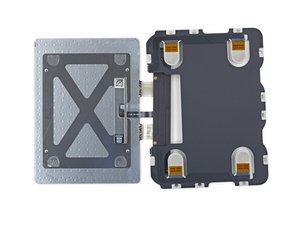

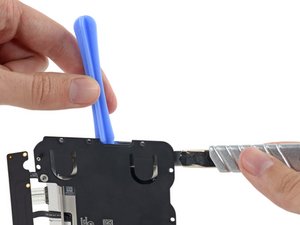

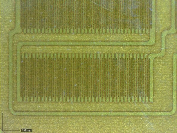

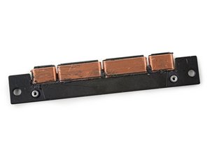

Image 1/3: With the pad splayed open, we get our first look at the pressure sensors. Image 2/3: And popping the sensor bracket under a microscope, we get a second, closer look. Image 3/3: Based on the wiggly pattern of traces stuck to the metal tabs, we're pretty sure the magic pressure sensors in the new Force Touch trackpad are tiny [http://en.wikipedia.org/wiki/Strain_gauge|strain gauges|new_window=true]. Mounted on flexing metal supports, they detect the amount of flex on each—and based on that, the force from above.
  • Removing the trackpad from the bracket requires slicing through four pads of glue.
  • With the pad splayed open, we get our first look at the pressure sensors.
    • And popping the sensor bracket under a microscope, we get a second, closer look.
  • Based on the wiggly pattern of traces stuck to the metal tabs, we're pretty sure the magic pressure sensors in the new Force Touch trackpad are tiny strain gauges. Mounted on flexing metal supports, they detect the amount of flex on each—and based on that, the force from above.
  • This works in conjunction with the traditional capacitive touchpad up top, to pinpoint where you're applying force.

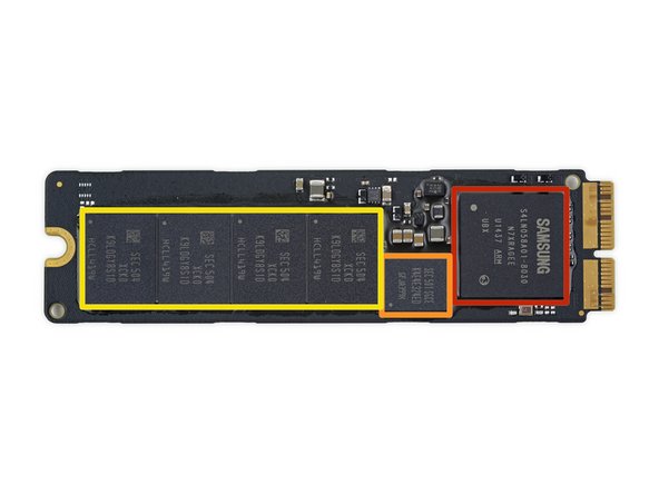

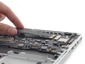

Image 1/3: Samsung S4LN058A01 PCIe 3.0 x4 AHCI flash controller Image 2/3: Samsung [http://intelatech.com/Samsung_PSG_2013_2H.pdf|K4E4E324ED|new_window=true] 512 MB LPDDR3 DRAM Image 3/3: 8 x Samsung [http://www.samsung.com/global/business/semiconductor/html/common/file/support/part_number_decoder/Nand_Flash.pdf|K9LDGY8S1D-XCK0|new_window=true] 16 GB flash storage (128 GB total)
  • This looks familiar... The all-new and twice-as-fast flash memory has the exact same ICs as the one found in our recent teardown of the MacBook Air 13":
    • Samsung S4LN058A01 PCIe 3.0 x4 AHCI flash controller
    • Samsung K4E4E324ED 512 MB LPDDR3 DRAM
    • 8 x Samsung K9LDGY8S1D-XCK0 16 GB flash storage (128 GB total)
  • Just like its MacBook Air brother, this SSD benchmarks at significantly faster speeds than the previous generation.

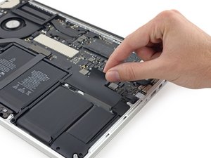

So will I be able to order their proprietary SSD from Apple and then be able to upgrade? Will they (Apple) do the upgrade for a charge (albeit a very steep charge)? Say 128 to 512? Surely third parties will as well once warranty goes out on the model..
chrisdublynn - Reply
I would wait at the moment. There is one website that sell the SSD but at a ludicrous price. You can check eBay for the drive, but make sure it's for your apple macbook pro.
Mit Amin -

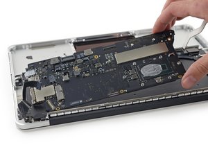

Image 1/2: Not to worry—we've got this under control. Apart from that metastasizing blob of thermal paste, this looks like our old friend from teardowns of yore: same form factor, same removal procedure. Image 2/2: Not to worry—we've got this under control. Apart from that metastasizing blob of thermal paste, this looks like our old friend from teardowns of yore: same form factor, same removal procedure.
  • This MacBook loses its cool, and moments later the logic board flips out.
  • Not to worry—we've got this under control. Apart from that metastasizing blob of thermal paste, this looks like our old friend from teardowns of yore: same form factor, same removal procedure.
Why is the thermal pipe not touching the GPU die?
Jack - Reply
The thermal pipe contact surface does cover the combined CPU+GPU die completely, so no problem there (though it looks like there's an awful lot of thermal paste on iFixits device...).
The part I think you're looking at (clean with no thermal paste and too far from the thermal pipe contact surface to be covered by it) is the PCH die, which apparently doesn't put off enough heat to matter.
Speculating, if they HAD extended the thermal pipe contact surface to the PCH, it would almost certainly have transferred some of the heat coming off the CPU+GPU die over to the PCH, which in addition to being counterproductive, might be something the PCH can't handle :)
Steve -

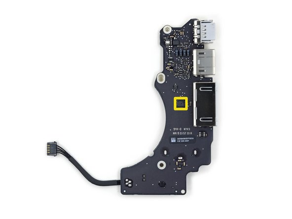

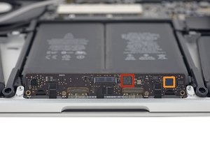

Image 1/3: Parade Technology [http://www.paradetech.com/products/jitter-cleaning-repeaters/ps8401/|PS8401A|new_window=true] HDMI Jitter Cleaning Repeater Image 2/3: Genesys Logic GL3219 SDXC Card Reader Controller Image 3/3: NXP Semiconductors [http://www.nxp.com/documents/data_sheet/PCA9501.pdf|PCA9501|new_window=true] 8-bit I/O Expander with an On-Board 2-kbit EEPROM

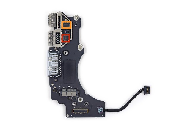

  • The I/O board looks unchanged, but what about the onboard chips? Looks like some of them have swapped sides:
    • Parade Technology PS8401A HDMI Jitter Cleaning Repeater
    • Genesys Logic GL3219 SDXC Card Reader Controller
    • NXP Semiconductors PCA9501 8-bit I/O Expander with an On-Board 2-kbit EEPROM

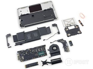

Image 1/2: Proprietary pentalobe screws continue to make opening the device unnecessarily difficult. Image 2/2: The battery assembly is entirely, and very solidly, glued into the case, thus complicating replacement. Additionally, the battery covers the screws holding the trackpad in place, meaning it's impossible to replace the trackpad without first removing the battery.
  • MacBook Pro with Retina Display 13" Early 2015 Repairability Score: 1 out of 10 (10 is easiest to repair)
  • Proprietary pentalobe screws continue to make opening the device unnecessarily difficult.
  • The battery assembly is entirely, and very solidly, glued into the case, thus complicating replacement. Additionally, the battery covers the screws holding the trackpad in place, meaning it's impossible to replace the trackpad without first removing the battery.
  • The Retina display is a fused unit with no separate, protective glass. If anything ever fails inside the display, the entire ($$$) assembly will need to be replaced.
  • The RAM is soldered to the logic board. Pay for the upgrade now, or be stuck with 8 GB forever. There is no chance of upgrade.
  • The proprietary PCIe SSD still isn't a standard drive. Cross your fingers for future compatible drives; for now, you're stuck with what you've got.

How are the SSDs propriotery? They are just a M.2 SSD available in most places! The Samsung ones are just harder to get.
theodorlas - Reply
They appear to be M.2 but they aren't. If you look closely to the connector you can spot some differences.
Andre Fonseca -
It's the same as in the old Macbook Retina. A Proprietary connector, it's a modified SATA3 connector. Every macbook aberration has even its own form factor. So upgradability will be not possible that easy.
ydar -

I'd like a comparison with the old trackpad to see how it compares. Check overall volume,part volume, part location, height of system and parts, all weights... Maybe edge sealing around the pad...
The point being that I want to know how much does this actually gain or loose. That new Lenovo is about 15% lighter when compared to the new macbook so I'm curious where the weight is coming from.
fastm3driver - Reply

Does the Force Touch trackpad have the same connection and mounts as the old Macbook Pro trackpad? Thinking about retrofits here.
xcorlett - Reply

I really wish you guys had taken off the keyboard backing to show that it is now held in place by rivets, not screws. Wasted 3 hours getting it apart, realizing I couldn't replace the keyboard then putting it back together still broken. Not angry at iFixit. !#^&@@ off at Apple for this blatant disregard to repair-ability.
jerbil24 - Reply
