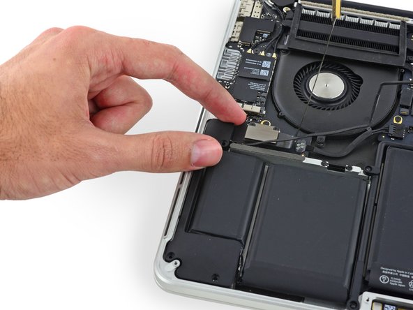

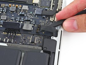

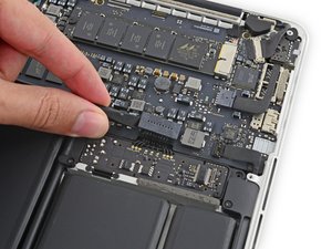

    1. MacBook Pro 13" Retina Display Mid 2014 Battery Replacement, Battery Connector: step 4, image 1 of 1
      • If necessary, remove the plastic cover adhered to the battery contact board.
      Ask FixBot

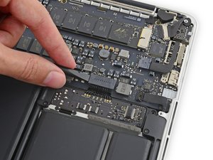

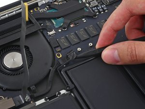

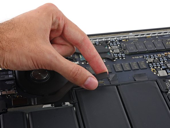

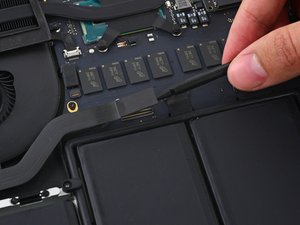

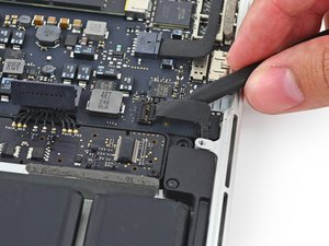

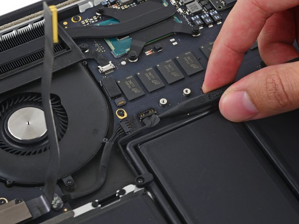

    2. MacBook Pro 13" Retina Display Mid 2014 Battery Replacement: step 5, image 1 of 2 MacBook Pro 13" Retina Display Mid 2014 Battery Replacement: step 5, image 2 of 2
      • Use the flat end of a spudger to lift the battery connector straight up out of its socket on the logic board.
      • Be sure you lift up only on the connector itself, not the socket, or you risk permanent damage to the logic board.
      Ask FixBot

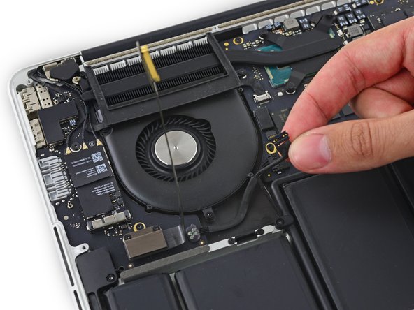

    3. MacBook Pro 13" Retina Display Mid 2014 Battery Replacement: step 6, image 1 of 1
      • Bend the battery connector up out of the way to prevent accidental contact with its socket during your repair.
      Ask FixBot

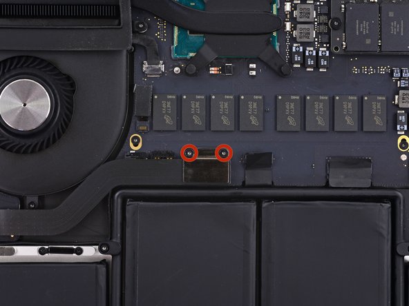

    1. MacBook Pro 13" Retina Display Mid 2014 Battery Replacement, Right Speaker: step 7, image 1 of 1
      • Remove the two 2.1 mm T5 Torx screws securing the logic board end of the I/O board cable bracket.
      Ask FixBot

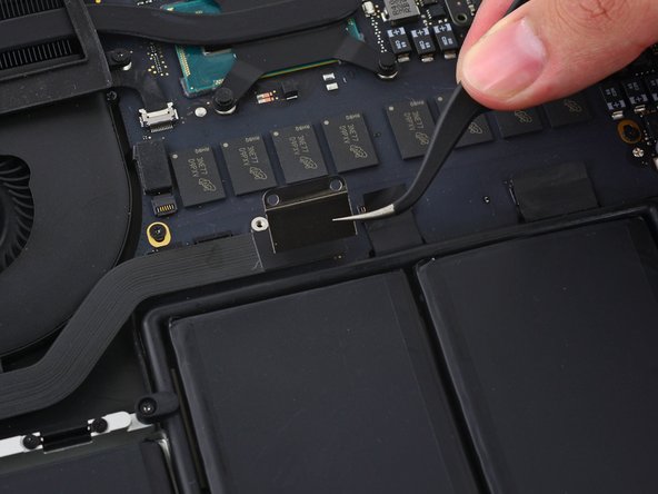

    2. MacBook Pro 13" Retina Display Mid 2014 Battery Replacement: step 8, image 1 of 1
      Tool used on this step:
      Buy
      • Grasp the I/O board cable bracket with a pair of tweezers and remove it from the MacBook.
      Ask FixBot

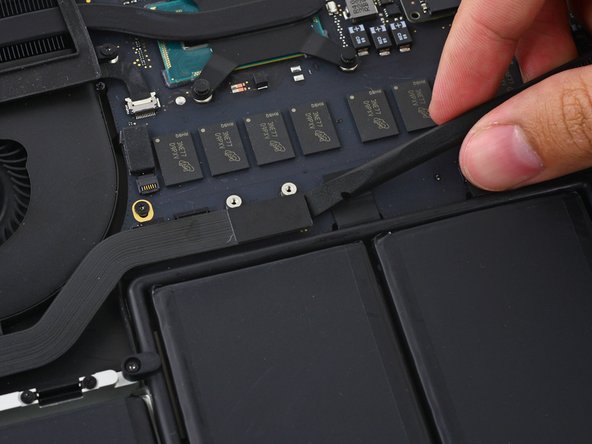

    3. MacBook Pro 13" Retina Display Mid 2014 Battery Replacement: step 9, image 1 of 2 MacBook Pro 13" Retina Display Mid 2014 Battery Replacement: step 9, image 2 of 2
      • Use the flat end of a spudger to pop the I/O board connector straight up off its socket on the logic board.
      • Be careful to only pry up on the I/O board cable, not on the socket itself or you risk damaging your logic board.
      Ask FixBot

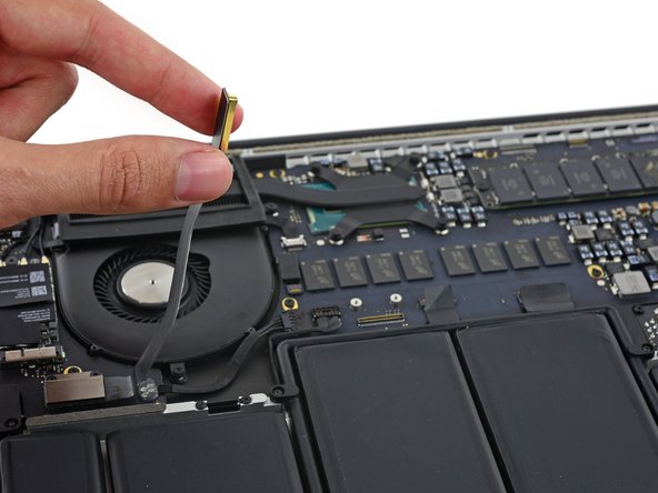

    4. MacBook Pro 13" Retina Display Mid 2014 Battery Replacement: step 10, image 1 of 2 MacBook Pro 13" Retina Display Mid 2014 Battery Replacement: step 10, image 2 of 2
      • Lift the logic board end of the I/O board cable straight up to bend it out of the way.
      • To avoid damage to the cable, fold only at the bend in the I/O board end of the cable.
      Ask FixBot

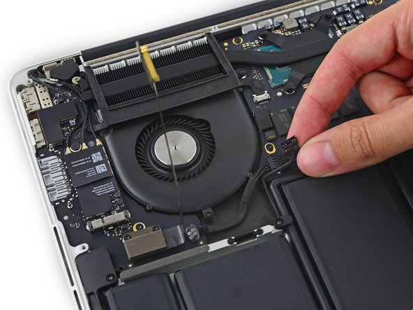

    5. MacBook Pro 13" Retina Display Mid 2014 Battery Replacement: step 11, image 1 of 2 MacBook Pro 13" Retina Display Mid 2014 Battery Replacement: step 11, image 2 of 2
      • Carefully tuck the tip of a spudger under the right speaker cable near the connector and lift it up out of its socket on the logic board.
      Ask FixBot

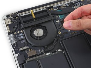

    6. MacBook Pro 13" Retina Display Mid 2014 Battery Replacement: step 12, image 1 of 3 MacBook Pro 13" Retina Display Mid 2014 Battery Replacement: step 12, image 2 of 3 MacBook Pro 13" Retina Display Mid 2014 Battery Replacement: step 12, image 3 of 3
      • Carefully peel the right speaker cable off the upper case.

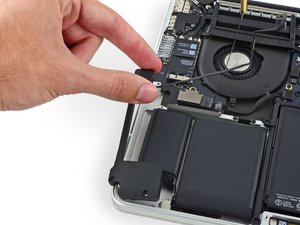

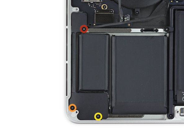

    8. MacBook Pro 13" Retina Display Mid 2014 Battery Replacement: step 14, image 1 of 3 MacBook Pro 13" Retina Display Mid 2014 Battery Replacement: step 14, image 2 of 3 MacBook Pro 13" Retina Display Mid 2014 Battery Replacement: step 14, image 3 of 3
      • Lift the right speaker from the cable end and pull it free from the case.
      Ask FixBot

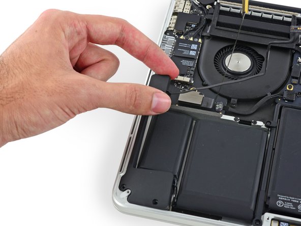

    1. MacBook Pro 13" Retina Display Mid 2014 Battery Replacement, Left Speaker: step 15, image 1 of 2 MacBook Pro 13" Retina Display Mid 2014 Battery Replacement, Left Speaker: step 15, image 2 of 2
      • Insert the tip of a spudger under the left speaker cable near the connector and lift it up out of its socket on the logic board.
      • Be careful not to damage any surface-mounted components.

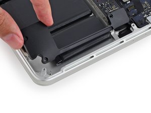

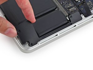

    3. MacBook Pro 13" Retina Display Mid 2014 Battery Replacement: step 17, image 1 of 3 MacBook Pro 13" Retina Display Mid 2014 Battery Replacement: step 17, image 2 of 3 MacBook Pro 13" Retina Display Mid 2014 Battery Replacement: step 17, image 3 of 3
      • Lift the corner of the left speaker up and slide it out around the battery to remove it from the upper case.
      • Be careful not to snag the speaker cable on the screw hole post in the side of the case.

    1. MacBook Pro 13" Retina Display Mid 2014 Battery Replacement, Battery: step 18, image 1 of 1
      • Remove the five 3.7 mm T5 Torx screws securing the battery to the upper case.
      • Your specific unit may only have one screw securing the battery's circuit board to the frame.

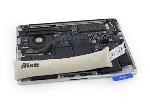

      • The liquid adhesive remover provided in your iFixit battery replacement kit can affect the antireflective coating on your MacBook Pro's display.
      • To protect your display, place a sheet of aluminum foil between the display and keyboard and leave it there while you work.
      Ask FixBot
    3. MacBook Pro 13" Retina Display Mid 2014 Battery Replacement: step 20, image 1 of 2 MacBook Pro 13" Retina Display Mid 2014 Battery Replacement: step 20, image 2 of 2
      • If you have an iFixit battery kit with liquid adhesive remover, it's time to get it prepped.
      • Alternatively, if you are using the hot iOpener method, skip the following three steps.

    5. MacBook Pro 13" Retina Display Mid 2014 Battery Replacement: step 22, image 1 of 1
      • Apply a few drops of adhesive remover evenly under the edge of the rightmost battery cell.
      • You don't need to use very much. The small bottle contains more than twice the amount of solvent needed to remove all the battery cells.
      • Wait 2-3 minutes for the liquid adhesive remover to penetrate underneath the battery cell before you proceed to the next step.
      • Use more adhesive remover if needed, but do not apply more than a few drops at a time. Using too much can allow the adhesive remover to make its way to the backside of your keyboard and potentially damage it.
      Ask FixBot

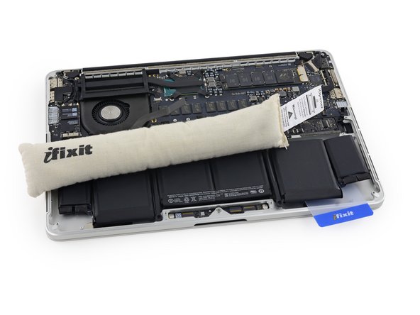

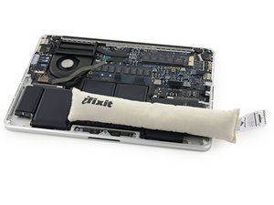

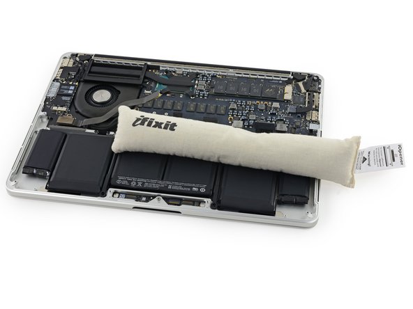

    6. MacBook Pro 13" Retina Display Mid 2014 Battery Replacement: step 23, image 1 of 2 MacBook Pro 13" Retina Display Mid 2014 Battery Replacement: step 23, image 2 of 2
      • If you don't have a liquid adhesive remover, you'll be using a hot iOpener to warm and soften a section of the adhesive securing the battery to the upper case, and then carefully prying at that point.
      • Use the hot iOpener to cover half of the two right-most battery cells.
      • After about a minute, reheat the iOpener and move it to cover the other half of the right-most battery cells.
      Ask FixBot

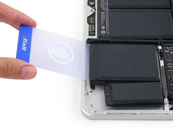

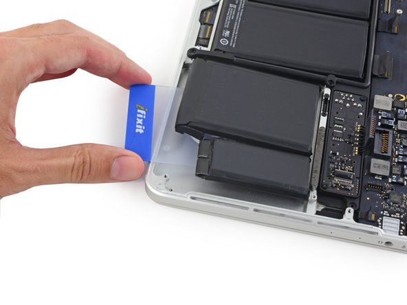

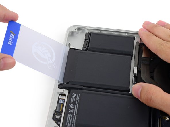

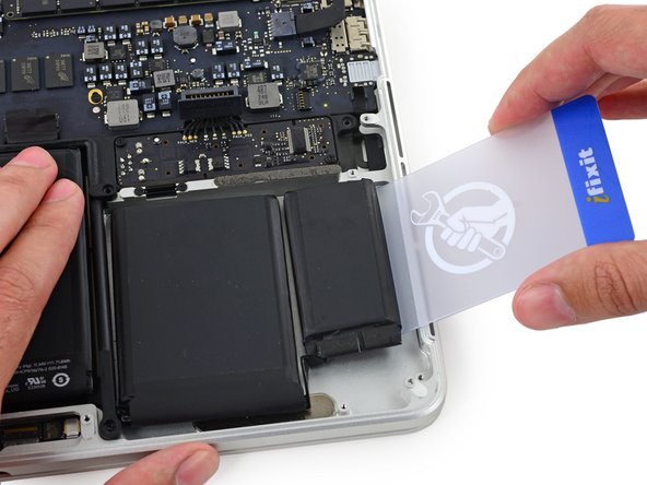

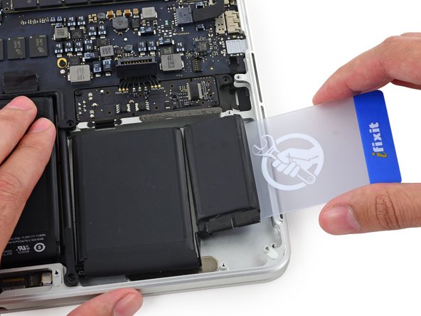

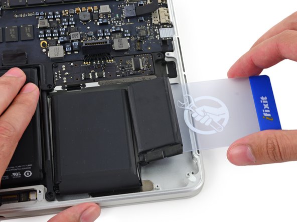

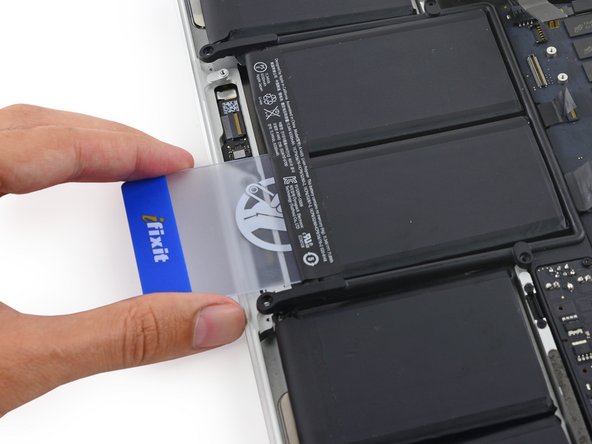

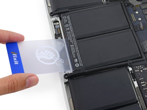

      • Push a plastic card between the right-most battery cell and the upper case, cutting the adhesive between the two.
      • Throughout this procedure, be careful not to damage any of the battery cells with your tools. A damaged lithium-ion battery may leak dangerous chemicals and/or catch fire. Use only plastic pry tools.
      • When using the hot iOpener method, if you encounter significant resistance to prying, stop and use the iOpener to reheat the section you're working on.
      Ask FixBot

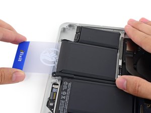

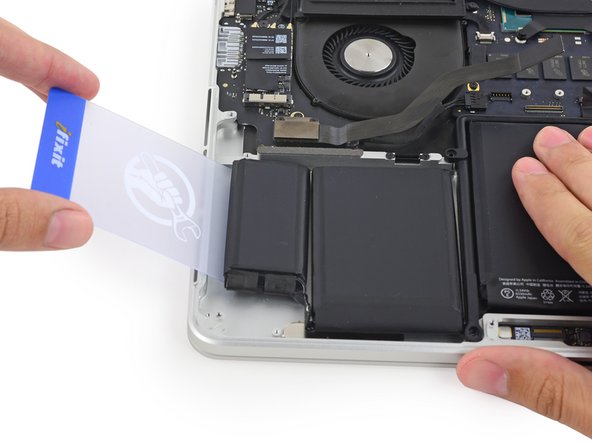

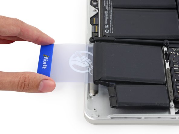

    8. MacBook Pro 13" Retina Display Mid 2014 Battery Replacement: step 25, image 1 of 2 MacBook Pro 13" Retina Display Mid 2014 Battery Replacement: step 25, image 2 of 2

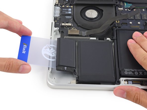

      • Use the plastic card to pry the right-most battery cell up from the rear case.
      Ask FixBot

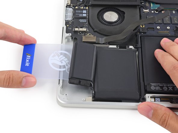

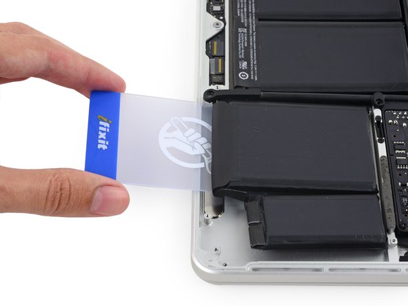

    9. MacBook Pro 13" Retina Display Mid 2014 Battery Replacement: step 26, image 1 of 3 MacBook Pro 13" Retina Display Mid 2014 Battery Replacement: step 26, image 2 of 3 MacBook Pro 13" Retina Display Mid 2014 Battery Replacement: step 26, image 3 of 3
      • Repeat this procedure with the adjacent battery cell:
      • Apply a small amount of liquid adhesive remover under the battery cell, and wait 2-3 minutes for it to penetrate and soften the adhesive.
      • Alternatively, re-heat this section with your iOpener if needed.
      • Push a plastic card about an inch between the battery cell and the upper case, and slowly pry the cell up to separate all of the adhesive.
      Ask FixBot

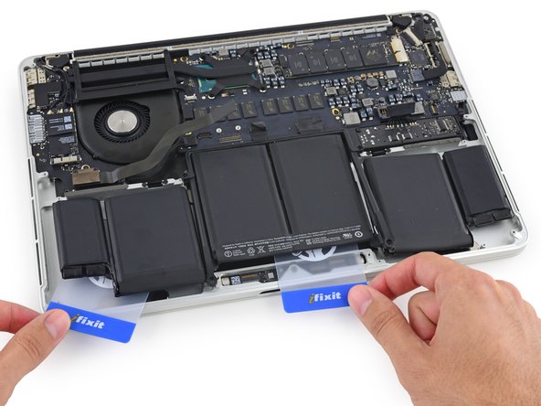

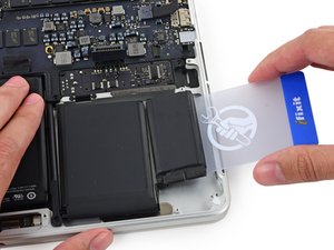

    10. MacBook Pro 13" Retina Display Mid 2014 Battery Replacement: step 27, image 1 of 3 MacBook Pro 13" Retina Display Mid 2014 Battery Replacement: step 27, image 2 of 3 MacBook Pro 13" Retina Display Mid 2014 Battery Replacement: step 27, image 3 of 3

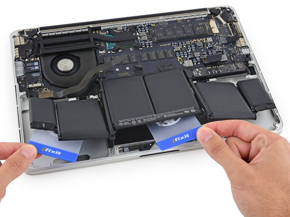

      • Temporarily leave your plastic card underneath the two rightmost battery cells to prevent them from re-adhering to the upper case.
      • If using an iOpener, reheat it and reapply it, this time to the left-most battery cells.
      • Again, leave the iOpener in each position for about a minute, reheating in between, to heat each half of the left-most battery cells.
      Ask FixBot

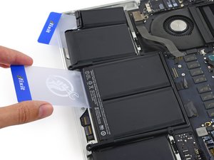

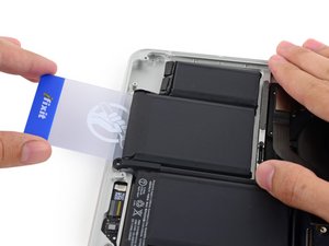

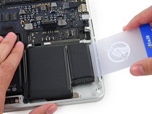

    11. MacBook Pro 13" Retina Display Mid 2014 Battery Replacement: step 28, image 1 of 3 MacBook Pro 13" Retina Display Mid 2014 Battery Replacement: step 28, image 2 of 3 MacBook Pro 13" Retina Display Mid 2014 Battery Replacement: step 28, image 3 of 3

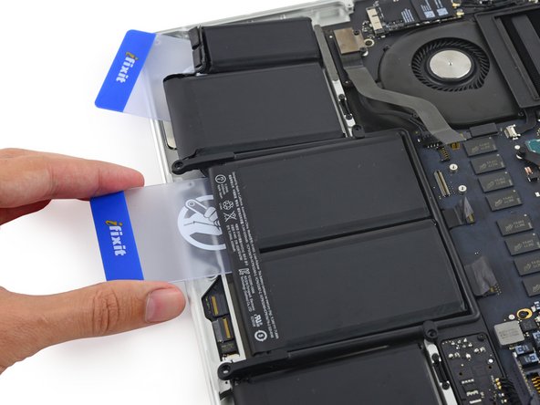

      • Repeat the above procedure to separate the two leftmost battery cells from the upper case.
      • Remember to apply a small amount of adhesive remover to each battery cell, and wait 2-3 minutes for it to penetrate and soften the adhesive.
      • Use a second plastic card to separate the two leftmost battery cells from the upper case.
      Ask FixBot
    12. MacBook Pro 13" Retina Display Mid 2014 Battery Replacement: step 29, image 1 of 1
      • Leave the second card in the corner between the two left cells.
      • In the following steps, you can either use a third card, or the card from the right corner. The right corner adhesive should be dry/cool enough that the cells can easily be pulled up again when needed.

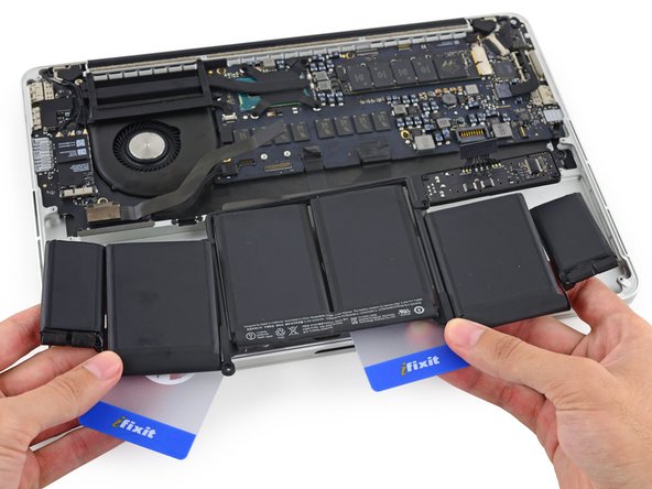

    13. MacBook Pro 13" Retina Display Mid 2014 Battery Replacement: step 30, image 1 of 2 MacBook Pro 13" Retina Display Mid 2014 Battery Replacement: step 30, image 2 of 2
      • To separate the adhesive securing the final two, middle battery cells, apply a few more drops of liquid adhesive remover (or your iOpener) to each cell.
      • Apply the adhesive remover sparingly, since the trackpad lies beneath this area of the battery.
      • It may help to elevate one side of your MacBook Pro a few inches so that the adhesive remover flows in the correct direction, underneath the battery cells. You can use a sturdy book or foam block to prop up one side of your MacBook Pro while you work.
      • Insert the card about an inch between the left-center battery cell and the upper case, separating the adhesive between the cell and the case.
      Ask FixBot

    15. MacBook Pro 13" Retina Display Mid 2014 Battery Replacement: step 32, image 1 of 2 MacBook Pro 13" Retina Display Mid 2014 Battery Replacement: step 32, image 2 of 2
      • By this point, the outer cells should be free, and you should only encounter resistance from the two center cells. If this is not the case, go back and completely loosen the four outer-most cells from the upper case.
      • Pry up on the two center cells to separate the last of the adhesive and lift the battery from the device.
      Ask FixBot
    16. MacBook Pro 13" Retina Display Mid 2014 Battery Replacement: step 33, image 1 of 2 MacBook Pro 13" Retina Display Mid 2014 Battery Replacement: step 33, image 2 of 2
      • Remove the battery.
