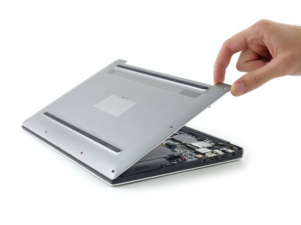

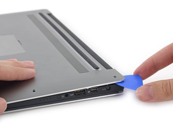

Setting aside the driver that handy label called for, we whip out a T5 and dispatch the case screws. While requiring two different drivers just to get the thing open has us scratching our heads, at least we've got screws! That's better than the alternatives—gummy adhesive to cut or clips that may break. We spoke too soon—there are clips, too, and hefty ones at that. As we wrestle with the case, we're left wondering if Dell went for the trifecta: screws, clips, and glue?
  • Setting aside the driver that handy label called for, we whip out a T5 and dispatch the case screws.
    • While requiring two different drivers just to get the thing open has us scratching our heads, at least we've got screws! That's better than the alternatives—gummy adhesive to cut or clips that may break.
  • We spoke too soon—there are clips, too, and hefty ones at that. As we wrestle with the case, we're left wondering if Dell went for the trifecta: screws, clips, and glue?
  • We finally remove the stubborn lower case, and it turns out that it was just some serious clippage fighting us. Definitely one of those "easier-when-you-know-how" opening procedures.
Picture is wrong. You should unlatch the clips from sides and front first. The back are not clips. After all the sides and front clips are off, Pull the base toward the front and off. So if you need to re - install, you seat the back first and the close the sides and front.

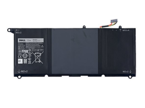

The Dell XPS 13 features a four-cell, 7.4 V, 52 Wh battery with "up to 11 hours of run time." That's 11 hours of web browsing, with "system brightness set to 150 nits (40%) and wireless on"—highly dependent on personal configuration and usage.
  • The Dell XPS 13 features a four-cell, 7.4 V, 52 Wh battery with "up to 11 hours of run time."
    • That's 11 hours of web browsing, with "system brightness set to 150 nits (40%) and wireless on"—highly dependent on personal configuration and usage.
    • Usage reports vary pretty wildly on the functional battery life.
  • For comparison: Apple's Early 2014 MacBook Air claims 12 hours of web browsing or iTunes movie playback on its 54 Wh battery.

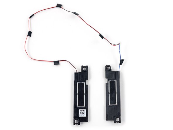

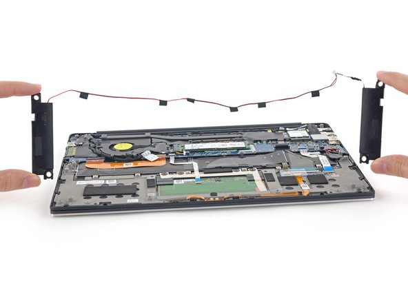

With the battery out, the speakers are free to jump ship as well. The speakers rest on vibration dampening rubber grommets. Squishy. These speakers are really good friends. They go everywhere together. It's almost as if they're joined at the hip cable.
  • With the battery out, the speakers are free to jump ship as well.
    • The speakers rest on vibration dampening rubber grommets. Squishy.
  • These speakers are really good friends. They go everywhere together. It's almost as if they're joined at the hip cable.
    • Replacing a single speaker will require soldering to splice into the cable, or crimping wires into a new connector.
      • On the plus side, free nunchucks.

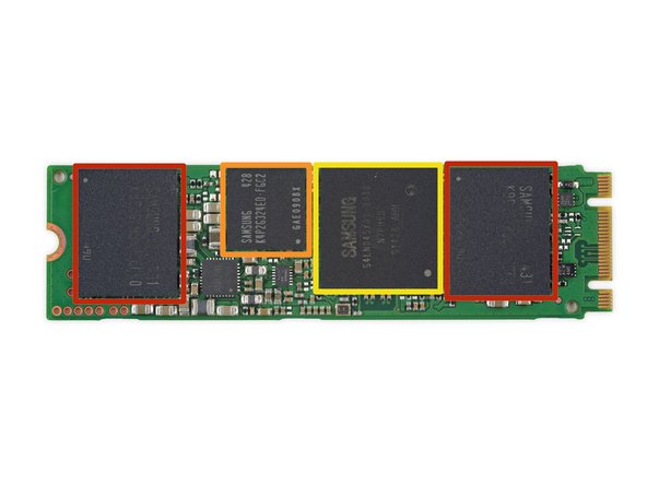

This particular XPS is packing a removable 128 GB Samsung PM851 M.2 form factor SSD. 2 x Samsung 431 K9CHGY8S5M-CCK0 64 GB TLC NAND flash Samsung 428 K4P2G324ED-FGC2 512 MB LPDDR2 DRAM
  • This particular XPS is packing a removable 128 GB Samsung PM851 M.2 form factor SSD.
    • 2 x Samsung 431 K9CHGY8S5M-CCK0 64 GB TLC NAND flash
    • Samsung 428 K4P2G324ED-FGC2 512 MB LPDDR2 DRAM
    • Samsung S4LN045X01-8030 MDX controller
  • This is a well-established form factor for SATA 3 SSDs, so finding an upgrade or replacement will be as easy as something that's really easy.
  • But wait, there's more! This SSD comes complete with an unremarkable underside.

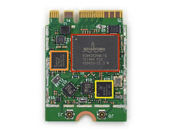

With tweezers in hand, we easily dispatch the wireless card grounding bracket. Underneath, we find a Broadcom DW1560 Wi-Fi/Bluetooth 4.0 LE card, featuring: Broadcom BCM4352KML 5G WiFi 2-stream 802.11ac transceiver
  • With tweezers in hand, we easily dispatch the wireless card grounding bracket.
  • Underneath, we find a Broadcom DW1560 Wi-Fi/Bluetooth 4.0 LE card, featuring:
    • Broadcom BCM4352KML 5G WiFi 2-stream 802.11ac transceiver
    • Broadcom BCM20702 single-chip Bluetooth 4.0 solution with BLE support
    • Skyworks SE5516 dual-band 802.11a/b/g/n/ac WLAN front-end module
There's a Philips head screw that holds the bracket for the wifi card down.

I am needing a DW1560 card, where can I get one? Thanks
Yerik - Reply
BTW I used this guide to swap out the Broadcom for Intel wifi card for Ubuntu 15.10 - worked a dream
paul broome - Reply
Can you use the intel wifi card on Windows 10?
houndwoo -
Yes you can use the Intel 8260NGW on windows 10.. and it works better than the Broadcom.
Almus - Reply

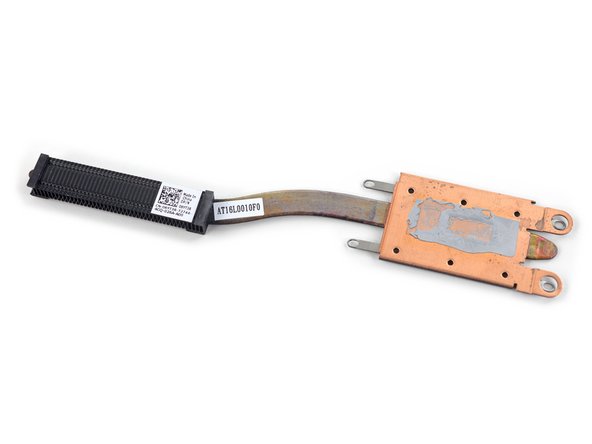

Time to get into some more exciting bits: eyes on the heat sink. Said sink looks awfully similar to that of the Early 2014 MacBook Air. It comes complete with some crusty thermal paste. Yum. Lately, we've seen a trend toward smaller heat sinks as Intel improves its processors' thermal efficiency. The Core i5-5200U loaded in the XPS 13 rates 15 watts of thermal design power.
  • Time to get into some more exciting bits: eyes on the heat sink. Said sink looks awfully similar to that of the Early 2014 MacBook Air.
  • It comes complete with some crusty thermal paste. Yum.
  • Lately, we've seen a trend toward smaller heat sinks as Intel improves its processors' thermal efficiency. The Core i5-5200U loaded in the XPS 13 rates 15 watts of thermal design power.
Help please, one of the screws on the heat sink is striped and cant remove it, I really wanted to change the thermal paste on the heat sink, all the other screws came out fine but I dont know how to remove the striped one. Should I just forget about it or what can I do to remove it and replace it? What type of screw can I replace it with?

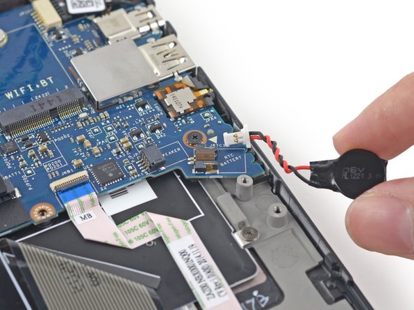

Tape, cables, and labeled connectors have been the defining characteristics of the XPS 13's guts. There are a lot of components, with a lot of connecting cables, and a lot of tape holding everything down. At least it's tough, re-stickable fabric tape. There's a small (labeled!) coin cell battery to keep the real-time clock running. We're expecting this sort of reaction when we reassemble the computer and power it back on.
  • Tape, cables, and labeled connectors have been the defining characteristics of the XPS 13's guts. There are a lot of components, with a lot of connecting cables, and a lot of tape holding everything down.
    • At least it's tough, re-stickable fabric tape.
  • There's a small (labeled!) coin cell battery to keep the real-time clock running. We're expecting this sort of reaction when we reassemble the computer and power it back on.

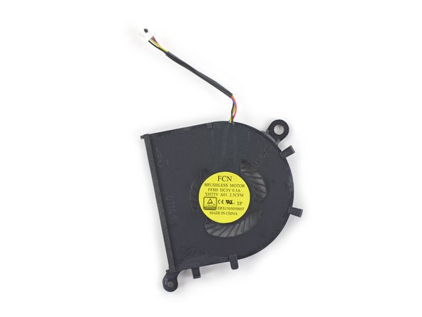

The XPS 13's biggest only fan. What can we say, it's a fan. It runs at 5 volts and 0.5 amps, for a whopping 2.5 watts of super-exciting centrifugal cooling power. We're a little miffed that we had to come this far to get the fan out, and that it doesn't share the same vibration-dampening considerations as its speaker brethren.
  • The XPS 13's biggest only fan.
  • What can we say, it's a fan. It runs at 5 volts and 0.5 amps, for a whopping 2.5 watts of super-exciting centrifugal cooling power.
  • We're a little miffed that we had to come this far to get the fan out, and that it doesn't share the same vibration-dampening considerations as its speaker brethren.
    • Without rubber mounting grommets, it may well develop a noise issue in the future. Needless to say, we don't want any of that jibber jabber.

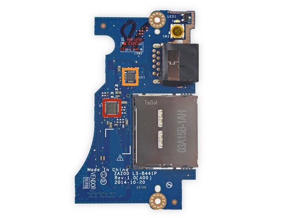

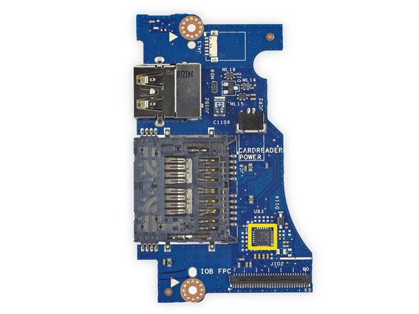

Alright, that's enough. This construction is more than a little ridiculous. Waiter! There's a screw in my tape! After some screwy disassembly, we free the I/O board and find: Realtek RTS5249 card reader controller
  • Alright, that's enough. This construction is more than a little ridiculous. Waiter! There's a screw in my tape!
  • After some screwy disassembly, we free the I/O board and find:
    • Realtek RTS5249 card reader controller
    • Texas Instruments TPS2544 USB charging port controller and power switch
    • Parade PS8713B single port USB 3.0 repeater/redriver

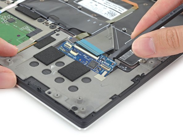

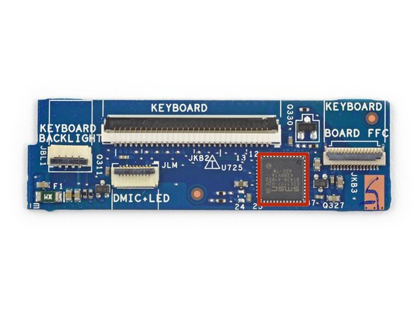

We scoop out the last* of the exciting** bits: an LED indicator cable, and this weird interconnect board! * Technically we still have the trackpad, keyboard, and DC-in port. ** Author's discretion
  • We scoop out the last* of the exciting** bits: an LED indicator cable, and this weird interconnect board!
    • * Technically we still have the trackpad, keyboard, and DC-in port.
    • ** Author's discretion
  • Living on the interconnect board and managing the keyboard, keyboard backlight, front LEDs, and dual mics:
    • SMSC (Microchip) ECE1117 multi-function BC-Link/SMBus companion device
If the ribbon labelled DMIC+LED was disconnected would that affect anything other than the annoying LED on the front of the laptop that shows up when you're charging it?
Ethan Rose - Reply

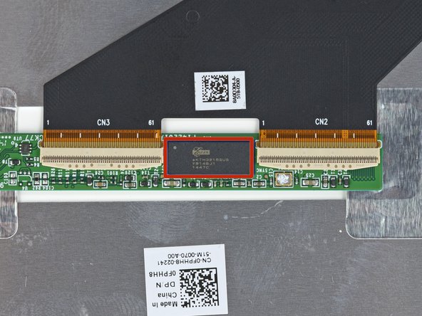

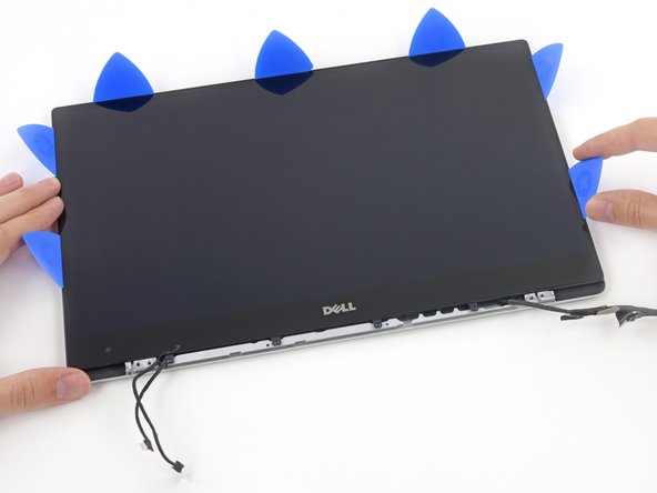

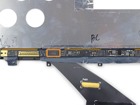

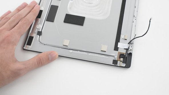

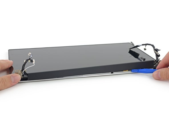

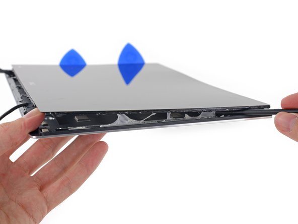

Enough dilly-dallying, let's get to the fun part. The new exciting feature that Dell is really trying to sell here: The ultra high def, infinity-edged touch screen display. Wait did we accidentally get a MacBook display somehow? Déja vu... The clutch cover comes off in much the same way as on a MacBook Pro, revealing a plastic frame of antennas.
  • Enough dilly-dallying, let's get to the fun part. The new exciting feature that Dell is really trying to sell here: The ultra high def, infinity-edged touch screen display.
Is it possible to replace a non-touch screen with a touch screen or FHD with QHD?
Zheng Jiewei - Reply
For your own information and anyone else who has the same question, my 1080 res screen broke a couple weeks ago, and since the QHD screen was only $50 more on eBay, I decided to opt for that. I just finished the replacement, and everything is working perfectly. If you want to upgrade, the XPS motherboard has the touch screen slot, even if you ordered the non-touch monitor, and all other adapters are identical.
Austin Ezell -
It'd be interesting if that's possible, because it would also allow getting the i7 model and "downgrading" to the FHD screen assembly for better battery life and a matte screen.
williamwernert -
Hello, I replaced my dell xps 13 9333 with a touchscreen replacement, however my

  • We're getting pretty good at prying up glass, so we've got some idea of where to start.
    • Step 1: Load up on heat. Use plenty of iOpeners. (Or one iOpener plenty of times).
    • Step 2: Pry gently in many places. Opening Picks are the ideal tool.
    • Step 3: ???
    • Step 4: The edges you just heated are nowhere near the adhesive you wanted to loosen. The adhesive is entirely under the LCD panel.
    • Step 4b: Apply plenty of heat to the back and pry slowly.
  • An infinity pool has no visible edge, making the water appear infinite. Using the transitive property, we deduce that an infinity display has... infinite glue?
Whew! Okay, not heck-tons of adhesive, but it packs a punch. You'd better peel slowly and use plenty of heat. That's some thin glass. With the display fully out of the top case, we get a peek at the peeper of a selfie-cam.
  • Whew! Okay, not heck-tons of adhesive, but it packs a punch. You'd better peel slowly and use plenty of heat. That's some thin glass.
  • With the display fully out of the top case, we get a peek at the peeper of a selfie-cam.
Is there any way to test the pinout of that camera? I'd like to insert a very small (15mmx20mmx4mm approx) usb hub between the motherboard and the camera, to facilitate the addition of an onboard fingerprint sensor.
kurt - Reply

Considering that the SSD is flat on one side, would this fit since it has chips on both sides?
http://www.amazon.com/Transcend-MTS800-S...
Low weiyou - Reply
I don't have that SSD on-hand to test for sure, but it looks like the XPS has a totally standard M.2 port—with enough of a gap between the SSD and the mother board for chips on both sides of the SSD.
Andrew Optimus Goldberg -
My previous reply was based on the thought that the SSD in this laptop was a Samsung SM951. I could have sworn that was in the teardown previously, but maybe it was too early in the morning :)
Since the model installed is the Samsung PM851 - a standard SATA M.2 80mm SSD, then another one like the Transcend mentioned will do just fine, as well as the Crucial M550 or MX200 M.2 when they are available.

Hello! I wanted to ask how you removed the lower case in Step 4. I am trying to do it to upgrade SSD but the lower case won't open! Thanks!
Oiprox - Reply
I managed to get my XPS 13 open thanks to this guide. The technique that worked best for me was to use the blue plastic triangle picks. Remove all the screws including the one under the "XPS" cover. From the back. With the laptop flipped over, vents closest to you. Put a blue pick into the area below the right side of the vent. See picture.
http://i.imgur.com/8J35rTQ.jpg
I then shoved a second pick on top of the first to give it more strength to lift/twist and pop off that corner of the cover. I worked around counter-clockwise from there. Sometimes I used up to three picks stacked to get the cover off. I replaced the SSD with a 250GB M.2 80mm drive.
somedude - Reply
Thanks for this solution, it's very helpful for me.
