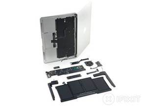

This teardown is not a repair guide. To repair your MacBook Air 13" Early 2015, use our service manual.
Image 1/2: 5th generation, dual-core Intel Core i5 processor with Intel HD Graphics 6000 Image 2/2: 128 GB flash storage (configurable to 512 GB)

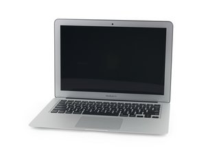

  • Can you smell it? There's fresh silicon in the Air. The MacBook Air 13" Early 2015 contains:
    • 5th generation, dual-core Intel Core i5 processor with Intel HD Graphics 6000
    • 128 GB flash storage (configurable to 512 GB)
    • 4 GB LPDDR3 RAM, configurable (but not upgradable) to 8 GB
    • 13.3" 1440x900 pixel display (~128 ppi)
    • 802.11ac Wi-Fi connectivity
    • Thunderbolt 2
    • Dual microphones

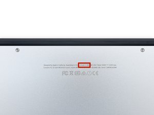

  • This newest 13" Air keeps its traditional model number, A1466. For identification purposes, you'll need your serial number, EMC (2925), or model year (2015).
    • At least it's not A1278.

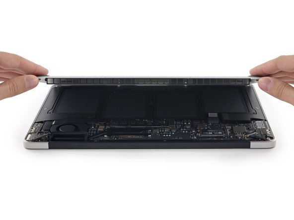

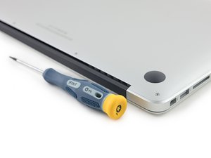

  • Ahh, mine old nemesis Pentalobe.
    • We see Apple hasn't changed its stripes—the classic pentalobe keeps this Air sealed up from the common fixer.
  • Luckily, we have a handy driver for just these occasions. And... we're in!

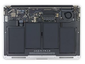

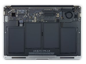

Image 1/2: At first glance, neither can we. This MacBook plays its AirPort cards pretty close to the vest. Image 2/2: The first image shows the 2015 model,  and the second is from our [guide|15042|stepid=49074|new_window=true].
  • One of these is the updated, Early 2015 MacBook Air, and the other hails from mid-2013. Can you tell which is which?
  • At first glance, neither can we. This MacBook plays its AirPort cards pretty close to the vest.
  • The first image shows the 2015 model, and the second is from our MacBook Air 13" Mid 2013 Teardown.
  • If you guessed wrong, fret not: we're about to get down to the nitty gritty.

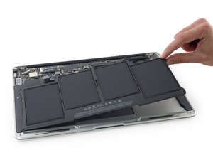

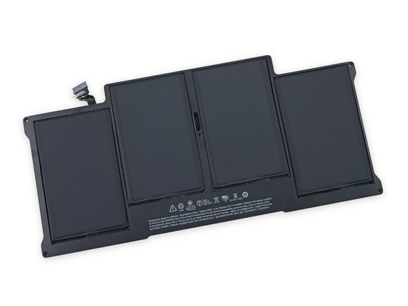

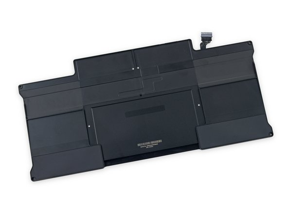

  • Up next, our favorite Air feature: battery removal. Thanks to this tidy plastic frame, the battery is held in with five screws and no adhesive—easy for fixers, easy for recyclers.
    • It's a design carried over from previous models—but if yesterday's reveal is anything to go by, it could be on the outs. It looks to us like Apple didn't like wasting internal space on a plastic frame that could instead be more battery.
    • In the absence of a frame, we're guessing those cells will get the glue treatment, signaling a continuation of the trend started by the Retina Pro.
  • The battery specs carry over as well: the Air continues to sport a 7.6 V, 54 Wh, 7150 mAh battery. Thanks to the new Broadwell chips, we're supposed to get more life out of the same capacity: Now up to 12 hours of web browsing or video playback.
    • For all you scorekeepers, that's 2 Wh and a theoretical 1 hour more than the new Dell XPS 13.

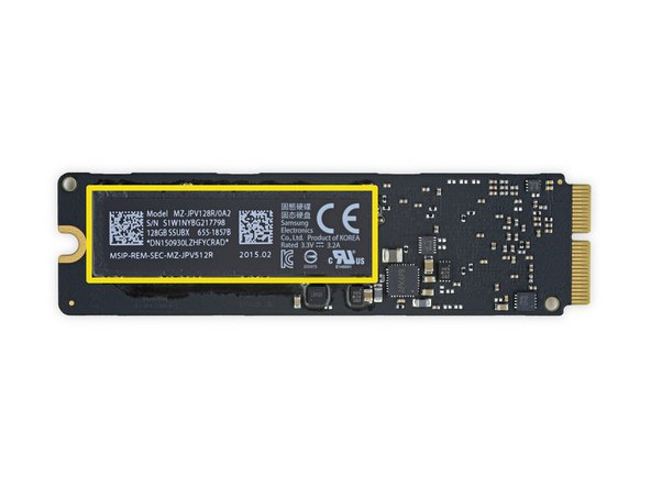

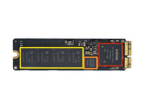

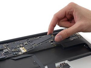

  • The flash memory is still PCIe-based, and remains, thankfully, removable—at least for now. Popping it out for inspection, we find:
    • Samsung S4LN058A01 PCIe 3.0 x4 AHCI flash controller
    • Samsung K4E4E324ED 512 MB LPDDR3 DRAM
    • 8 x Samsung K9LDGY8S1D-XCK0 16 GB flash storage (128 GB total)
  • Apple tells us this bad boy "...features faster flash storage that is up to two times faster than the previous generation."
    • We did a little benchmarking, and found that the claim is valid. Nice one, Apple!

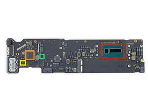

  • With the heavy bits removed, we catch the logic board before it floats away. Turning it over, we found the heart of the matter:
    • 1.6 GHz Intel Core i5 5250U processor, with integrated Intel HD Graphics 6000
    • Intel DSL5520 Thunderbolt 2 controller
    • GL3219 Genesys Logic SDXC controller
    • LT3957 Linear Technologies inverting controller
  • Broadwell shrinks the MacBook Air's previous architecture (Haswell)—meaning not a lot has changed performance-wise, but a new manufacturing process makes the transistors smaller, and the entire chip more power efficient by up to 30%.
  • In contrast, the integrated Intel HD Graphics 6000 brings a legit graphics performance boost (roughly a 20-25% improvement over HD 5000).

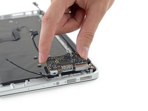

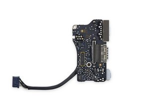

  • Continuing the trend of sameness, the I/O board is nearly identical to the one found in the MacBook Air 13" Mid 2013, even down to the audio codec IC:
    • Cirrus Logic 4208-CRZ HD audio codec, likely similar to the 4207
