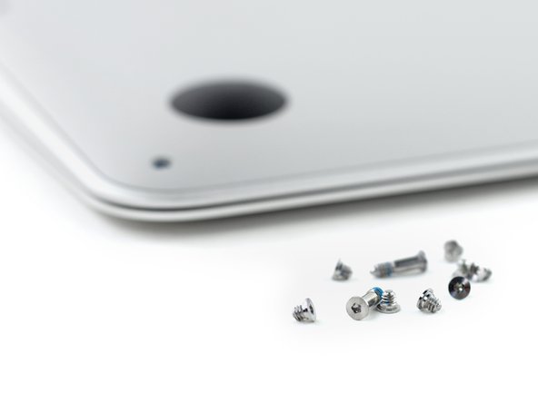

Image 1/2: We've got a few loose screws—and we're proud of it!
Edit Step 2  ¶
  • Before we dispatch the back case, we take a quick peek at the model number, A1465—the same digits we found on models dating as far back as mid 2012.
  • We've got a few loose screws—and we're proud of it!
    • We are proud that we're not getting screwed by any fastener, least of all Apple's proprietary pundit of prostration, the perfidious Pentalobe.

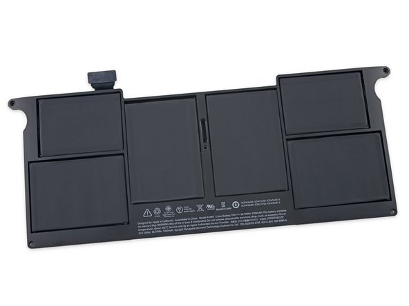

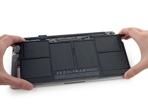

Image 1/3: That was easy. Removal was easy too, thanks to screws and no adhesive to get in the way of battery freedom. Let's see what this pack is packing:
Edit Step 4  ¶
  • All hands on deck! Spudgers at the ready! Disconnect battery!
  • That was easy. Removal was easy too, thanks to screws and no adhesive to get in the way of battery freedom. Let's see what this pack is packing:
    • While the 7.6 V, 5100 mAh (38.75 Whr) battery matches last year's model spec for spec, Apple alleges an extra hour of life while watching iTunes movies (up to 10).
      • This is most likely attributable to improvements in the new Broadwell CPU.
  • Microsoft promises a similar "9 hours of web browsing" from its MacBook Air killer, the Surface Pro 3. The Surface has a slightly larger 7.6 V, 5380 mAh (42.4 Whr) battery.

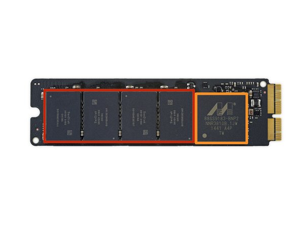

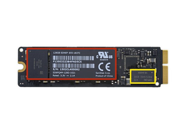

Image 1/3: Apple decides not to spread the upgrade fun; we get stuck with a geriatric, 2-year-old SSD. Bring on the extra help to get it up and out of bed.
Edit Step 5  ¶
  • While the bigger, badder, 13-incher Air got a faster and flashier SSD, the 11" model is stuck in 2013 with the same old, same old.
    • Apple decides not to spread the upgrade fun; we get stuck with a geriatric, 2-year-old SSD. Bring on the extra help to get it up and out of bed.
  • With a little poking and prodding, it proceeds to spill the beans—er, chips. In fact, they're very much the same chips we dipped into on the mid-2013 version:
    • 8 x SanDisk 05131 016G 16 GB NAND flash memory (128 GB total)
    • Marvell 88SS9183 PCIe SSD controller
    • Samsung K4B2G1646E 2 Gb (256 MB) DDR3 SDRAM

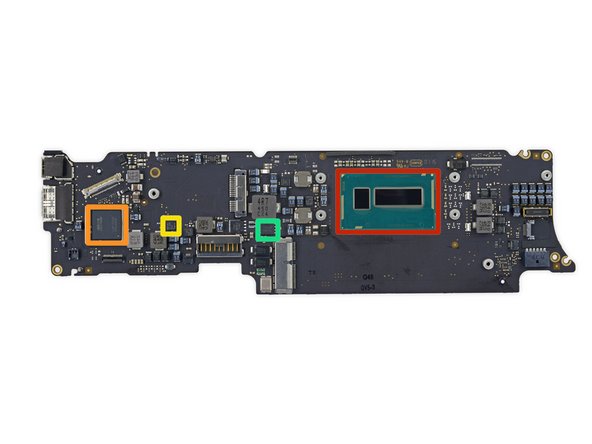

  • Greedy for more chips, we decide to give the logic board the clamps. What's our reward? Let's take a look-see:
    • 1.6 GHz Intel Core i5 5250U processor, with integrated Intel HD Graphics 6000
    • Intel DSL5520 Thunderbolt 2 controller
    • Texas Instruments 58873D synchronous buck NexFET power block MOSFET pair
    • ON Semiconductor 4902F RBV1L dual N-channel power MOSFET
  • Although Broadwell is mainly a 14 nm die shrink of the existing Haswell microarchitecture, it is up to 30% more power efficient.

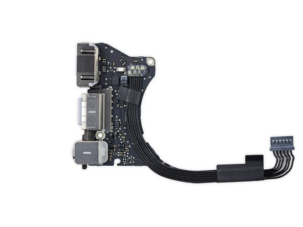

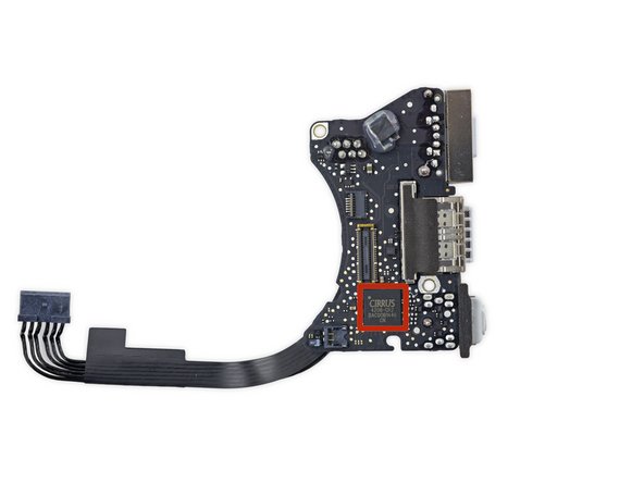

Image 1/3: With a ''light touch,'' we remove the I/O board for a better look at the headphone jack, a USB port, and the MagSafe 2 port.
Edit Step 8  ¶
  • We are airing the differences in these lightweight notebooks, and the last thing to come to the table is the I/O board.
  • With a light touch, we remove the I/O board for a better look at the headphone jack, a USB port, and the MagSafe 2 port.
  • A passing glance at the board reveals the same Cirrus Logic 4208-CRZ HD audio codec found in this year's 13" model (likely similar to the 4207).
