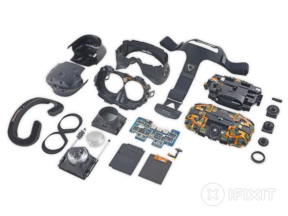

Video Overview
Introduction
Around here it's all about gadget guts. With VR becoming all the rage, we couldn't wait for a little Vive-section. What does HTC have hiding right before your eyes? Strap a black box to your head, 'cause we're about to find out! It's time to tear down the Vive.
Looking for more virtual fun? Follow us on Instagram, Twitter, and Facebook for all the latest repair news.
This teardown is not a repair guide. To repair your HTC Vive, use our service manual.
Image 1/3: Two 1080p AMOLED displays with a combined resolution of 2160 x 1200 Image 2/3: 90 Hz refresh rate Image 3/3: Built-in front-facing camera and microphone
  • It's been a long time coming, but 2016 seems to be the year when virtual reality finally becomes an actual reality. How does it work? Well, here are the specs:
    • Two 1080p AMOLED displays with a combined resolution of 2160 x 1200
    • 90 Hz refresh rate
    • Built-in front-facing camera and microphone
    • Accelerometer, gyroscope, and laser position sensor
    • 360-degree headset tracking via Lighthouse IR emitters
    • 110º horizontal field of view
  • This all compares pretty favorably—or in some cases, identically—with the Oculus Rift CV1 we tore down a few weeks ago.

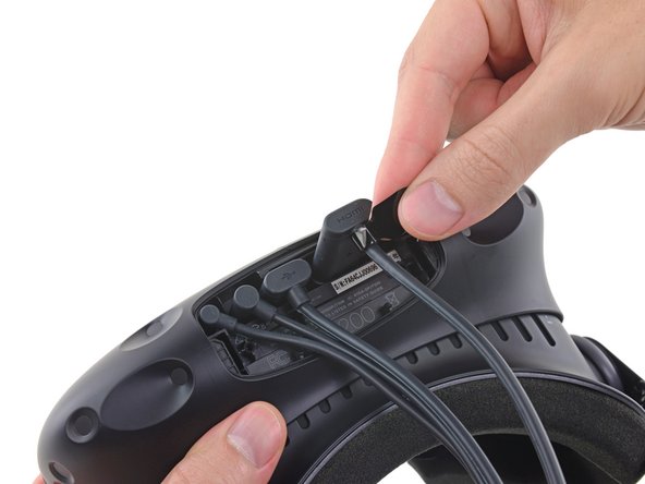

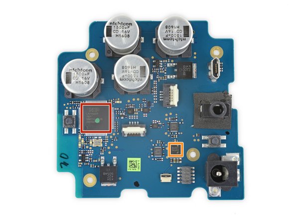

Image 1/3: We also spot a standard 3.5 mm audio jack, DC barrel jack, and a single HDMI port flanked by two USB 3.0 ports. Image 2/3: Interestingly, HTC left the rightmost USB port open for third-party accessories. Image 3/3: Bottoms up! We flip the Vive and go eye-to-eye with the front-facing camera. This unblinking cyclops also provides AR for the Vive. What's it running on? Let's get inside and find out.
  • After unplugging ourselves from the Matrix the four headset cables, we spy the headset's model number: 0PJT100.
  • We also spot a standard 3.5 mm audio jack, DC barrel jack, and a single HDMI port flanked by two USB 3.0 ports.
    • Interestingly, HTC left the rightmost USB port open for third-party accessories.

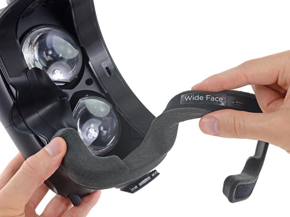

Image 1/3: We peel back the velcro to reveal a hidden message. Image 2/3: Who're you callin' [https://donaeley.files.wordpress.com/2014/03/chipmunk-cheeks-peanuts-g-427474.jpg| wide face|new_window=true]? Huh? Image 3/3: Nestled in a nook between the eyepieces is a proximity sensor that detects when the Vive is actually on your face—presumably to shut off the displays, conserving power and processor resources.
  • First to go is the interchangeable foam insert, velcroed to the headset for our convenience.
  • We peel back the velcro to reveal a hidden message.

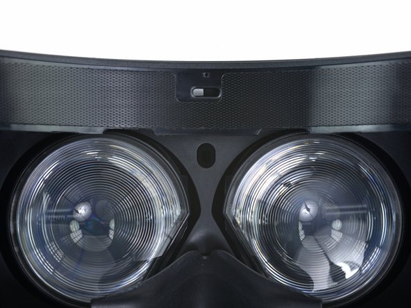

  • Nestled in a nook between the eyepieces is a proximity sensor that detects when the Vive is actually on your face—presumably to shut off the displays, conserving power and processor resources.

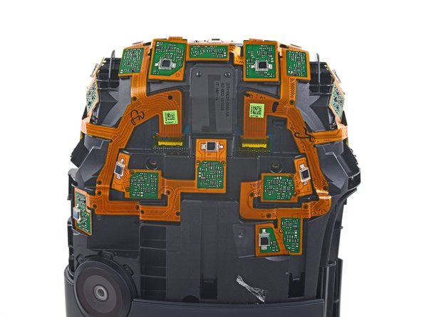

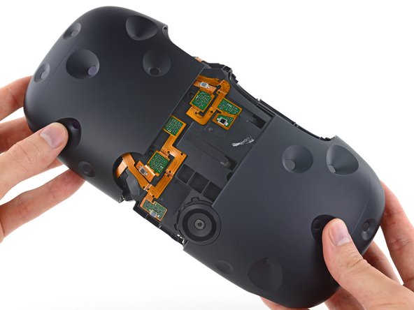

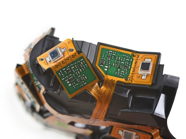

Image 1/3: Pulling back the outer shell on the Vive reveals a number of sensors—32 in total, according to HTC. Image 2/3: These photodiodes take in IR light from the two Lighthouse base stations as they flash and sweep  light across the room. This enables a connected PC to [https://www.youtube.com/watch?v=J54dotTt7k0|calculate the headset's position|new_window=true] and orientation in space as a function of the time between receiving the flash and the following IR laser sweep. Image 3/3: This method is the exact opposite of the head-tracking technique found in the Oculus Rift. In the Rift, the desk-mounted camera tracked the IR emitters in the headset, whereas in the Vive, the headset sees light from the mounted IR emitters without actually "tracking" its location.
  • We can't help but experience a little déjà vu as we unmask our latest subject.
  • Pulling back the outer shell on the Vive reveals a number of sensors—32 in total, according to HTC.
  • These photodiodes take in IR light from the two Lighthouse base stations as they flash and sweep light across the room. This enables a connected PC to calculate the headset's position and orientation in space as a function of the time between receiving the flash and the following IR laser sweep.
    • This method is the exact opposite of the head-tracking technique found in the Oculus Rift. In the Rift, the desk-mounted camera tracked the IR emitters in the headset, whereas in the Vive, the headset sees light from the mounted IR emitters without actually "tracking" its location.

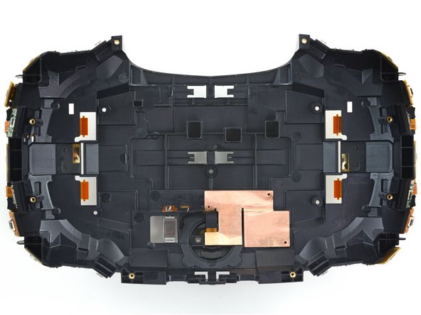

Image 1/3: For those of you keeping score, everything thus far has been super standard and easy to take apart. It seems that this apple fell especially far from the [https://www.ifixit.com/Teardown/HTC+One+Teardown/13494|tape|new_window=true]-[https://www.ifixit.com/Teardown/HTC+One+%28M8%29+Teardown/23615|and|new_window=true]-[https://www.ifixit.com/Teardown/HTC+One+M9+Teardown/39166|glue|new_window=true] tree. Image 2/3: After deftly dispatching a hidden press connector behind the front-facing camera, the whole sensor array lifts off. Easy peasy. Image 3/3: Hiding in the back of the assembly, we find a couple spring contacts that deliver power to the whole setup—and behind that swath of copper tape, the camera.
  • With the outer sheath removed, we flip the switch on a few ZIF connectors to disconnect the IR photodiode webbing from the motherboard.
    • For those of you keeping score, everything thus far has been super standard and easy to take apart. It seems that this apple fell especially far from the tape-and-glue tree.
  • After deftly dispatching a hidden press connector behind the front-facing camera, the whole sensor array lifts off. Easy peasy.
  • Hiding in the back of the assembly, we find a couple spring contacts that deliver power to the whole setup—and behind that swath of copper tape, the camera.

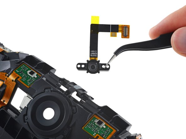

Image 1/2: That name might sound familiar. We've also seen Sunny camera modules in the [https://www.ifixit.com/Teardown/OnePlus+One+Teardown/26484#s66115|OnePlus One|new_window=true] and [https://www.ifixit.com/Teardown/Project+Tango+Teardown/23835#s61738|Project Tango|new_window=true] phones. Image 2/2: Working our way around the sensor net, we note that each of the sensors is individually numbered (photodiodes 18 and 19 in the photo).
  • With tweezers in hand, we pluck the front-facing camera out of the Vive. Manufactured by Sunny Optical Technology, it reads: TG07B C1551
  • Working our way around the sensor net, we note that each of the sensors is individually numbered (photodiodes 18 and 19 in the photo).

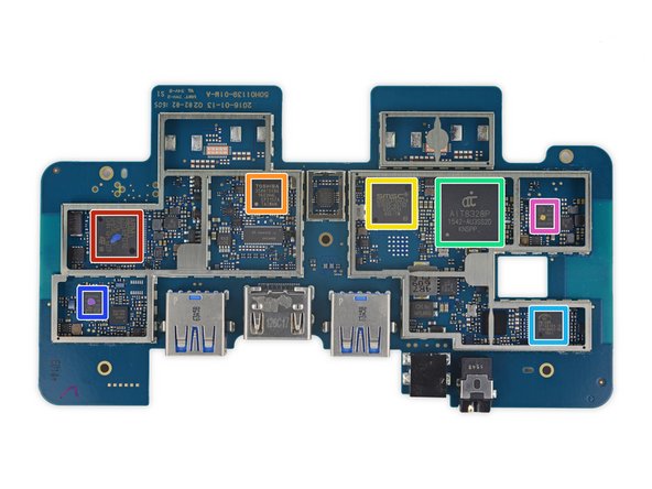

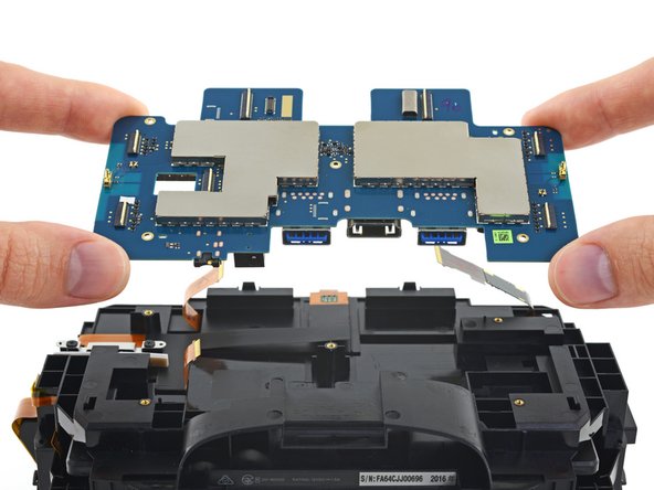

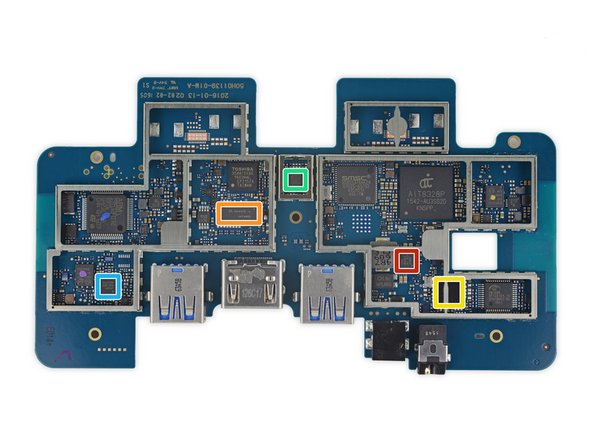

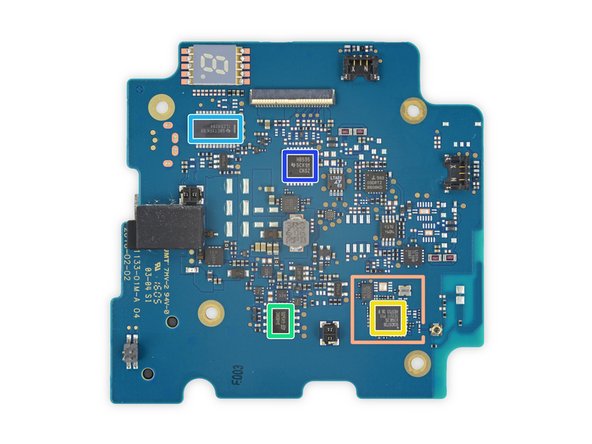

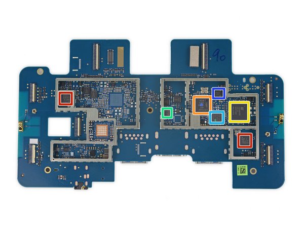

Image 1/2: STMicroelectronics [http://www2.st.com/content/st_com/en/products/microcontrollers/stm32-32-bit-arm-cortex-mcus/stm32f0-series/stm32f0x2/stm32f072r8.html|32F072R8|new_window=true] ARM [http://www.arm.com/products/processors/cortex-m/cortex-m0.php|Cortex-M0|new_window=true] Microcontroller Image 2/2: Toshiba [http://toshiba.semicon-storage.com/info/lookup.jsp?pid=TC358870XBG&lang=en&region=apc|TC358870XBG|new_window=true]  4K HDMI to MIPI Dual-DSI Converter (Also found in Oculus Rift CV1)
  • We have liftoff—of the motherboard, that is. Let's see what sort of silicon is lurking beneath those huge heat EMI shields. On the front side of the board:
    • STMicroelectronics 32F072R8 ARM Cortex-M0 Microcontroller
    • Toshiba TC358870XBG 4K HDMI to MIPI Dual-DSI Converter (Also found in Oculus Rift CV1)
    • SMSC USB5537B 7-Port USB Hub Controller
    • Alpha Imaging Technology AIT8328 SoC With Image Signal Processor
    • Cmedia CM108B USB Audio SoC
    • Micron M25P40 4 Mb Serial Flash Memory
    • Micron N25Q032A13ESE40E 32 Mb Serial Flash Memory
Image 1/1: Texas Instruments [http://www.ti.com/product/TPS54341|TPS54341|new_window=true] Buck Converter
  • Even more chips on the front:
    • Texas Instruments TPS54341 Buck Converter
    • Texas Instruments TS3DV642 12-Channel Bi-Directional Multiplexer/Demultiplexer
    • Cirrus Logic WM5102 Audio Codec
    • Pericom Semiconductor PI3EQX7841 USB 3.0 Repeater
    • Lattice Semiconductor LP4K81 A3311RG2 Ultra-low Power FPGA

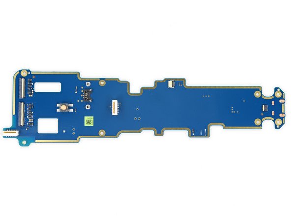

Image 1/1: Nordic Semiconductor [https://www.sparkfun.com/datasheets/Wireless/Nordic/nRF24LU1P_1_0.pdf|nRF24LU1P|new_window=true]  2.4 GHz SoC (x2)
  • Bringing up the rear, we have:
    • Nordic Semiconductor nRF24LU1P 2.4 GHz SoC (x2)
    • NXP Semiconductors 11U35F ARM Cortex-M0 Microcontroller
    • Lattice Semiconductor ICE40HX8K-CB132 High-Performance FPGA
    • Invensense MPU-6500 6-axis Gyroscope and Accelerometer Combo
    • National Semiconductor 61AE81U L00075B Linear Voltage Regulator

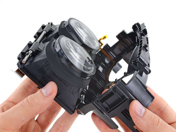

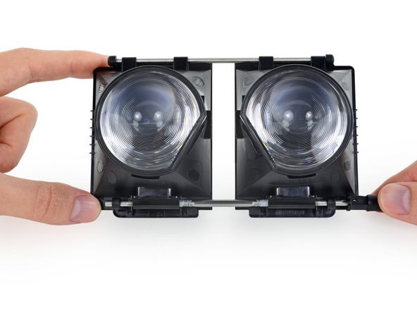

  • Ready to go deeper, we remove the twin lens-and-display assemblies from their housing and peel off the rubber light-gasket from around the lenses.

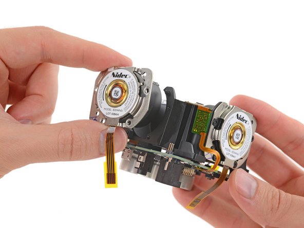

Image 1/2: Speaking of [https://en.wikipedia.org/wiki/Interpupillary_distance|interpupillary distance|new_window=true] adjustment, here's the mechanism that makes that possible. Image 2/2: It's a simple threaded rod with a slider at the top. It couldn't be simpler, really—just give it a twist.
  • Open! Close! Open! Close!
    • Speaking of interpupillary distance adjustment, here's the mechanism that makes that possible.
    • It's a simple threaded rod with a slider at the top. It couldn't be simpler, really—just give it a twist.
    • We saw something similar on the Oculus Rift CV1—although the Rift packs a more sophisticated (and more complicated) dual rack-and-pinion system.
Image 1/3: Each display measures ~91.8 mm diagonally, which translates to ~447 ppi. For comparison, the Rift CV1 has ~456 ppi due to a slightly smaller display (90 mm) that still packs the same resolution as the Vive. Image 2/3: Each display measures ~91.8 mm diagonally, which translates to ~447 ppi. For comparison, the Rift CV1 has ~456 ppi due to a slightly smaller display (90 mm) that still packs the same resolution as the Vive. Image 3/3: Each display measures ~91.8 mm diagonally, which translates to ~447 ppi. For comparison, the Rift CV1 has ~456 ppi due to a slightly smaller display (90 mm) that still packs the same resolution as the Vive.
  • After adios-ing four Phillips screws and doing a little investigative prying, we lift away the display cover for access to one of the twin Samsung-branded AMOLED panels.
  • Each display measures ~91.8 mm diagonally, which translates to ~447 ppi. For comparison, the Rift CV1 has ~456 ppi due to a slightly smaller display (90 mm) that still packs the same resolution as the Vive.

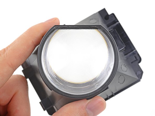

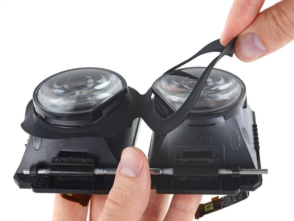

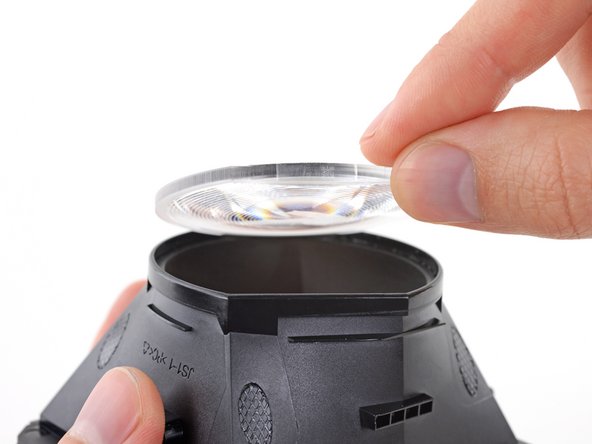

Image 1/3: We note a set of concentric rings in each lens—the [https://www.ifixit.com/Teardown/Oculus+Rift+CV1+Teardown/60612#s126752|familiar|new_window=true] indicator of Fresnel lenses. Image 2/3: Unlike the [https://www.ifixit.com/Teardown/Oculus+Rift+CV1+Teardown/60612#s126966|hybrid lenses|new_window=true] we encountered in the Oculus Rift, the Vive's lenses ''appear'' to have a uniform contour. It seems that HTC opted to control focus through adjustment of the eye relief. Image 3/3: Etched right into the side of the lens, we find the smallest QR code we've ever seen. Despite our best efforts, we can't get it to scan.
  • A bit of adhesive secures each lens, but it doesn't take much to pop them out.
  • We note a set of concentric rings in each lens—the familiar indicator of Fresnel lenses.
  • Unlike the hybrid lenses we encountered in the Oculus Rift, the Vive's lenses appear to have a uniform contour. It seems that HTC opted to control focus through adjustment of the eye relief.
  • Etched right into the side of the lens, we find the smallest QR code we've ever seen. Despite our best efforts, we can't get it to scan.

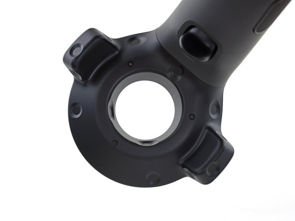

Image 1/3: The Vive is manufactured by HTC, but it's quite evident that Valve had plenty of input on the design process. The controller touchpad is ''very ''reminiscent of the ones we found on the [https://www.ifixit.com/Teardown/Steam+Controller+Teardown/52578|Steam Controller]. Image 2/3: In addition to the touchpad and buttons, the controller comes packed with 24 sensors (including two ''inside'' the ring!) that allow it to accurately track the its position based on the two Lighthouse base stations. Image 3/3: In addition to the touchpad and buttons, the controller comes packed with 24 sensors (including two ''inside'' the ring!) that allow it to accurately track the its position based on the two Lighthouse base stations.

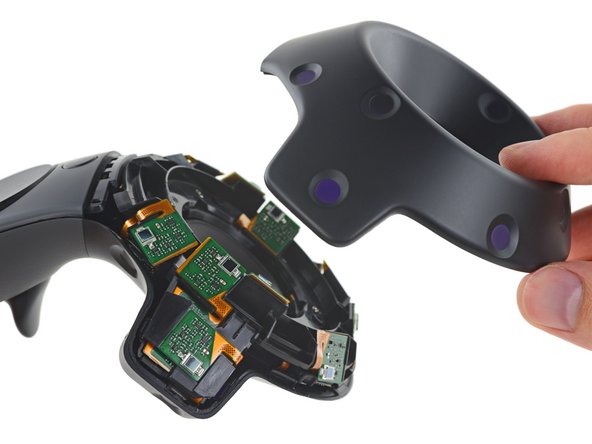

  • With the headset completely disassembled, it's time to move on to the controller. A quick inspection reveals the model number: 2PR7100.
  • The Vive is manufactured by HTC, but it's quite evident that Valve had plenty of input on the design process. The controller touchpad is very reminiscent of the ones we found on the Steam Controller.
  • In addition to the touchpad and buttons, the controller comes packed with 24 sensors (including two inside the ring!) that allow it to accurately track the its position based on the two Lighthouse base stations.

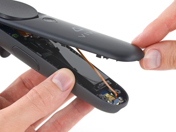

Image 1/3: As we work our way down the controller, we find a ribbon cable booby trap, à la [https://www.ifixit.com/Teardown/iPhone+5s+Teardown/17383|iPhone 5s|new_window=true] and [https://www.ifixit.com/Teardown/iPhone+SE+Teardown/60902#s127178|iPhone SE|new_window=true]. Image 2/3: Trap defused,  we pop open the handle and take a closer look. Image 3/3: Trap defused,  we pop open the handle and take a closer look.
  • A few Torx screws and some tough plastic clips keep the outer case and IR filters shut tight, but it's nothing we can't handle.
  • As we work our way down the controller, we find a ribbon cable booby trap, à la iPhone 5s and iPhone SE.
  • Trap defused, we pop open the handle and take a closer look.

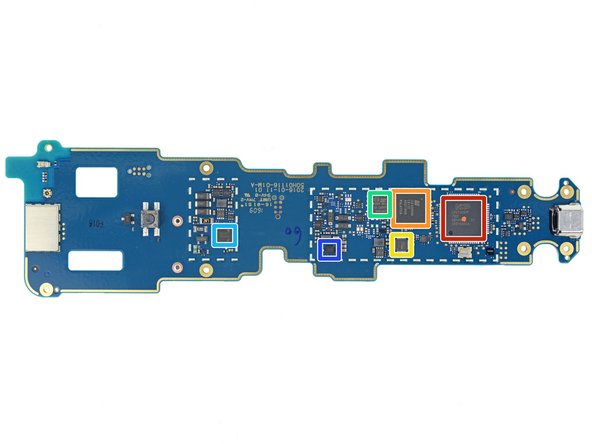

Image 1/3: Just like before, the touchpad is driven by a Cirque 1CA027 companion MCU. Image 2/3: As with the Steam Controller, the PCB also features seven well-labeled test points that make it easy to directly interface with the board for testing. Image 3/3: Up next is the 3.85 V, 3.69 Whr, and 960 mAh Li-poly battery. After giving it a good looksee, we spot the model number B0PLH100, and a large QR code.
  • After removing the touchpad assembly from the controller, we immediately notice that the daughterboard is near-identical to the one found in the Steam Controller.
    • Just like before, the touchpad is driven by a Cirque 1CA027 companion MCU.
  • As with the Steam Controller, the PCB also features seven well-labeled test points that make it easy to directly interface with the board for testing.

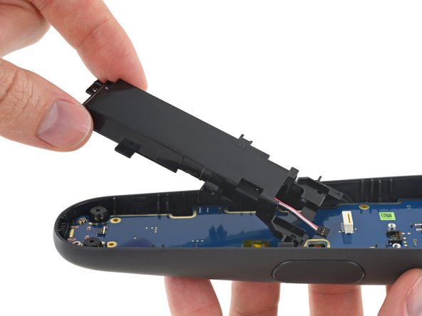

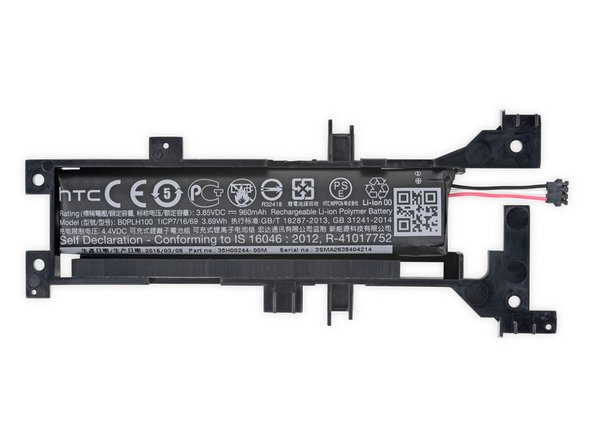

  • Up next is the 3.85 V, 3.69 Whr, and 960 mAh Li-poly battery. After giving it a good looksee, we spot the model number B0PLH100, and a large QR code.

Image 1/2: NXP Semiconductors [http://www.nxp.com/documents/data_sheet/LPC11U3X.pdf|11U37F|new_window=true] ARM [http://www.arm.com/products/processors/cortex-m/cortex-m0.php|Cortex-M0|new_window=true] Microcontroller Image 2/2: Lattice Semiconductor [http://www.latticesemi.com/~/media/LatticeSemi/Documents/DataSheets/iCE/iCE40LPHXFamilyDataSheet.pdf| ICE40HX8K-CB132|new_window=true] Ultra-low Power FPGA
  • There are a few common chips between the controller and the headset, as well as a few new ones:
    • NXP Semiconductors 11U37F ARM Cortex-M0 Microcontroller
    • Lattice Semiconductor ICE40HX8K-CB132 Ultra-low Power FPGA
    • National Semiconductor 61AKE6U L00075B Linear Voltage Regulator
    • TI BQ24158 Battery Charger IC

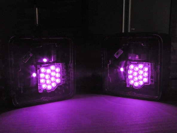

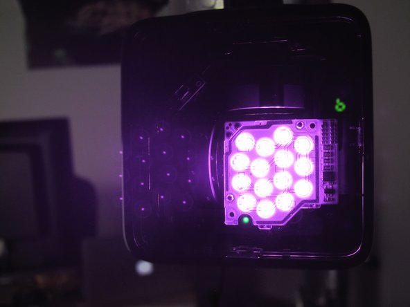

Image 1/3: Firing up our IR camera, we get a glimpse of the internals through the IR-transparent front panel—an array of bright IR LEDs, and a pair of motorized lasers make the Lighthouse [https://www.youtube.com/watch?v=i7iSkdRRWcE|shine bright|new_window=true]. Image 2/3: While the Rift works with an IR camera and some fancy machine vision software to follow the [https://www.ifixit.com/Teardown/Oculus+Rift+CV1+Teardown/60612#s126455|Constellation IR LED|new_window=true] array, the Vive uses an entirely different [http://gizmodo.com/this-is-how-valve-s-amazing-lighthouse-tracking-technol-1705356768|system for position tracking|new_window=true]. Image 3/3: Each Lighthouse flashes its IR LED array, signaling the start of a cycle. Vertical and horizontal lasers then sweep across the room, and all of those fancy photosensors on the headset and controllers start looking for lasers.
  • With the headset and controllers torn asunder, we move right along to one of the Lighthouse base stations. What secrets does it hold? Let's find out!
  • Firing up our IR camera, we get a glimpse of the internals through the IR-transparent front panel—an array of bright IR LEDs, and a pair of motorized lasers make the Lighthouse shine bright.
  • While the Rift works with an IR camera and some fancy machine vision software to follow the Constellation IR LED array, the Vive uses an entirely different system for position tracking.
  • Each Lighthouse flashes its IR LED array, signaling the start of a cycle. Vertical and horizontal lasers then sweep across the room, and all of those fancy photosensors on the headset and controllers start looking for lasers.
  • The tracked headset or controller can then determine its position based on the order its sensors receive the laser sweeps.

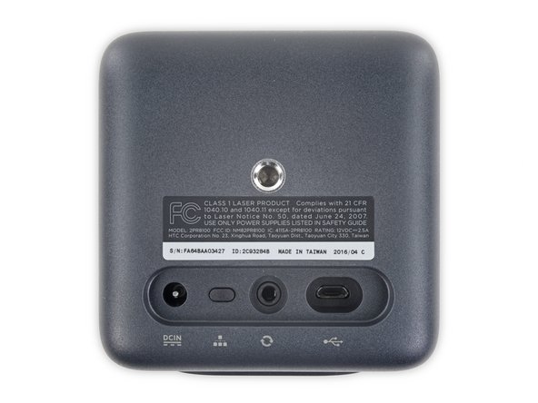

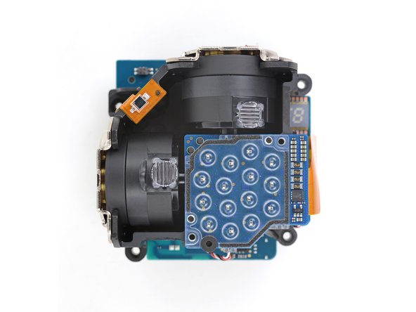

Image 1/3: The base station sports the model number [https://fccid.io/NM82PR8100|2PR8100|new_window=true] as well as a Class 1 Laser Product regulatory label. Image 2/3: This rating means that the IR lasers contained inside the base station are within the maximum permissible exposure rating established by the [http://www.fda.gov/AboutFDA/CentersOffices/OfficeofMedicalProductsandTobacco/CDRH/|CDRH|new_window=true]. In other words, the lasers can be shined on the eye or skin with a negligible chance of damage. Image 3/3: With a trusty iOpener and opening pick in hand, we quickly dispatch a few clips and some sticky gasketing that secure the base station's front panel.
  • Time to crack the Lighthouse open and check how the system matches our science.
  • The base station sports the model number 2PR8100 as well as a Class 1 Laser Product regulatory label.
    • This rating means that the IR lasers contained inside the base station are within the maximum permissible exposure rating established by the CDRH. In other words, the lasers can be shined on the eye or skin with a negligible chance of damage.

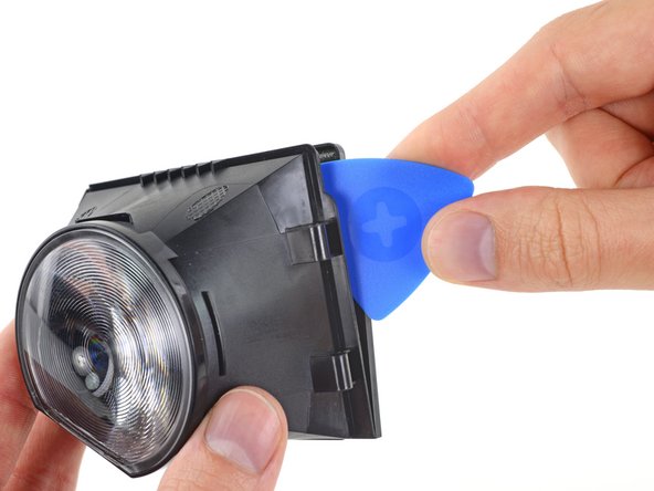

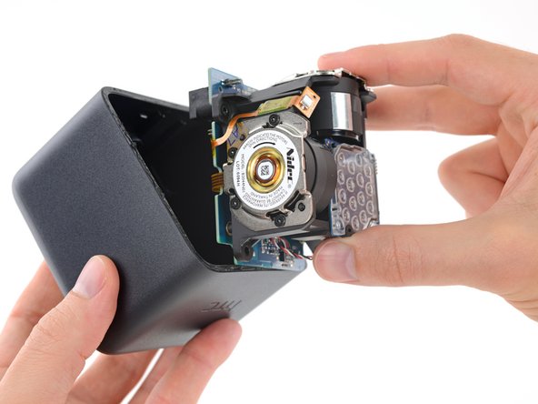

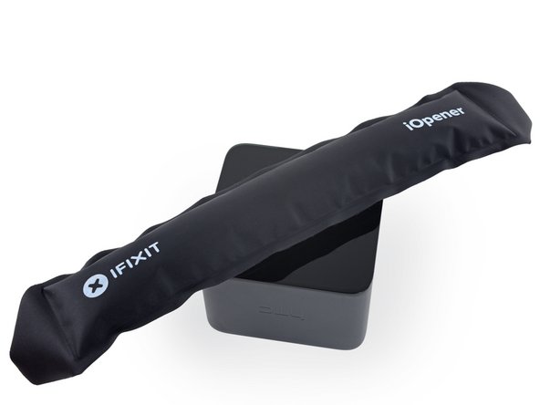

  • With a trusty iOpener and opening pick in hand, we quickly dispatch a few clips and some sticky gasketing that secure the base station's front panel.

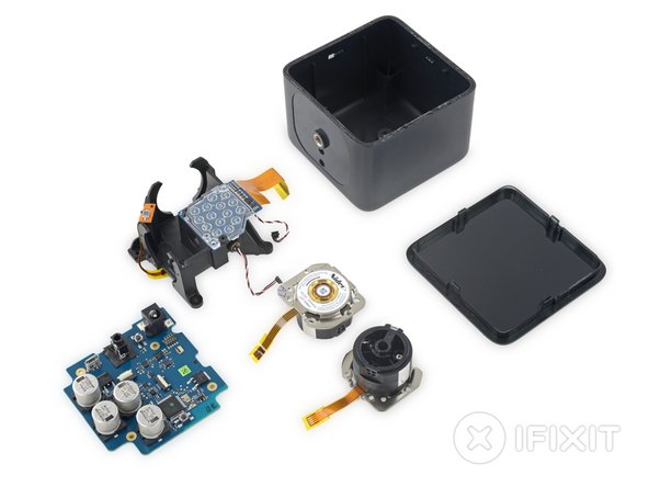

Image 1/2: Aaaand we're done. Lucky for us, the whole unit is installed as a single assembly within the Lighthouse base station housing. Just remove the four Torx screws, and it falls right out. Image 2/2: With the cover off, we get a look at the array of IR LEDs and spinning motor-mounted laser emitters, as well as a single IR photodiode that allows the device to sync up with its counterpart.
  • The front panel removed with relative ease, we prepare for the harrowing task of extracting the complex internals from this optical tech marvel.
  • Aaaand we're done. Lucky for us, the whole unit is installed as a single assembly within the Lighthouse base station housing. Just remove the four Torx screws, and it falls right out.
  • With the cover off, we get a look at the array of IR LEDs and spinning motor-mounted laser emitters, as well as a single IR photodiode that allows the device to sync up with its counterpart.
I was wondering whether you know the wavelength of the IR-lasers?
simonpelle - Reply
Image 1/2: NXP Semiconductors [http://www.nxp.com/documents/data_sheet/LPC11U3X.pdf|11U37F|new_window=true] ARM Cortex-M0 Microcontroller Image 2/2: National Semiconductor 61AFCXU L00075B Linear Voltage Regulator
  • Let's shed some light on what sort of chips are powering the Lighthouse:
    • National Semiconductor 61AFCXU L00075B Linear Voltage Regulator
    • Broadcom BCM20736 Bluetooth Smart SoC
    • STMicroelectronics ST1480AC Transceiver
    • Texas Instruments TLC59284 16-Channel LED Driver
    • Texas Instruments SN74AHCT595DBR 8-Bit Shift Register With 3-State Output Register

Image 1/2: [http://www.nidec.com/en-Global/|Nidec |new_window=true] may not be a household name, but we've seen their DC motors before powering fans in the [https://www.ifixit.com/Teardown/Xbox+One+Kinect+Teardown/19725#s55254|Xbox One Kinect|new_window=true], as well as the [https://www.ifixit.com/Teardown/Mac+Pro+Late+2013+Teardown/20778#s56814|new_window=true|Mac Pro Late 2013]. These particular motors read: B2044N01. Image 2/2: With the Lighthouse parts laid out for inspection, this teardown is adjourned.
  • All of our repair wishes are coming true today! Each laser motor mounts to the Lighthouse emitter assembly via four T5 Torx screws, and connects to the motherboard with a single ZIF connector.
  • Nidec may not be a household name, but we've seen their DC motors before powering fans in the Xbox One Kinect, as well as the Mac Pro Late 2013. These particular motors read: B2044N01.
  • With the Lighthouse parts laid out for inspection, this teardown is adjourned.
ndtec is a japanese Electric machinery manufacturer
vere - Reply

Image 1/3: Although it's a complicated bit of kit, the headset breaks down readily and without damage. Image 2/3: The head strap and face pads are removable and don't incorporate any sensors or electronics that might be prone to failure. Image 3/3: Standard Phillips and Torx screws are used throughout the headset, controllers, and base stations.
  • The HTC Vive Repairability Score: 8 out of 10 (10 is best):
    • Although it's a complicated bit of kit, the headset breaks down readily and without damage.
    • The head strap and face pads are removable and don't incorporate any sensors or electronics that might be prone to failure.
    • Standard Phillips and Torx screws are used throughout the headset, controllers, and base stations.
    • Reuse of the touchpad hardware from the Steam Controller means some replacement components are likely already available.
    • The large number of components, many of them quite delicate, means you'll want a service manual before attempting repairs.
    • Adhesive is used sparingly, but secures the lenses, Lighthouse base station covers, and sensor arrays.

I was hoping I'd learn more about whether eye relief could be reduced even more than what is possible stock. My friend, who wears glasses, was able to use the closest setting just fine (i.e. no need to create more clearance). I don't wear glasses. When I've removed the foam surround and placed the Vive to my face I've noticed the BEST image -- least blurriness / largest sweet spot and widest perceived FOV. It's not comfortable to do this with the straps on but someone modded a nightmask as an even smaller foam surround than the Wide Face (stock) one. It shows that getting those lenses even closer to naked eyes could have benefits.
Anyway, it seems A) there's room between the lenses and my eyeballs and B) getting the lenses closer would be beneficial. I was wondering if they erred on the side of caution (with regard to glasses wearers) with the eye relief adjuster but that the chassis could actually handle less distance. Maybe a plastic tab artificially governing how close you can get the lenses?
Thoughts?
Kevin White - Reply
The problem is your eyes not the hardware. Go to the dollar store and get a couple pair of cheep reading glasses is various strengths. Note that many people need different corrections right and left. Once you determine which lens works best for each eye order a set of glasses from an online prescription glasses place. Be sure to get the anti-reflective coating.
Modding your new toy to is a bad idea.
Dave Adams -
See this thread for a mod that replaces the foam gasket with some thin material from a sleep mask:
https://www.reddit.com/r/Vive/comments/4...
Mechanically reducing eye relief doesn't appear to be possible without heavy physical warranty-ruining modification.
Michael Stinton -
Dave Adams, I have very good eyesight, but thank you. The Rift, for example, is quite clear. Why do you think the closest distance the lenses can currently go is the optimum? Why do you think that's the optimum for all faces?
Michael Sinton, yes... I mentioned that when I wrote "someone modded a nightmask as an even smaller foam surround than the Wide Face (stock) one." But I suppose you're right about the heavy / breaking mod. It's just a shame. The screens / optics can clearly do with being closer and there's clearly enough room to move them closer (as evidenced by my glasses-wearing friend having plenty of room even at the closest position).
Maybe something will get figured out at some point. I think there's some additional clarity and perceived FOV wideness waiting to be unlocked while using the stock comfy surround pad.
Kevin White -
See this video I had made with similar concern. It is not using stock , but there are options while you try to sort out more risky mods.
https://youtu.be/bY9eEG9efpw?list=PLBeUk...
GameMaker04 -
According to my experiments with paint.net, the QR code translates to "3YVA-60320-36130"
Rich Woods - Reply
QR Code on Lens: 3YVA-60320-36130
Edit: Rich beat me to the punch by 4min. So, consider this confirmation of his results.
Patrick Hall - Reply
Bugger, an hour late even!
I guess confirmation 3 for the QR code, with proof: http://imgur.com/jiRh3Iw
Ethan Palmer - Reply

I reconstructed the lens QR code. It decodes to the text string '3YVA-60320-36130'

Any chance of a mechanical drawing of the lenses?
adrianhcyuen - Reply

"This rating means that the IR lasers contained inside the base station are within the maximum permissible exposure rating established by the FCC. In other words, the lasers can be shined on the eye or skin with a negligible chance of damage."
This is incorrect, MPE is set by the CDRH a division of the FDA, not the FCC
Frank Echanique - Reply

This is great, one of my controllers trackpads came in defected on arrival. So I'm planning to take apart my controller to figure out what's wrong with it.
gnathen w - Reply
How did this turn out? Did you manage to repair your controller? The system button of mine does not respond anymore and i am thinking about opening it up... as soon as i get my hands on a T5 xD
Roland Hof -

I, too, thought I'd be terribly clever and unique and solve the QR code without checking to see if it had already been done. 3YVA-60320-36130.
https://drive.google.com/open?id=0B2dLMc...
Matthew Ewer - Reply
lightbase motors seem to be breaking a lot - mine already gave up twice, any idea where can I get replacment motors?
Leszek Grzyl - Reply
Salut, on peu changer les lentilles je pense non ?
mxvrinfo - Reply

What is focal length of lens of headset?
alexmartian - Reply
