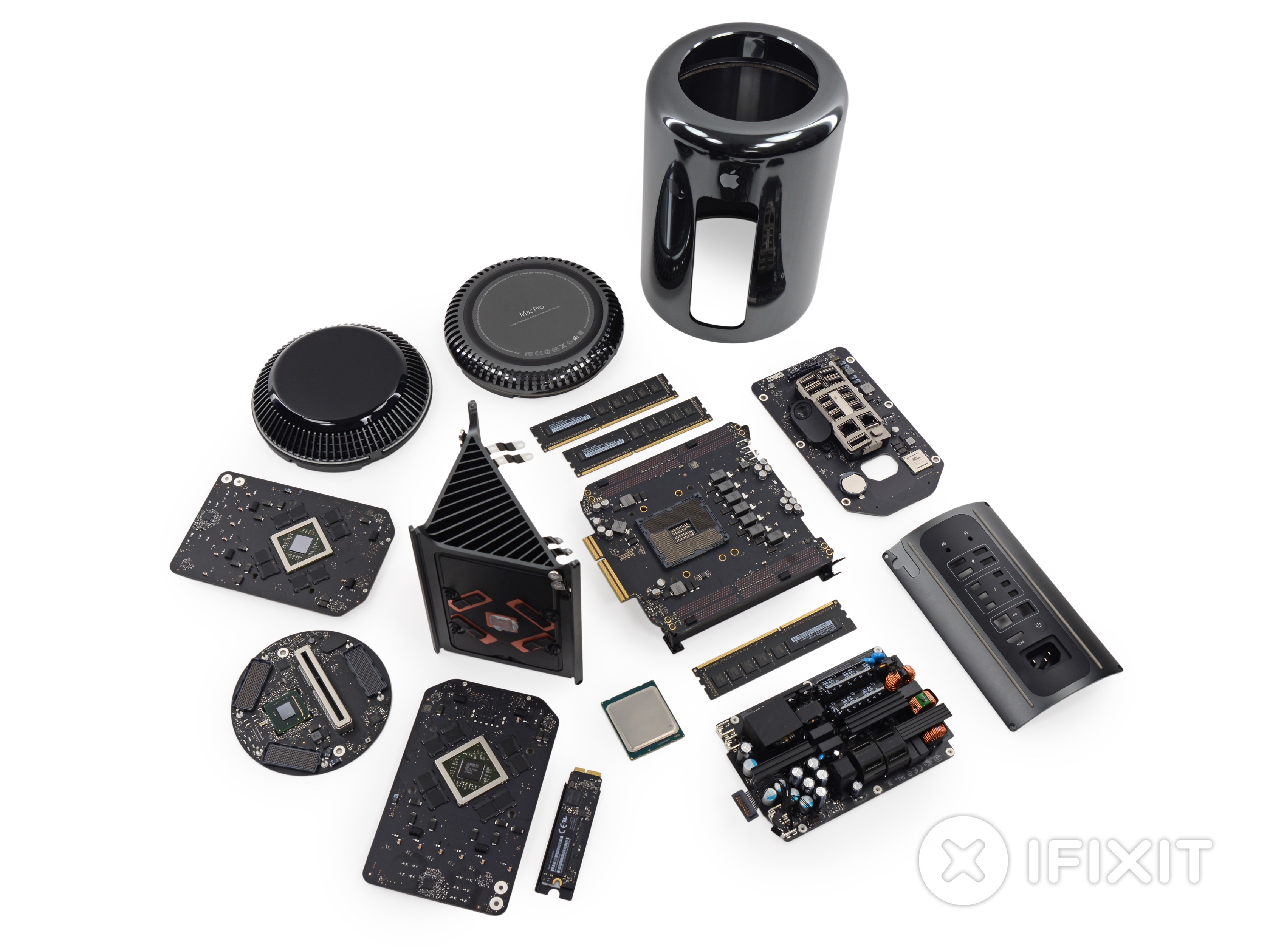

  1. Mac Pro Late 2013 Teardown, Mac Pro Late 2013 Teardown: step 1, image 1 of 2 Mac Pro Late 2013 Teardown, Mac Pro Late 2013 Teardown: step 1, image 2 of 2
    • The new Mac Pro has been released, and we've managed to get our hands on the entry-level model, "inexpensively" priced at $2,999.
    • Tech Specs:
    • Quad-Core Intel Xeon E5 with 10 MB L3 cache and Turbo Boost up to 3.9 GHz
    • 12 GB (three 4 GB modules) of 1866 MHz DDR3 ECC memory
    • Dual AMD FirePro D300 graphics processors with 2 GB of GDDR5 VRAM each
    • 256 GB PCIe-based flash storage
    • 802.11ac Wi-Fi wireless networking and Bluetooth 4.0 wireless technology

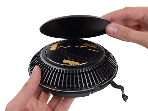

    • Teardown update: You asked, we answered. We popped the plastic roof off the fan module and found a whole new stash of precision engineering.

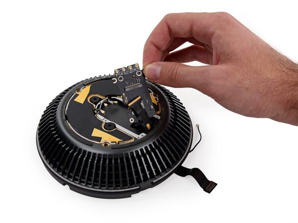

    • Snug in a nest of antennas, the AirPort card fits onto a small adapter board that also connects to the fan below.
    • Those three large screws secure the fan, with vibration-dampening rubber bumpers, like we've seen in iMacs.

    • More deja vu as we uncap the AirPort card and find what looks to be the same configuration found in most Apple products today:
    • Broadcom BCM4360 5G Wi-Fi 3-stream 802.11ac gigabit transceiver
    • Broadcom BCM20702 single-chip Bluetooth 4.0 HCI solution with Bluetooth Low Energy (BLE) support
    • Skyworks SE5516 dual-band 802.11a/b/g/n/ac WLAN front-end modules

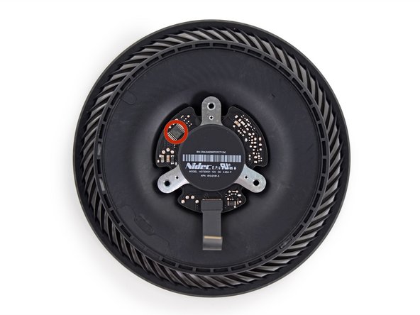

    • With the fan released, it looks to be powered by a Nidec brushless DC motor, model number AG720K01.
    • The motor controller IC is an Allegro Microsystems A5940LPT Three Phase Sensorless Sinusoidal Fan Driver.
    • We noticed a few cavities around the edges of the impeller filled with some sort of epoxy (on both sides). We suspect it's for fine-tuned balancing, to keep the fan running smooth and quiet.
