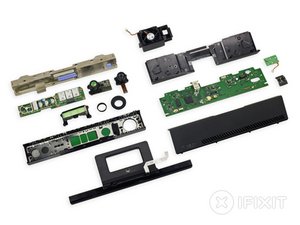

Hot on the heels of our Xbox One teardown, we’re cracking open the Kinect 2.0, the fully re-engineered next-gen version of Microsoft's voice, vision, and motion control accessory. Intel on all the innovative innards is inbound from our teardown team in New Zealand!

Microsoft has designated the Xbox One Kinect as model 1520.
Once again, Microsoft sends a friendly greeting from its headquarters in Seattle.
The fan assembly requires minimal disassembly. We scatter the grille, cowling, and fan as we go.
The 5 volt DC fan is manufactured by Nidec and is labeled as U40R05MS1A7-57A07A.

Plan C: we dis-kinect this little light board.
Small but important, this board plays host to an LED and a sensor.
We remove another layer of cowling standing between us and teardown glory.
IC U too!
Microsoft X871141-001 - Per our honored cohorts at Chipworks, this "replaces the Prime Sense chip used in the first Kinect. By the look of the font and package codes it's from STMicroelectronics"
Samsung K4B1G1646G 1 Gb (128 MB) DDR3 SDRAM

Texas Instruments TPS54325 - Per the evil geniuses at Chipworks, this is an adaptive on-time D-CAP2™ mode synchronous buck converter.
Brace yourself; this frame bracket is coming out.
Layers of metal add rigidity to the Kinect, while leaving room for components.
Function over form—this bracket also serves as a heat sink, as evidenced by the adhered thermal pads.
Pretty purple filters cover what appear to be the three IR blasters. If humans could see in infrared, we're guessing this would be pretty psychedelic.
As it stands, you'll have to settle for invisible IR magic bathing your living room, such as only your Kinect can see.

Xbox One Kinect Repairability: 6 out of 10 (10 is easiest to repair).
It's super easy to replace the fan once you get inside.
While there isn't much to fix inside, most components are modular and held in place with screws. If you need to replace one of the eight million cameras, you can…
…but, not so much the three little IR blasters in the center of the sensor bar. Those are held in place with soldered-in straps, because Microsoft.
Screws hidden under tamper-evident tape and tricky clips make it tricky to get inside.
The same screw types from the original Kinect are back, (still) including one repair-inhibiting T10 Security bit.
