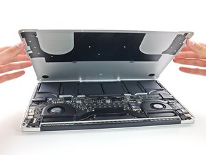

We took apart the new 15" Retina MacBook Pro with the hopes that Apple made it more repair-friendly than the debut Mid 2012 model. Unfortunately, things didn't really work out in our favor; in fact, they took a turn for the (slightly) worse.
Even the headphone jack is now soldered to the logic board, which is definitely a component that can wear out over time. Users don't have to be malicious or aggressive when using the port — cyclical stress can cause it to fail either way.
For those of us who care about repair, do note that this is now your only 15" option; Apple stopped selling the non-Retina 15" MacBook Pro.

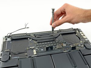

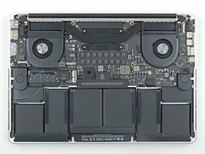

  • This top-tier machine from Apple packs some impressive specs:
    • 2.0 GHz quad-core Intel Core i7
    • 8 GB of 1600 MHz DDR3L onboard memory
    • 256 GB of PCIe SSD goodness
    • Intel Iris Pro Graphics
    • 720p FaceTime HD camera
    • 802.11ac Wi‑Fi wireless networking
    • Bluetooth 4.0

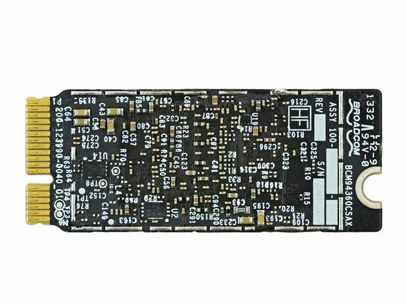

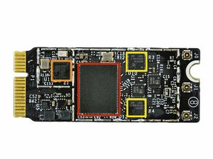

  • Easy-upgrade #2: Add a new AirPort card that supports 802.11ac Wi-Fi.
    • Apple's go-to provider of 802.11ac support is again at work. The Broadcom BCM4360 on this AirPort card enables operation on the 5 GHz band at speeds up to 1.3 Gbps.
    • A Broadcom BCM20702 Single-Chip Bluetooth 4.0 Processor gets Bluetoothy things done for your convenience.
    • Also in residence are a pair of Skyworks SE5516 dual-band 802.11 a/b/g/n/ac WLAN front-end modules.

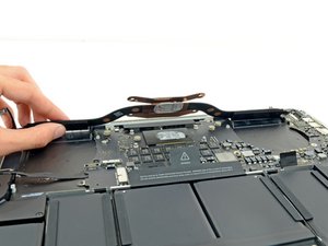

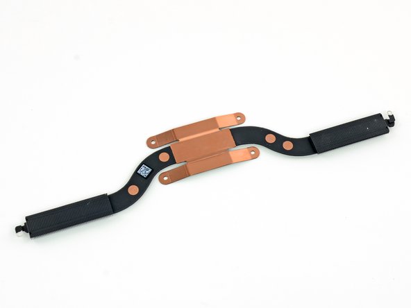

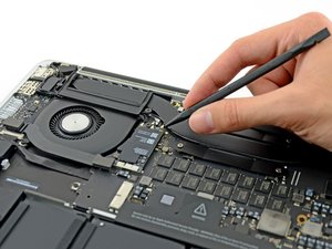

  • One of the few differences: The 15" MBP now has a sleekified heat sink with just a single thermal pad, thanks to the more closely integrated GPU—which we attribute to the "Haswellification" process, as we call it.
  • Another effect of Haswelling your MacBook: This model claims to deliver an extra hour of battery life with the same capacity cells. The more efficient processor likely contributes much to that extra hour of looking at pictures of cats on the internet.

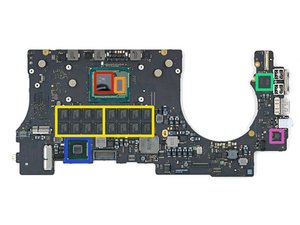

  • The most noteworthy revisions come on the logic board, including the all-new Haswell Core i7 processor, Iris Pro Graphics, and Thunderbolt 2 support:
    • 2.0 GHz quad-core Intel Core i7 processor (Turbo Boost up to 3.2 GHz) with 6 MB shared L3 cache and Iris Pro graphics
    • 128MB eDRAM cache
    • Elpida J4208EFBG 512 MB DDR3 SDRAM (16 chips for 8 GB total)
    • Intel DSL5520 Thunderbolt 2 Controller
    • Intel Platform Controller Hub
    • Cirrus 4208-CRZ Audio Codec, similar to Cirrus CS4207
Image #1
Edit Step 6  ¶
  • Back of the logic board:
    • SK Hynix H5TC4G63AFR 512 MB DDR3 SDRAM
    • Broadcom BCM15700A2
    • Cypress Semiconductor CY8C24794-24LTXI Programmable System-on-Chip
    • Texas Instruments TPS51980
    • The headphone jack is now soldered onto the logic board—break yours (easily doable through normal wear and tear) and you're looking at a thousand dollar repair

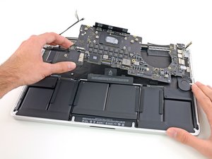

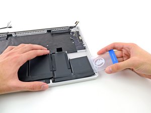

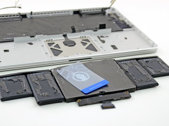

  • The moment of truth is now upon us—is the battery any easier to take out than the previous, horribly glued-in disaster?
  • We're holding our breath as we gently test the waters with a plastic card...
  • ...And half an hour and several skinned knuckles later, we exhale that breath in a great sigh of disappointment. The battery has the same excessive adhesive, and is just as nearly-impossible to safely remove as before.
  • So much for evolution of design.

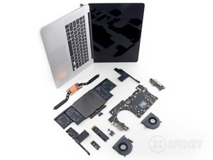

  • MacBook Pro with Retina Display 15" Late 2013 Repairability Score: 1 out of 10 (10 is easiest to repair).
  • Proprietary pentalobe screws prevent you from gaining access to anything inside.
  • As in the MacBook Air, the RAM is soldered to the logic board. Max out at 16GB now, or forever hold your peace—you can't upgrade.
  • The proprietary SSD has changed to a PCIe format, but still isn't a standard 2.5" drive. However, it is a separate daughtercard, and we’re hopeful we can offer an upgrade in the near future.
  • The lithium-polymer battery is glued rather than screwed into the case, which increases the chances that it'll break during disassembly. The battery also covers the trackpad cable, which tremendously increases the chance that the user will shear the cable in the battery removal process.
  • The display assembly is completely fused, and there’s no glass protecting it. If anything ever fails inside the display, you will need to replace the entire, extremely expensive assembly.

The chip marked by Orange is the Crystalwell eDRAM, 128MB in total. This can be used by both the CPU cores and The Iris Pro GPU that is still integrated in to the main core chip (the one marked by red).
Magnus Rydningen, · Reply

Yeah, "2.0 GHz quad-core Intel Core i7 processor (Turbo Boost up to 3.2 GHz) with 6 MB shared L3 cache
Intel Iris Pro Graphics" is wrong, the larger die is actually the eDRAM for both processor and GPU, the smaller die is both the processor and the GPU.
tipoo, · Reply
Just edited it, then saw this comment. Been bugging me since this teardown was made. Unsure why they keep on disallowing the edits.

The bigger one in CPU is GPU+CPU, smaller one is eDRAM Crystalwell cache, not other way around.

That's probably the most important thing about that battery. An uncased battery such as what Apple uses can be very dangerous if damaged. The average consumer doesn't know exactly how delicate those are, so Apple tries to limit access with pentalobes. Also the adhesive is there to help the battery from moving around in the casing, further reducing the possibility of damage. Sure it's hard to repair, but it's much safer.
Bryan Elliott,
