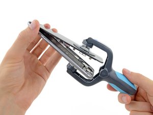

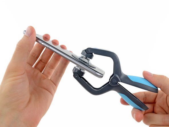

      • The next two steps demonstrate the Anti-Clamp, a tool we designed to make the opening procedure easier. If you aren't using the Anti-Clamp, skip down three steps for an alternate method.
      • For complete instructions on how to use the Anti-Clamp, check out this guide.

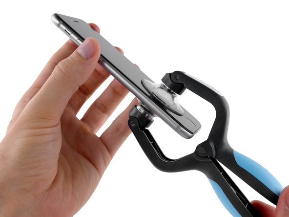

      • Pull the blue handle backwards to unlock the Anti-Clamp's arms.
      • Slide the arms over either the left or right edge of your iPhone.
      • Position the suction cups near the bottom edge of the iPhone just above the home button—one on the front, and one on the back.
      • Squeeze the cups together to apply suction to the desired area.
      • If you find that the surface of your iPhone is too slippery for the Anti-Clamp to hold onto, you can use tape to create a grippier surface.
      Ask FixBot
    2. iPhone 6 Logic Board Replacement: step 3, image 1 of 3 iPhone 6 Logic Board Replacement: step 3, image 2 of 3 iPhone 6 Logic Board Replacement: step 3, image 3 of 3
      • Pull the blue handle forwards to lock the arms.
      • Turn the handle clockwise 360 degrees or until the cups start to stretch.
      • Make sure the suction cups remain aligned with each other. If they begin to slip out of alignment, loosen the suction cups slightly and realign the arms.
      • Insert an opening pick under the screen when the Anti-Clamp creates a large enough gap.
      • If the Anti-Clamp doesn't create a sufficient gap, rotate the handle a quarter turn.
      • Don't crank more than a quarter turn at a time, and wait a few seconds between turns. Let the Anti-Clamp and time do the work for you.

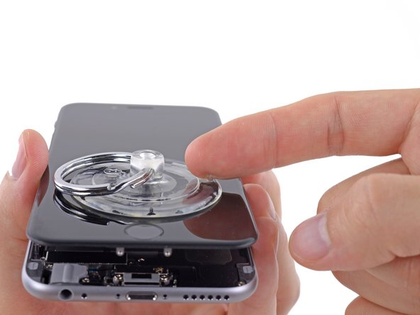

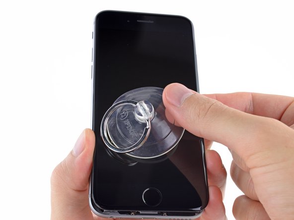

      • If you don't have an Anti-Clamp, use a single suction cup to lift the front panel:
      • Press a suction cup onto the screen, just above the home button.
      • Be sure the cup is pressed securely onto the screen to get a tight seal.
      • If your display is badly cracked, covering it with a layer of clear packing tape may allow the suction cup to adhere. Alternatively, very strong tape may be used instead of the suction cup. If all else fails, you can superglue the suction cup to the broken screen.
      Ask FixBot
    2. iPhone 6 Logic Board Replacement: step 5, image 1 of 1
      • While holding the iPhone down with one hand, pull up on the suction cup to slightly separate the front panel assembly from the rear case.
      • Take your time and apply firm, constant force. The display assembly is a much tighter fit than most devices.

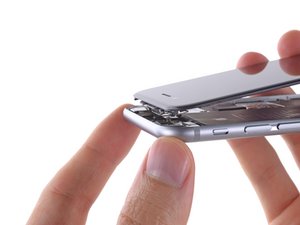

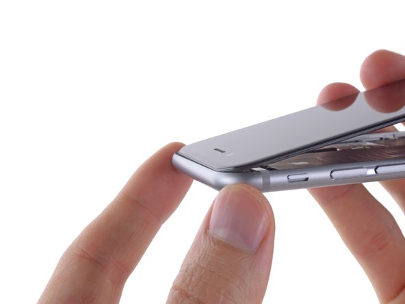

    4. iPhone 6 Logic Board Replacement, Opening up the phone: step 7, image 1 of 3 iPhone 6 Logic Board Replacement, Opening up the phone: step 7, image 2 of 3 iPhone 6 Logic Board Replacement, Opening up the phone: step 7, image 3 of 3
      • Open the iPhone by swinging the home button end of the front panel assembly away from the rear case, using the top of the phone as a hinge.
      • Several clips along the top edge of the front panel form a partial hinge.
      • During reassembly, align the clips just below the top edge of the rear case. Then, slide the front panel upward until its top edge is flush with that of the rear case.

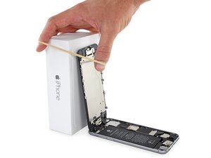

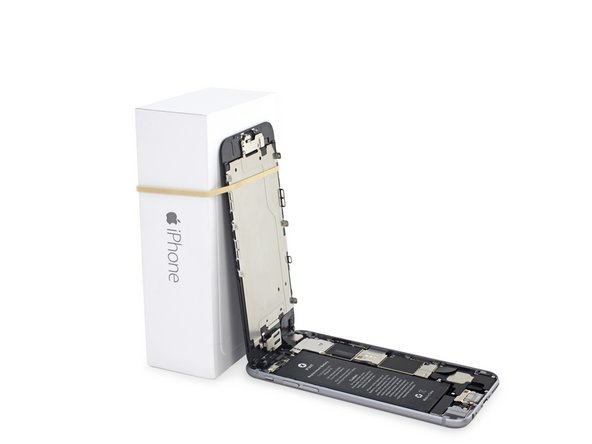

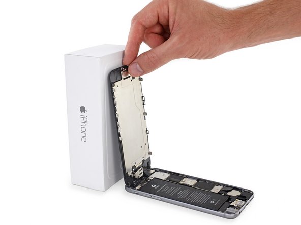

    5. iPhone 6 Logic Board Replacement: step 8, image 1 of 3 iPhone 6 Logic Board Replacement: step 8, image 2 of 3 iPhone 6 Logic Board Replacement: step 8, image 3 of 3
      • Open the display to about a 90º angle, and lean it against something to keep it propped up while you're working on the phone.
      • In a pinch, an unopened canned beverage works well for this.
      • Add a rubber band to keep the display securely in place while you work. This prevents undue strain on the display cables.

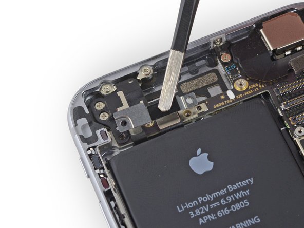

    6. iPhone 6 Logic Board Replacement, Removing the battery connector bracket screws: step 9, image 1 of 1
      Tool used on this step:
      Magnetic Project Mat
      $19.95
      Buy
      • Remove the following Phillips screws from the battery connector bracket:
      • One 2.2 mm screw
      • One 3.2 mm screw
      • During your repair, keep track of each screw and make sure it goes back exactly where it came from to avoid damaging your phone.
      Ask FixBot
    7. iPhone 6 Logic Board Replacement: step 10, image 1 of 1
      • Remove the metal battery connector bracket from the iPhone.
      Ask FixBot

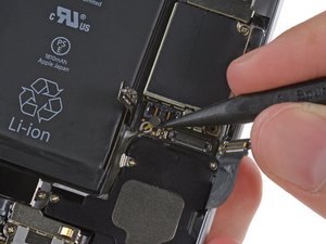

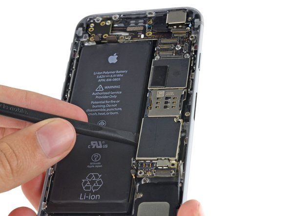

    8. iPhone 6 Logic Board Replacement, Disconnecting the battery connector: step 11, image 1 of 1
      • Use a plastic opening tool to gently pry the battery connector up from its socket on the logic board.
      • Take care to only pry up on the battery connector, and not the socket on the logic board. If you pry up on the logic board socket, you may break the connector entirely.

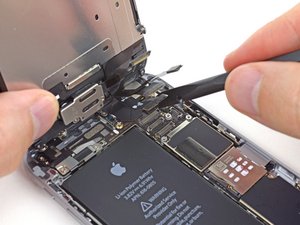

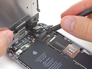

    11. iPhone 6 Logic Board Replacement: step 14, image 1 of 2 iPhone 6 Logic Board Replacement: step 14, image 2 of 2
      • In the next four steps, take care to pry up only on the cable connectors, and not on their sockets on the logic board.
      • Use a spudger or a fingernail to disconnect the front-facing camera and sensor cable connector.
      Ask FixBot
    12. iPhone 6 Logic Board Replacement: step 15, image 1 of 2 iPhone 6 Logic Board Replacement: step 15, image 2 of 2
      • Use a spudger or a fingernail to disconnect the home button cable connector.
      Ask FixBot

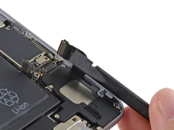

    14. iPhone 6 Logic Board Replacement: step 17, image 1 of 2 iPhone 6 Logic Board Replacement: step 17, image 2 of 2
      • Use the flat end of a spudger to disconnect the digitizer cable connector.
      • When reconnecting the digitizer cable, do not press the center of the connector. Press one end of the connector, then press the opposite end. Pressing in the center of the connector can bend the component and cause digitizer damage.

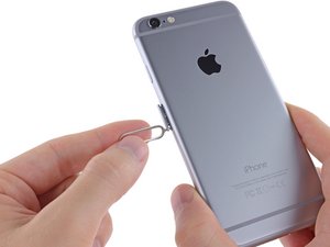

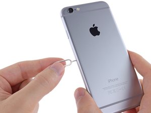

    1. iPhone 6 Logic Board Replacement, SIM Card: step 19, image 1 of 2 iPhone 6 Logic Board Replacement, SIM Card: step 19, image 2 of 2
      • Insert a SIM card eject tool or a paperclip into the small hole in the SIM card tray.
      • Press to eject the tray.
      • This may require a significant amount of force.

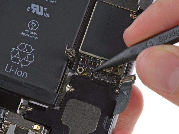

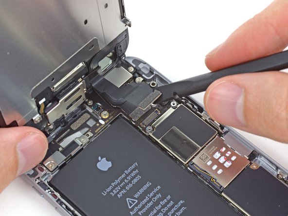

    1. iPhone 6 Logic Board Replacement, Logic Board: step 21, image 1 of 2 iPhone 6 Logic Board Replacement, Logic Board: step 21, image 2 of 2
      • Use the flat end of a spudger to disconnect the Lightning connector assembly cable and fold it out of the way of the speaker.

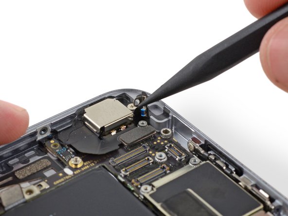

    3. iPhone 6 Logic Board Replacement: step 23, image 1 of 1
      • Remove the following Phillips screws from the upper cable bracket:
      • One 2.9 mm screw
      • One 2.2 mm screw
      Ask FixBot

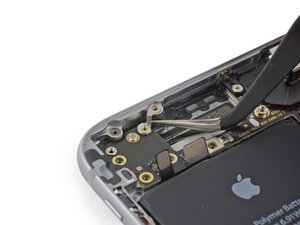

    4. iPhone 6 Logic Board Replacement: step 24, image 1 of 2 iPhone 6 Logic Board Replacement: step 24, image 2 of 2
      • Remove the upper cable bracket from the iPhone.

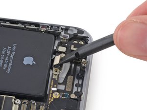

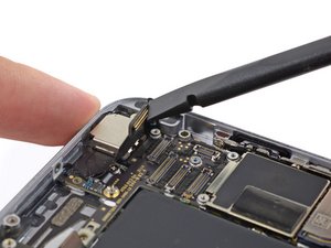

    5. iPhone 6 Logic Board Replacement: step 25, image 1 of 3 iPhone 6 Logic Board Replacement: step 25, image 2 of 3 iPhone 6 Logic Board Replacement: step 25, image 3 of 3
      • When disconnecting the following connectors, only pry up on the connector, not the socket on the logic board or you risk permanent damage.
      • Use the flat end of a spudger to lift the power button and flash assembly cable connector up off of its socket.
      • Lift the volume control cable connector up out of its socket on the logic board.

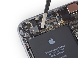

      • Remove the following four Phillips screws from the Wi-Fi antenna:
      • One 1.5 mm screw
      • One 1.4 mm screw
      • Two 2.1 mm screws
      Ask FixBot
    7. iPhone 6 Logic Board Replacement: step 27, image 1 of 2 iPhone 6 Logic Board Replacement: step 27, image 2 of 2
      Buy

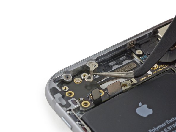

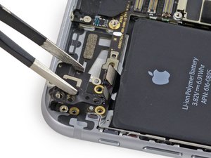

      • Remove the Wi-Fi antenna from the iPhone.
      • Be careful not to touch any metal to metal contact points with your bare fingers—use tweezers or gloves. Finger oils may disrupt conductivity. If you do touch any of these components, clean them with a degreaser like windex or isopropyl alcohol before reassembly.
      Ask FixBot

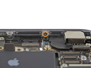

      • Remove the two 1.6 mm Phillips screws from the grounding bracket.
      Ask FixBot
    9. iPhone 6 Logic Board Replacement: step 29, image 1 of 2 iPhone 6 Logic Board Replacement: step 29, image 2 of 2
      • Remove the grounding bracket from the iPhone.

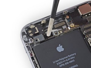

    10. iPhone 6 Logic Board Replacement: step 30, image 1 of 2 iPhone 6 Logic Board Replacement: step 30, image 2 of 2
      • Remove the following Phillips screws securing the angled logic board bracket.
      • One 2.6 mm screw
      • One 1.3 mm screw, located horizontally in the upper sidewall of the iPhone.
      Ask FixBot

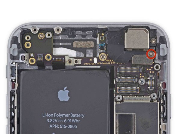

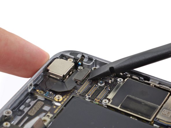

      • Remove the single 1.2 mm Phillips screw securing the antenna interconnect cable to the logic board.
      Ask FixBot
    13. iPhone 6 Logic Board Replacement: step 33, image 1 of 2 iPhone 6 Logic Board Replacement: step 33, image 2 of 2
      • Use the point of a spudger to fold the antenna interconnect cable up out of the way of the logic board.
      Ask FixBot

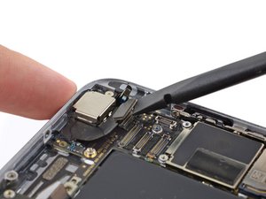

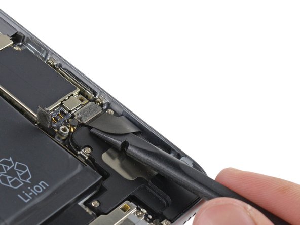

    14. iPhone 6 Logic Board Replacement: step 34, image 1 of 3 iPhone 6 Logic Board Replacement: step 34, image 2 of 3 iPhone 6 Logic Board Replacement: step 34, image 3 of 3
      • Use the flat end of a spudger to lift the camera cable connector straight up out of its socket on the logic board.
      • Be sure to only pry on the connector not the socket itself or you can cause permanent damage to the logic board.
      • Fold the camera cable up out of the way of the logic board.

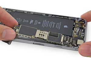

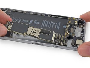

    17. iPhone 6 Logic Board Replacement: step 37, image 1 of 3 iPhone 6 Logic Board Replacement: step 37, image 2 of 3 iPhone 6 Logic Board Replacement: step 37, image 3 of 3
      • Lift the battery connector end of the logic board and pull it up and out of the rear case.
      • Be careful not to snag the logic board on any cables.
