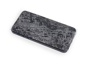

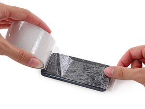

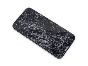

    1. iPhone 5 Front-Facing Camera and Sensor Cable Replacement, Taping the display glass: step 1, image 1 of 3 iPhone 5 Front-Facing Camera and Sensor Cable Replacement, Taping the display glass: step 1, image 2 of 3 iPhone 5 Front-Facing Camera and Sensor Cable Replacement, Taping the display glass: step 1, image 3 of 3
      • If your display glass is cracked, keep further breakage contained and prevent bodily harm during your repair by taping the glass.
      • Lay overlapping strips of clear packing tape over the iPhone's display until the whole face is covered.
      • Wear safety glasses to protect your eyes from any glass shaken free during the repair.

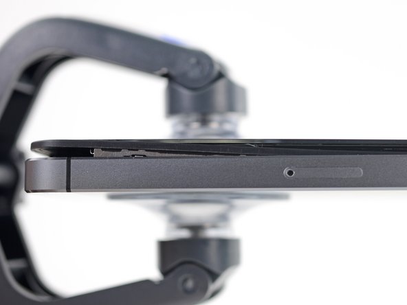

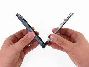

    3. iPhone 5 Front-Facing Camera and Sensor Cable Replacement, How to prevent display separation: step 3, image 1 of 3 iPhone 5 Front-Facing Camera and Sensor Cable Replacement, How to prevent display separation: step 3, image 2 of 3 iPhone 5 Front-Facing Camera and Sensor Cable Replacement, How to prevent display separation: step 3, image 3 of 3
      • In the following steps you will be pulling the display up out of the phone body. The display is composed of a glass screen and a plastic bezel with metal clips.
      • Regardless of the tool you use, you need to be sure you pull up the entire display.
      • If the glass begins to separate from the plastic, as shown in the first image, slide a plastic opening tool between the plastic frame and the metal phone body to pry the metal clips out of the case.
      • If you are reassembling a phone with a separated display bezel, you may want to place a thin strip of adhesive between the plastic bezel and the glass to keep the phone closed.

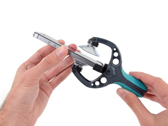

    4. iPhone 5 Front-Facing Camera and Sensor Cable Replacement, Anti-Clamp instructions: step 4, image 1 of 3 iPhone 5 Front-Facing Camera and Sensor Cable Replacement, Anti-Clamp instructions: step 4, image 2 of 3 iPhone 5 Front-Facing Camera and Sensor Cable Replacement, Anti-Clamp instructions: step 4, image 3 of 3
      Tool used on this step:
      Clampy - Anti-Clamp
      $24.95
      Buy

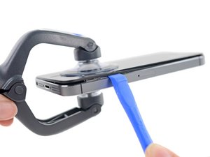

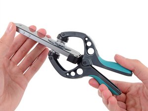

      • The next two steps demonstrate the Anti-Clamp, a tool we designed to make the opening procedure easier. If you aren't using the Anti-Clamp, skip down two steps for an alternate method.
      • For complete instructions on how to use the Anti-Clamp, check out this guide.
      • Pull the blue handle backwards to unlock the Anti-Clamp's arms.
      • Slide the arms over either the left or right edge of your iPhone.
      • Position the suction cups near the bottom edge of the iPhone just above the home button—one on the front, and one on the back.
      • Squeeze the cups together to apply suction to the desired area.
      • If you find that the surface of your iPhone is too slippery for the Anti-Clamp to hold onto, you can use tape to create a grippier surface.

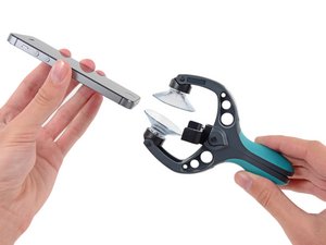

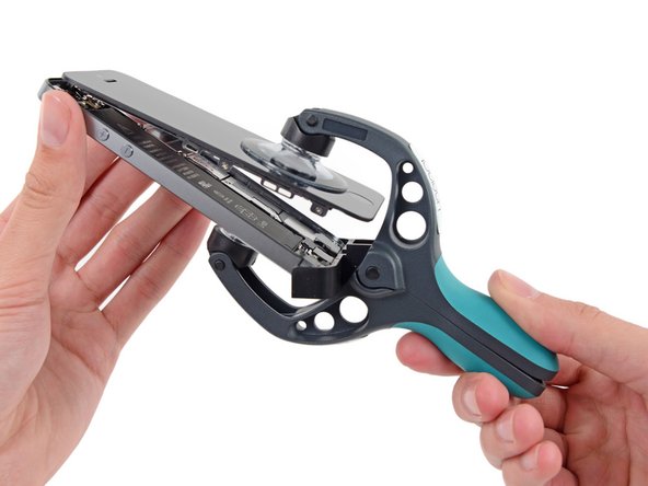

    5. iPhone 5 Front-Facing Camera and Sensor Cable Replacement: step 5, image 1 of 3 iPhone 5 Front-Facing Camera and Sensor Cable Replacement: step 5, image 2 of 3 iPhone 5 Front-Facing Camera and Sensor Cable Replacement: step 5, image 3 of 3
      • Pull the blue handle forwards to lock the arms.
      • Turn the handle clockwise 360 degrees or until the cups start to stretch.
      • Make sure the suction cups remain aligned with each other. If they begin to slip out of alignment, loosen the suction cups slightly and realign the arms.
      • Insert an opening pick under the screen when the Anti-Clamp creates a large enough gap.
      • If the Anti-Clamp doesn't create a sufficient gap, apply more heat to the area and rotate the handle a quarter turn.
      • Don't crank more than a quarter turn at a time, and wait one minute between turns. Let the Anti-Clamp and time do the work for you.

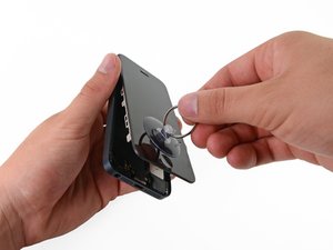

    6. iPhone 5 Front-Facing Camera and Sensor Cable Replacement, Manual Opening Procedure: step 6, image 1 of 1
      • Press a suction cup onto the screen, just above the home button.
      • Be sure the cup is completely on the screen to get a tight seal.
      • If you're opening an iPhone with cracked glass, neatly lay a couple strips of packing tape across the front and squeeze out as many bubbles as you can. This will give the suction cup a surface to grab, and minimize the spread of broken glass.

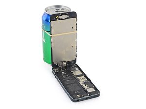

    9. iPhone 5 Front-Facing Camera and Sensor Cable Replacement, Opening up the phone: step 9, image 1 of 3 iPhone 5 Front-Facing Camera and Sensor Cable Replacement, Opening up the phone: step 9, image 2 of 3 iPhone 5 Front-Facing Camera and Sensor Cable Replacement, Opening up the phone: step 9, image 3 of 3
      • Do not try to completely remove the front panel assembly from the rear case, as there are several ribbon cables still attached at the top of the iPhone.
      • Once the clips have been released on the bottom and sides of the front panel assembly, pull the bottom of the assembly away from the rear case.
      • Open the display to about a 90º angle, and lean it against something to keep it propped up while you're working on the phone.
      • Add a rubber band to keep the display securely in place while you work. This prevents undue strain on the display cables.

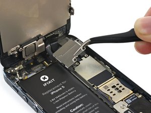

    10. iPhone 5 Front-Facing Camera and Sensor Cable Replacement, Removing the battery connector bracket screws: step 10, image 1 of 1
      • Remove the following two screws securing the metal battery connector bracket to the logic board:
      • One 1.8 mm Phillips screw
      • One 1.6 mm Phillips screw

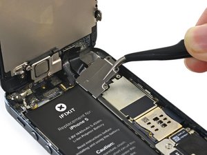

    13. iPhone 5 Front-Facing Camera and Sensor Cable Replacement, Removing the front panel assembly cable bracket screws: step 13, image 1 of 1
      • Remove the following screws securing the front panel assembly cable bracket to the logic board:
      • Two 1.2 mm Phillips screws
      • This screw tends to not be attracted to a magnetized screwdriver. Take care not to lose it when removing, and make sure it gets back into the right place—a magnetized screw may interfere with the compass.
      Ask FixBot
    14. iPhone 5 Front-Facing Camera and Sensor Cable Replacement, Removing the front panel assembly cable bracket: step 14, image 1 of 2 iPhone 5 Front-Facing Camera and Sensor Cable Replacement, Removing the front panel assembly cable bracket: step 14, image 2 of 2
      • Lift the display cable bracket toward the battery to unhook it, and remove it from the iPhone.
      • During reassembly, clip the left-hand hooks under the logic board and lower the bracket towards the outside of the phone.

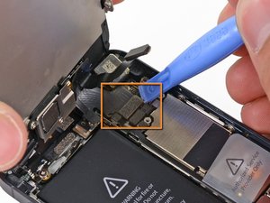

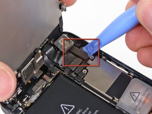

    15. iPhone 5 Front-Facing Camera and Sensor Cable Replacement, Disconnecting the front panel assembly cables: step 15, image 1 of 3 iPhone 5 Front-Facing Camera and Sensor Cable Replacement, Disconnecting the front panel assembly cables: step 15, image 2 of 3 iPhone 5 Front-Facing Camera and Sensor Cable Replacement, Disconnecting the front panel assembly cables: step 15, image 3 of 3
      • Make sure the battery is disconnected before you disconnect or reconnect the cables in this step.
      • Use a plastic opening tool or a fingernail to disconnect the three front panel assembly cables:
      • Front-facing camera and sensor cable
      • LCD cable
      • Digitizer cable
      • When reassembling your phone, the LCD cable may pop off the connector. This can cause white lines, or nothing at all to appear when powering your phone back on. If that happens, simply reconnect the cable and power cycle your phone. The best way to power cycle your phone is to disconnect and reconnect the battery.

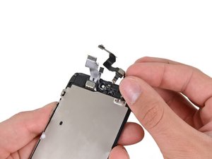

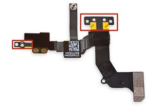

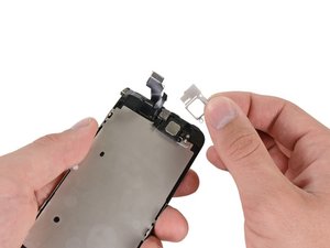

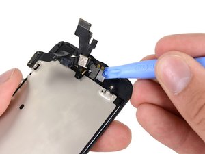

    1. iPhone 5 Front-Facing Camera and Sensor Cable Replacement, Front-Facing Camera and Sensor Cable: step 21, image 1 of 2 iPhone 5 Front-Facing Camera and Sensor Cable Replacement, Front-Facing Camera and Sensor Cable: step 21, image 2 of 2
      • Starting under the earpiece speaker contacts, use a plastic opening tool or the tip of a spudger to pry the front facing camera cable out of the display assembly.
      • Caution: Removing the earpiece speaker contacts can cause them to tear. Use extreme caution when peeling the contacts up.
      Ask FixBot

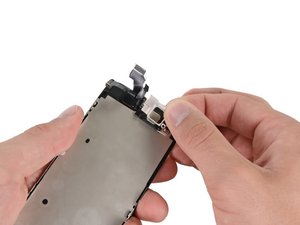

    2. iPhone 5 Front-Facing Camera and Sensor Cable Replacement: step 22, image 1 of 2 iPhone 5 Front-Facing Camera and Sensor Cable Replacement: step 22, image 2 of 2
      • Remove the front-facing camera and rear microphone assembly.
      • If you are installing a new part, your new part may have two tabs with holes in it used for manufacturing purposes. These tabs can be cut off with scissors.
      • There is a small, square plastic and metal holder for the proximity sensor. This holder is essential for the proximity sensor to function correctly.
      • If replacing the proximity sensor or camera make sure that the holder remains adhered to the back of the display. If it comes off with the old proximity sensor, remove it from the old sensor and use a tiny bit of adhesive to re-attach it to the back of the display.
