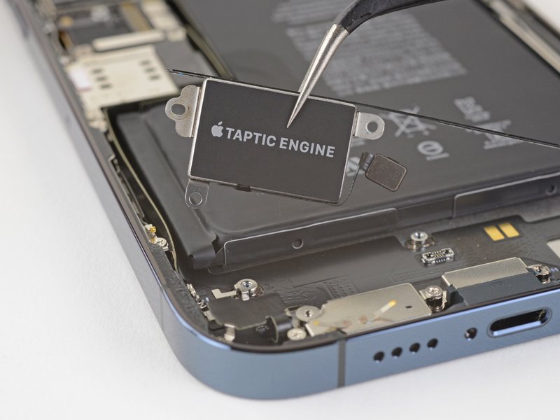

    1. iPhone 12 Pro Max Taptic Engine Replacement, Unscrew the loudspeaker: step 27, image 1 of 1
      • Use a Phillips driver to remove the four 1.4 mm screws securing the loudspeaker.
      Ask FixBot
    2. iPhone 12 Pro Max Taptic Engine Replacement, Remove the loudspeaker: step 28, image 1 of 3 iPhone 12 Pro Max Taptic Engine Replacement, Remove the loudspeaker: step 28, image 2 of 3 iPhone 12 Pro Max Taptic Engine Replacement, Remove the loudspeaker: step 28, image 3 of 3
      • Slowly lift the loudspeaker out of its recess while gently peeling it off of its adhesive strip. Reapply this strip to the new loudspeaker.
      • Remove the loudspeaker.
      Ask FixBot
    1. iPhone 12 Pro Max Taptic Engine Replacement, Remove the Taptic Engine plastic cover: step 29, image 1 of 1
      • Use a Phillips driver to remove the 1.4 mm screw securing the Taptic Engine plastic cover.
      Ask FixBot
    2. iPhone 12 Pro Max Taptic Engine Replacement: step 30, image 1 of 1
      • Remove the plastic cover
      Ask FixBot
    3. iPhone 12 Pro Max Taptic Engine Replacement, Remove the Taptic Engine: step 31, image 1 of 2 iPhone 12 Pro Max Taptic Engine Replacement, Remove the Taptic Engine: step 31, image 2 of 2
      • Use the point of a spudger to pry the Taptic Engine connector straight up and out of its socket.

      • Remove the three screws securing the Taptic Engine:
      • Two 2.8 mm standoff screws
      • Standoff screws are best removed using a standoff screwdriver or bit.
      • In a pinch, a small flathead screwdriver will do the job—but use extra caution to ensure it doesn't slip and damage surrounding components.
      • One 1.6 mm Phillips screw
      Ask FixBot
    5. iPhone 12 Pro Max Taptic Engine Replacement, Remove the Taptic Engine: step 33, image 1 of 3 iPhone 12 Pro Max Taptic Engine Replacement, Remove the Taptic Engine: step 33, image 2 of 3 iPhone 12 Pro Max Taptic Engine Replacement, Remove the Taptic Engine: step 33, image 3 of 3
      • Remove the Taptic Engine.
      • If you are replacing the Taptic Engine, remove the adhesive strip and transfer it to the new Taptic Engine before beginning reassembly.
