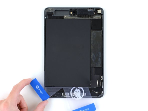

Apply a few drops of high-concentration (90% or higher) isopropyl alcohol around the perimeter of the battery.
Wait two minutes for the isopropyl alcohol to weaken the adhesive underneath the battery.
Insert the corner of a plastic card between the lower end of the battery and the frame.
Press the card until approximately an inch and a half of it is underneath the battery.
Insert a second plastic card between the battery and first card, this time with the card edge parallel to the battery.
Press the card in until about an inch and a half of it is underneath the battery.
Rotate the second plastic card around the bottom left corner under the battery.
Slide the second plastic card up the left edge of the battery toward the top left corner.
Lift and remove the battery.
