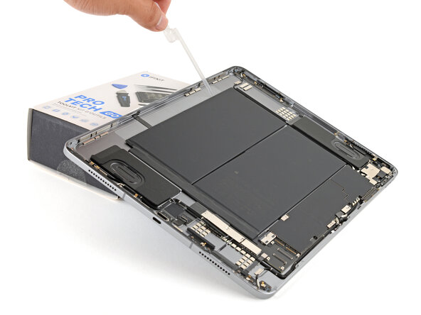

    4. iPad Air 7 13" Battery Replacement, Remove the stretch-release adhesive remnants: step 29, image 1 of 1
      • Elevate the left edge of the iPad by setting it on a stable object.
      Ask FixBot
    5. iPad Air 7 13" Battery Replacement: step 30, image 1 of 3 iPad Air 7 13" Battery Replacement: step 30, image 2 of 3 iPad Air 7 13" Battery Replacement: step 30, image 3 of 3

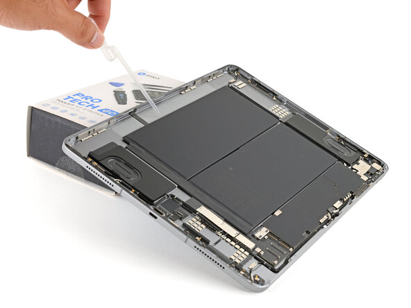

      • Apply several drops of high concentration (>90%) isopropyl alcohol to the left edge of the battery, near the broken adhesive strips.
      • Apply several drops of isopropyl alcohol to the center seam of the battery, near the broken adhesive strips.
      • Wait one minute for the alcohol to soften the adhesive.

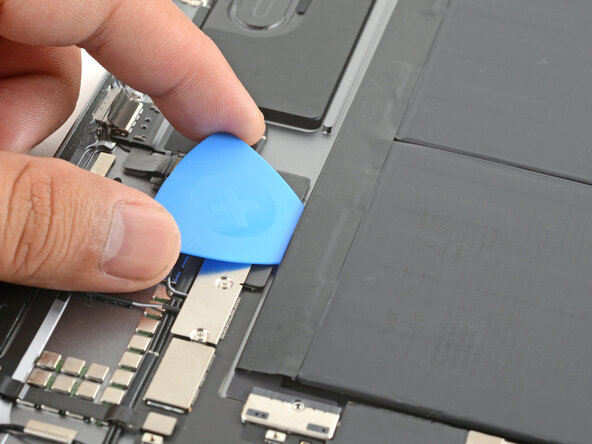

      • Slide a plastic card under the battery to separate the adhesive remnants.
      • Don't puncture or bend the battery. If it feels stuck, apply more isopropyl alcohol to help soften the adhesive.
      • Slide an opening pick under the battery board to separate the adhesive remnants.

    7. iPad Air 7 13" Battery Replacement, Remove the battery: step 32, image 1 of 3 iPad Air 7 13" Battery Replacement, Remove the battery: step 32, image 2 of 3 iPad Air 7 13" Battery Replacement, Remove the battery: step 32, image 3 of 3
      • Grab and pull the battery away from the logic board until the battery connector slides out from under the logic board.
      • If the battery connector feels stuck, apply a few drops of isopropyl alcohol under the connector and try again.
      • Remove the battery.
