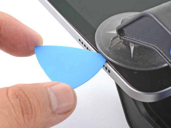

    1. iPad Air 6 11" Screen Replacement, Anti-Clamp instructions: step 3, image 1 of 3 iPad Air 6 11" Screen Replacement, Anti-Clamp instructions: step 3, image 2 of 3 iPad Air 6 11" Screen Replacement, Anti-Clamp instructions: step 3, image 3 of 3
      Tool used on this step:
      Clampy - Anti-Clamp
      $24.95
      Buy
      • The next three steps demonstrate the Anti-Clamp, a tool we designed to make the opening procedure easier. If you aren't using the Anti-Clamp, skip down three steps for an alternate method.
      • For complete instructions on how to use the Anti-Clamp, check out this guide.
      • Pull the blue handle backwards to unlock the Anti-Clamp's arms.
      • Position the suction cups near the top-left corner of the iPad—one on the top and one on the bottom. Make sure the arms don't block the speaker grille.
      • Place an object under your iPad so it rests level between the suction cups.
      • Hold the bottom of the Anti-Clamp steady and firmly press down on the top cup to apply suction.

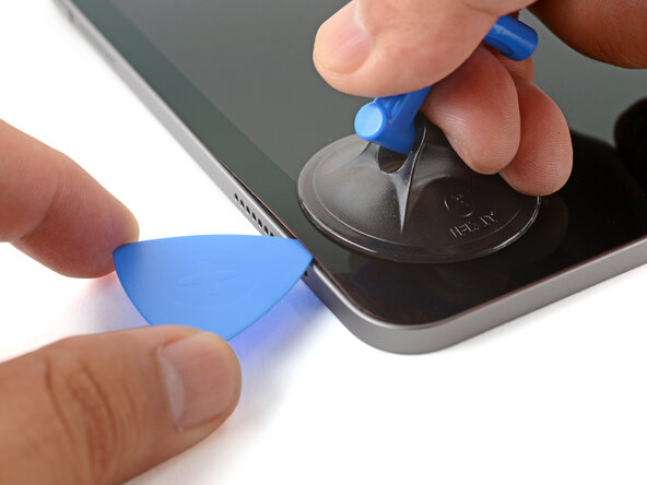

    4. iPad Air 6 11" Screen Replacement, Suction handle instructions: step 6, image 1 of 3 iPad Air 6 11" Screen Replacement, Suction handle instructions: step 6, image 2 of 3 iPad Air 6 11" Screen Replacement, Suction handle instructions: step 6, image 3 of 3
      • The next two steps show how to use a suction handle to create an initial gap.
      • Use a hair dryer or heat gun to heat the top-left corner of the screen until it's slightly too hot to touch.
      • For complete instructions on how to heat with a hair dryer, check out this guide.
      • Improper use of a heat gun can destroy the screen and/or battery—review this guide for instructions. To prevent screen damage, keep your heat source moving rather than focused on one spot.
      • Apply a suction handle to the top-left edge of the screen (near the speaker grille).
      Ask FixBot
    5. iPad Air 6 11" Screen Replacement: step 7, image 1 of 3 iPad Air 6 11" Screen Replacement: step 7, image 2 of 3 iPad Air 6 11" Screen Replacement: step 7, image 3 of 3
      • Pull up on the suction handle with firm, constant pressure to create a gap under the screen.
      • The adhesive holding the screen in place is very strong. If you're having a hard time, be patient, apply more heat, and try again.
      • Insert an opening pick into the gap, no deeper than 6 mm.
      Ask FixBot

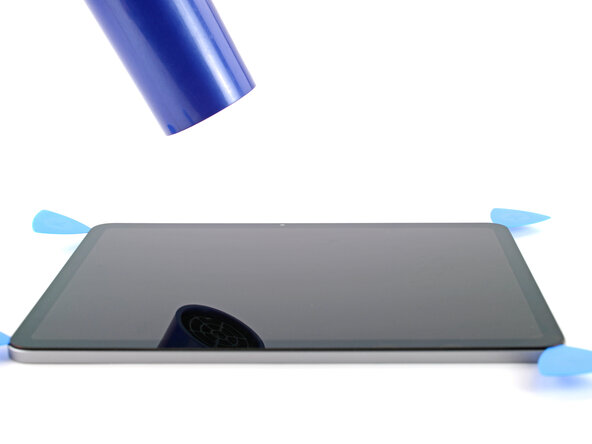

    6. iPad Air 6 11" Screen Replacement, Separate the top edge adhesive: step 8, image 1 of 3 iPad Air 6 11" Screen Replacement, Separate the top edge adhesive: step 8, image 2 of 3 iPad Air 6 11" Screen Replacement, Separate the top edge adhesive: step 8, image 3 of 3
      • Heat the top edge of the iPad until it's slightly too hot to touch.
      • Insert another opening pick under the top-left corner of the screen.
      • Slide the pick along the top edge to separate the adhesive, making sure not to insert it deeper than 6 mm.
      • If you’re having trouble, apply more heat—not more force.
      • Leave the pick inserted in the corner to prevent the adhesive from resealing.
      Ask FixBot

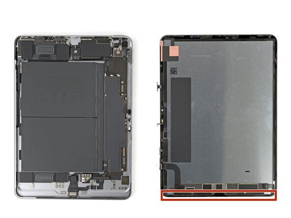

    8. iPad Air 6 11" Screen Replacement, Separate the bottom edge adhesive: step 10, image 1 of 3 iPad Air 6 11" Screen Replacement, Separate the bottom edge adhesive: step 10, image 2 of 3 iPad Air 6 11" Screen Replacement, Separate the bottom edge adhesive: step 10, image 3 of 3
      • Display cables run close to the bottom edge. Don't insert your pick deeper than 2 mm to avoid damaging the cables.
      • Heat the bottom edge until it's slightly too hot to touch.
      • Insert an opening pick under the bottom-left corner of the screen.
      • Slide the pick along the bottom edge to separate the adhesive, making sure not to insert it deeper than 2 mm.

    9. iPad Air 6 11" Screen Replacement, Separate the right edge adhesive: step 11, image 1 of 3 iPad Air 6 11" Screen Replacement, Separate the right edge adhesive: step 11, image 2 of 3 iPad Air 6 11" Screen Replacement, Separate the right edge adhesive: step 11, image 3 of 3
      • Heat the right edge (the edge with the front-facing camera) until it's slightly too hot to touch.
      • Slowly open the iPad by swinging the screen up from the left edge, like the back cover of a book.
      • Don't try to remove the screen yet, as several fragile ribbon cables still connect it to the iPad. Take care not to strain the cables as you work.
      • If the screen feels hard to swing, apply more heat to the right edge.
      • If the screen feels stuck, use your pick to separate any missed sections of adhesive.
      Ask FixBot

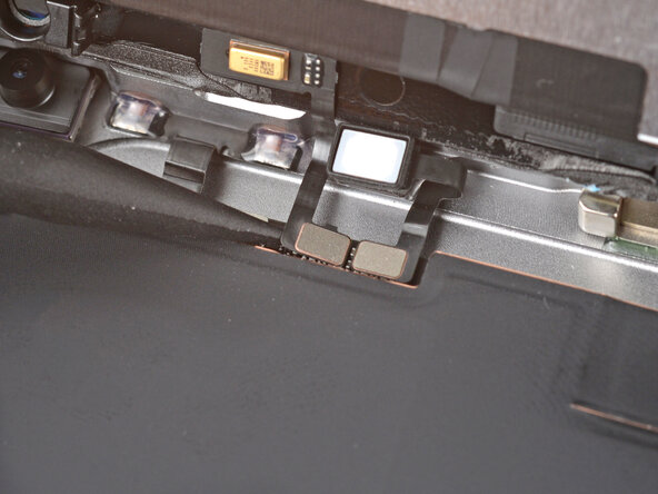

    11. iPad Air 6 11" Screen Replacement, Prop the screen: step 13, image 1 of 1
      • Lean the screen against something to keep it propped up while you're working on the iPad.
      • During reassembly, this is a good point to power on your iPad and test all functions before sealing it up. Be sure to power your iPad back down before you continue working.
      Ask FixBot

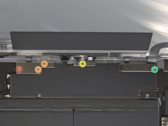

    1. iPad Air 6 11" Screen Replacement, Remove the screen connector cover screws: step 14, image 1 of 2 iPad Air 6 11" Screen Replacement, Remove the screen connector cover screws: step 14, image 2 of 2
      FixMat
      $36.95
      Buy
      • Use a JIS 00 screwdriver to remove the five screws securing the three connector covers:
      • One 2.0 mm‑long screw
      • Two 1.1 mm‑long screws
      • One 1.2 mm‑long screw
      • One 2.1 mm‑long screw
      • Small iFixit Phillips bits are designed to work with JIS screws. You can try Phillips drivers from other manufacturers, but you risk stripping the screw.
      Ask FixBot

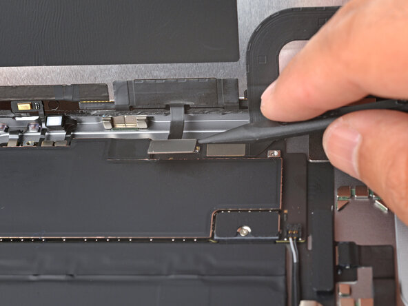

    4. iPad Air 6 11" Screen Replacement, Disconnect the lower screen press connectors: step 17, image 1 of 3 iPad Air 6 11" Screen Replacement, Disconnect the lower screen press connectors: step 17, image 2 of 3 iPad Air 6 11" Screen Replacement, Disconnect the lower screen press connectors: step 17, image 3 of 3
      • Use a spudger or a clean fingernail to pry up and disconnect the two lower screen press connectors.
      Ask FixBot
    5. iPad Air 6 11" Screen Replacement: step 18, image 1 of 2 iPad Air 6 11" Screen Replacement: step 18, image 2 of 2
      • Use a spudger to pry up and disconnect the front microphone press connector.
      • This connector can be tricky to reconnect during reassembly. Use tweezers to position the connector, then press it into place with the point of a spudger.
      Ask FixBot
    6. iPad Air 6 11" Screen Replacement, Disconnect the upper screen press connector: step 19, image 1 of 2 iPad Air 6 11" Screen Replacement, Disconnect the upper screen press connector: step 19, image 2 of 2
      • Use the point of a spudger or a clean fingernail to pry up and disconnect the upper screen press connector.
      Ask FixBot
