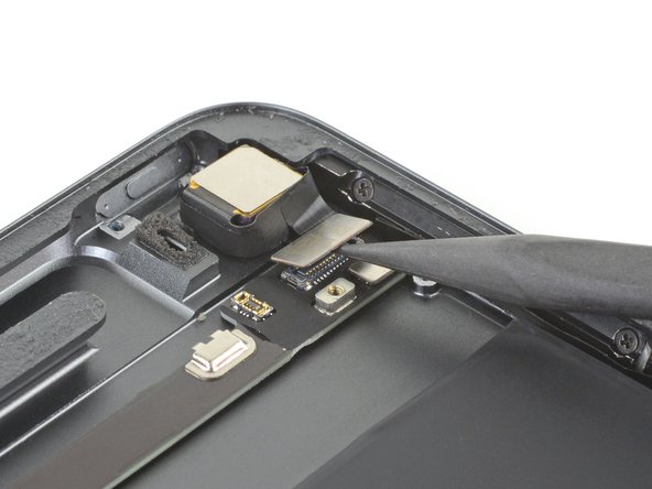

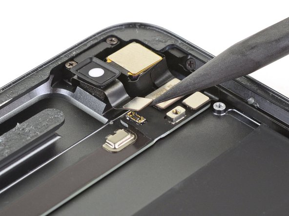

  23. iPad Air 3 Rear Camera Replacement, Disconnect the rear camera: step 23, image 1 of 2 iPad Air 3 Rear Camera Replacement, Disconnect the rear camera: step 23, image 2 of 2
    • Use the pointed end of a spudger to disconnect the rear camera cable by lifting straight up on the press connector.

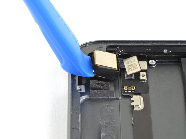

  25. iPad Air 3 Rear Camera Replacement, Pry up the rear camera: step 25, image 1 of 2 iPad Air 3 Rear Camera Replacement, Pry up the rear camera: step 25, image 2 of 2
    • Insert an opening tool between the rear case and the rear camera.
    • Pry the rear camera away from the rear case.
  26. iPad Air 3 Rear Camera Replacement, Remove the rear camera: step 26, image 1 of 1
    • Remove the rear camera.
